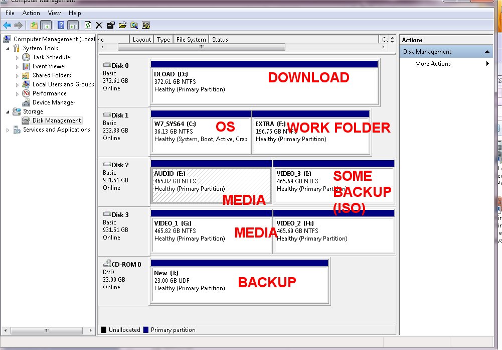

Let's first nail down the backup/mirror stuff and then proceed to how to install Windows.
So:
Why don't you just use 1 HDD [partitioned if you need it to be] as your OS+data disk and the 2nd HDD [partitioned if you need it to be] as your backup disk?
The problem with RAID is that you will get everything [Windows, applications etc] mirrored in realtime with no choice on what you need mirrored. Do you need that overhead? Instead, why don't you use MS Backup or at other backup software to automate backups for you on a schedule. You specify what you want backed up and it will do it for you.
If this [or some other approach] works for you - nail that down and let's then move to how to install Windows [slipstreaming et al].
So:

For starters I would,
1/ Go and grab yourself (save don't run it) a copy of AOMEI backupper that I mentioned earlier. Put it on a flash drive and keep it handy.
2/ Go for it... install W7 as we have discussed. Don't connect to your router when its done because we need to make it more install friendly first.
3/ When you have reached this stage I would plug in the flash drive and install AOMEI.
4/ Do a restart to get the file system in order.
5/ Now make a second partition on the same drive of say 100Gb. This will be used for somewhere to put the backups as you go along.
6/ Before you do anything else, you now run AOMEI and back up what you have so far done.
(If you've never used backup software then at this point I would actually restore the image just made and make sure you are familiar with how it works)

I am trying to follow but I seem to be getting two different and incompatible plans.
Or am I just misunderstanding what you are suggesting and your two suggestions mean the same thing.
Yes , the second plan is what most of the "sheep" do.
The problem with that is when you restore that "expendable" OS.
If all your work is on the single , primary partition ... it is not so
"expendable" , is it ?
The first plan has a 50gig primary than can be wiped out and restored
in 4 minutes by a HDD disk image program (symantec ghost , for example).
The extended partitions will remain untouched.
Worst case , after a full restore ... you might have to re-establish the
default work folders for your 3rd party softwares on the secondary partition(s).
When you have most of your work backed up on optical , your virus
and hardware failures become "non-issues" ... truly.
I feel sorry for the masses who put "all their eggs in one nest".
They deserve to lose their data.
EDIT - (below) an example of the most rational setup for zero loss -
zero stress computing. 7 years a running .... 🙂

The really out of date, gray fur, value is 120GB per partition for compatibility. I do still use this in conditions where I'm not sure.For starters I would,
2/ Go for it... install W7 as we have discussed. Don't connect to your router when its done because we need to make it more install friendly first. [woah! turn off updates at this time and decide later!]
Today, the value of that remembrance is less. Except if you had the system on the first 120GB, which would be the fastest portion of the hard drive, then in that case, Windows couldn't possibly have the opportunity to write on a slow portion of the hard drive. The remainder can be used for data upon an additional partition.
I tested dividing a single-platter 500gb hard drive in half.
The first portion went at 178MB/s and the second portion went at 70MB/s.
Mooly's advice is valid, and probably helpful.
Tested result: The inconvenience of a shortchanged size of "C" drive is far less than daily deframenting to move utilized files to the front of the drive.
Resultant guideline: Don't put your data on drive "C"
