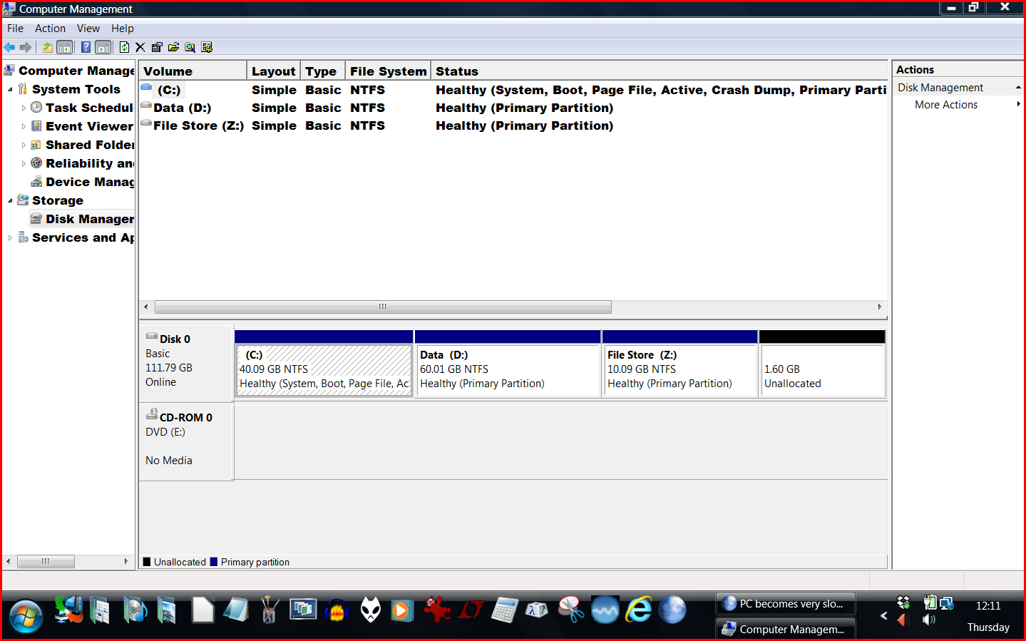

Andrew, if you are going to reinstall Windows then I would advise you make a plan first.
Have a look in your disc management console (right click computer in the start menu and select 'manage). That will show you the present disc and partition structure. You might want a totally fresh start and to set up all new partitions so make a note of the sizes you have now and then decide what might work best for you in actual use. A windows install disc allows you to totally wipe the drive... and that's the way I would do it. When you create a new partition to install Windows on, make it small to begin with, say 15Gb. That puts a limit onto how far any unmovable Windows files can get shoved out onto the disc. At this point create a second partition for running backups made while you rebuild the install. This way you can undo any disasters and get the perfect clean install. When you have got the install to your liking then you can sort the partitions out creating your additional partitions as needed. Its very straightforward to do that.

Yes, partitioning a drive is very useful. The D partition here is where I keep my running backups. File store is just a convenient storage place for anything I might/might not want in future but don't want to commit to the main Windows install.
This is just a small drive on my old Vista laptop.
