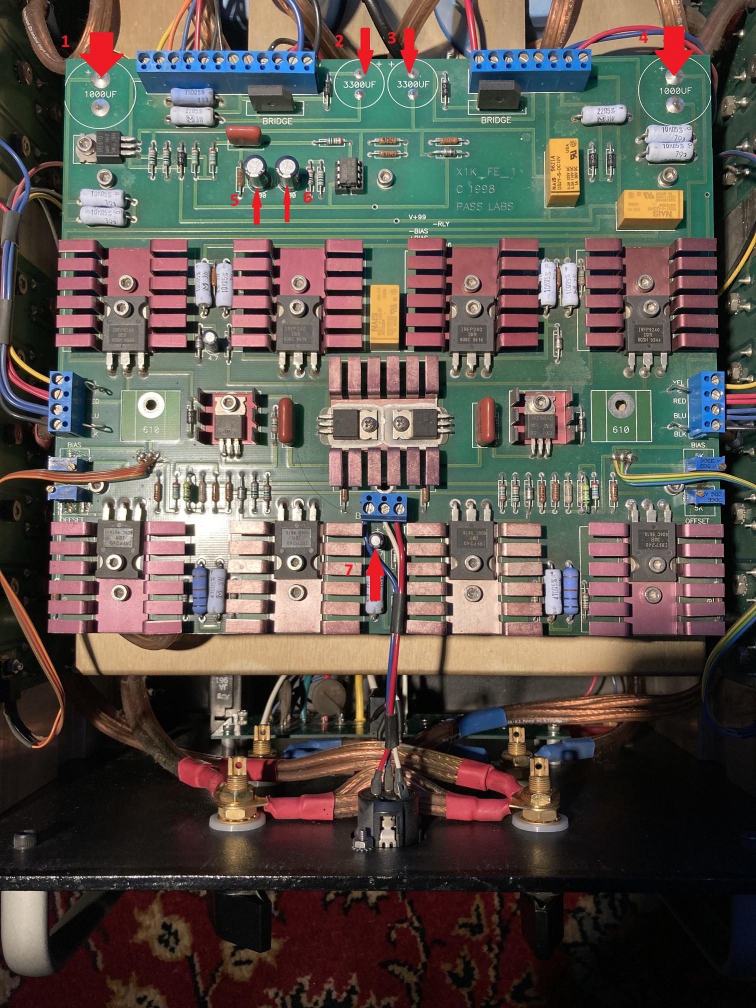

most likely 5 and 6 , on your pictures
have to time right now to look in Books from Yore, but - if you're going to change anything, change them all on FE pcb
Missed one small 4.7uF 35V lytic on the PCB
So as far as I can see there are in total 14 electrolytic capacitors in one X600 chassis.
1 & 4 are 1000uF, 100V snapins
2 & 3 are 3300uF, 35V straight wire
5 & 6 are 100uF 25V straight wire
7 & 8 are 4.7uF 35V straight wire
All these caps are 105 C* degrees
And six 25.000uF, 75V screw terminals.
I sourced every lytic but with a long lead time for the six filtercaps which I do not mind.
Question: apart from 7 & 8 is the capacitance in uF critical as long as the voltage rating is as specified or somewhat above this rating.
I wish to keep the dimensions in diameter and length to be the same for all caps and that means that most of them will have a higher capacitance.

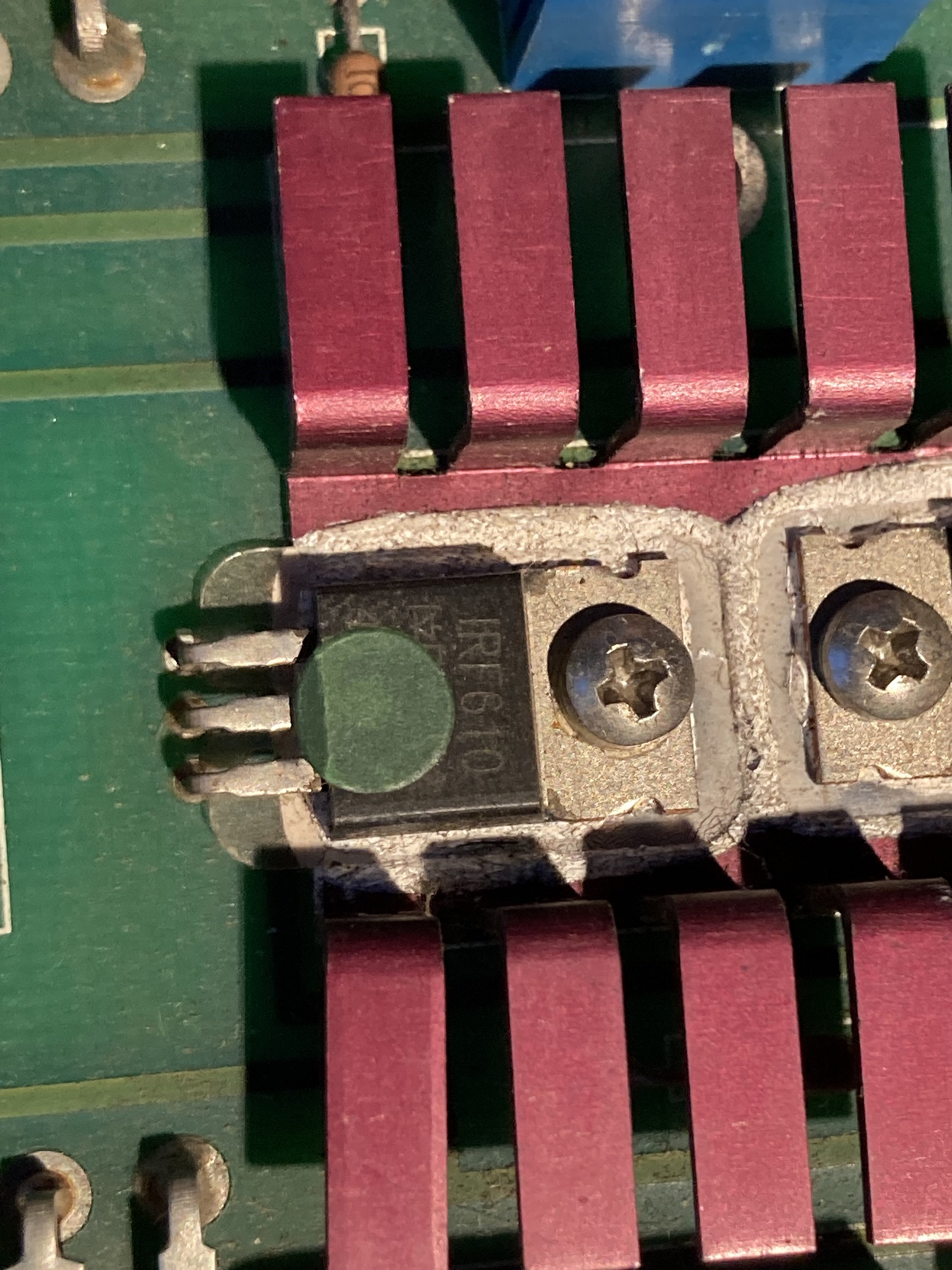

One question I have when it comes to amps like this, where it is pretty much always centered on the caps; does anyone do anything for the transistors? Like possibly gently lifting them, cleaning and apply a type of thermal compound?
If anyone does that, what type of compound would be recommended? I picked up an Adcom GFA-5800 that I will get to someday and was looking to see what people do besides caps.
Thanks, James
Thanks, James
if visual inspection leads to conclusion that thermal interface is critical, then yes
also torque check

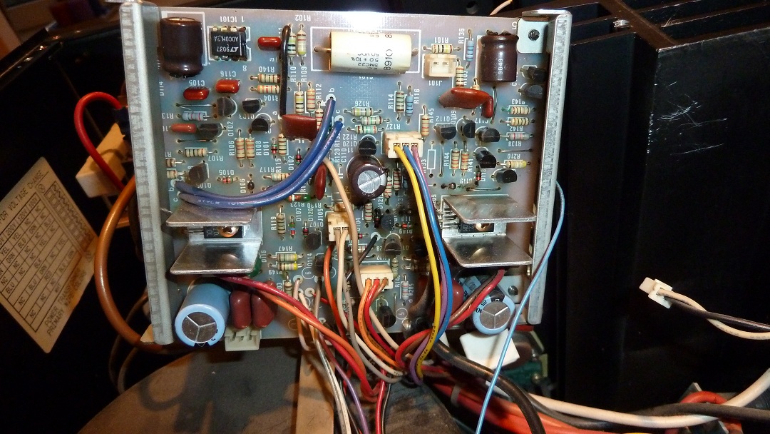

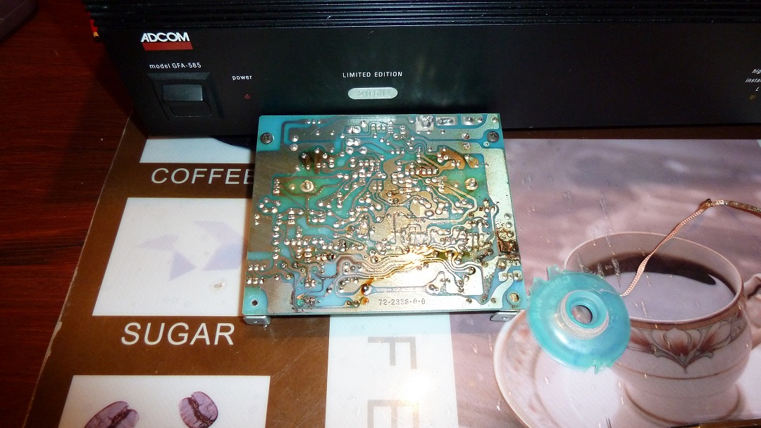

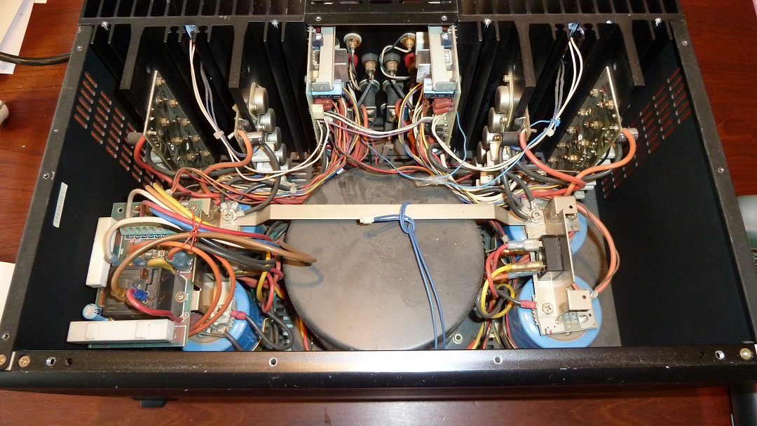

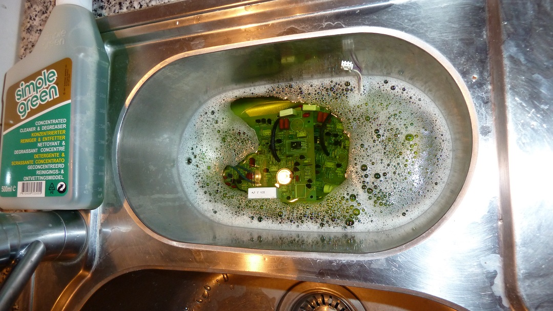

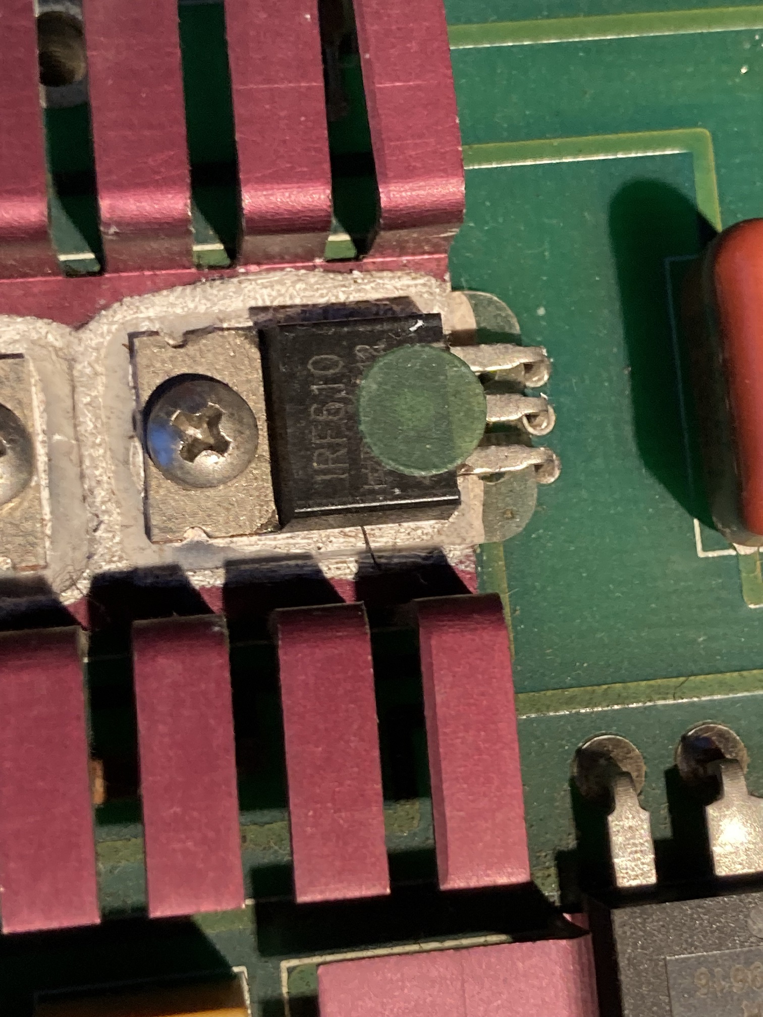

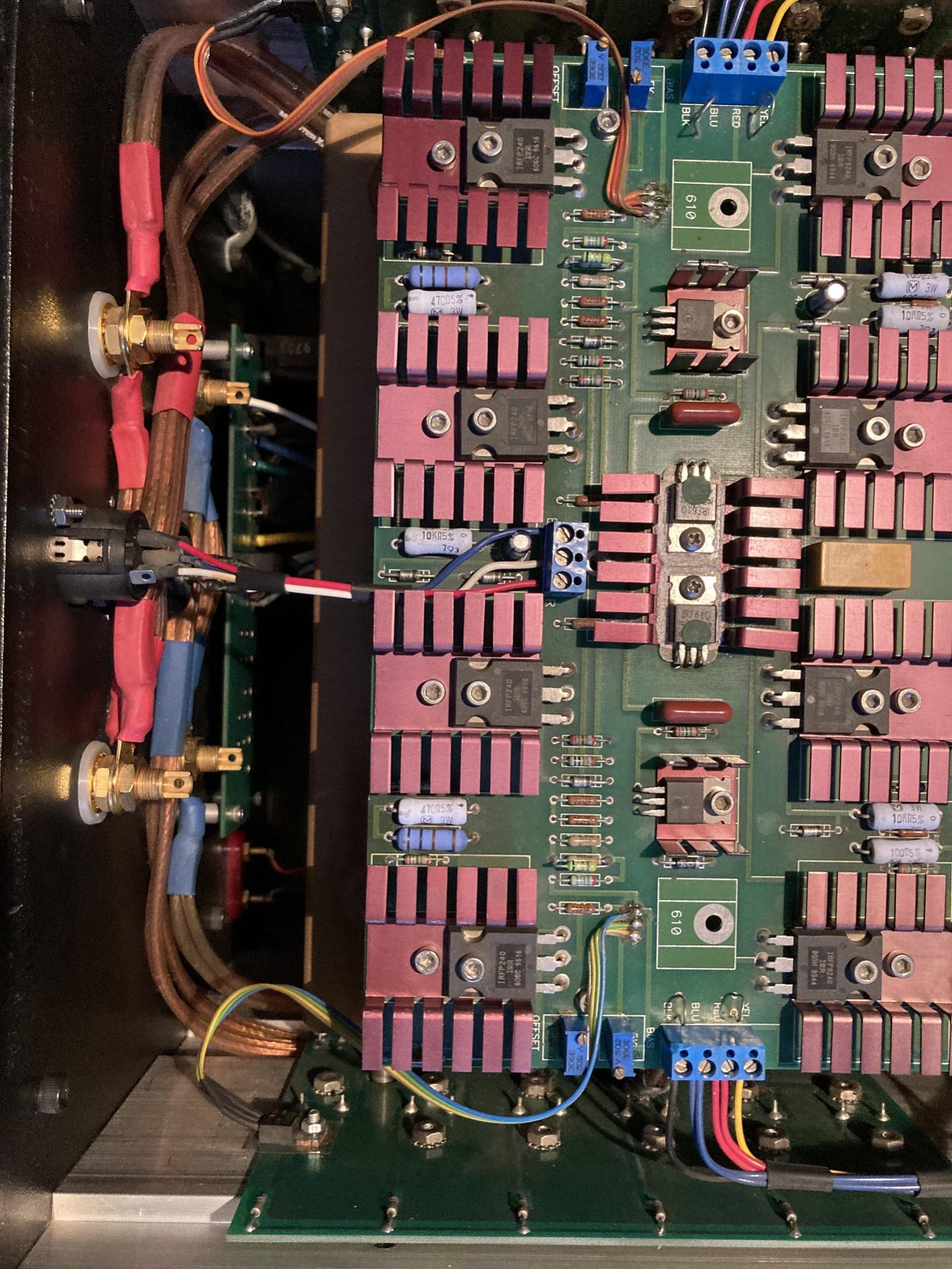

I hope that there aren't any Elna Long Life caps on the frontend boards as there were on mine Adcom GFA-585 because spilled their corrosive liquid as first!
https://www.diyaudio.com/forums/attachment.php?attachmentid=995526&stc=1&d=1636224236
https://www.diyaudio.com/forums/attachment.php?attachmentid=995523&stc=1&d=1636224236
https://www.diyaudio.com/forums/attachment.php?attachmentid=995524&stc=1&d=1636224236
https://www.diyaudio.com/forums/attachment.php?attachmentid=995525&stc=1&d=1636224236
