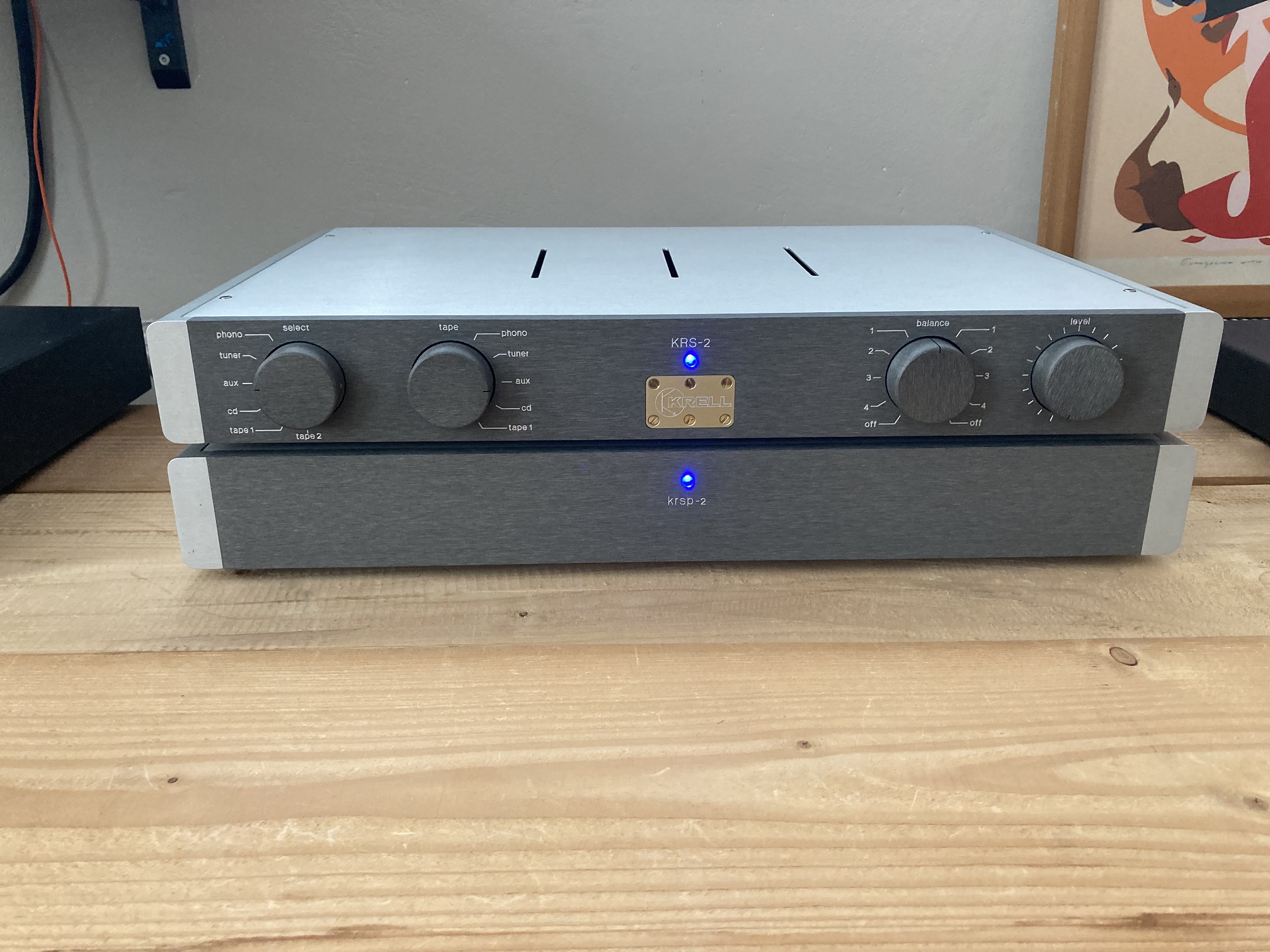

Pass color LED's on Krell KRS-2
Bit trivial but as said I would replace the blue approx. 500nM wavelength diffuse 5mm LED's from the KRS-2 preamp with the same color as Pass Labs uses.
I managed to establish the right wavelength as 430nM and sourced the appropriate LED at Mouser.
The partnumber is 'BIVAR 5BWC' listed on Mouser as 749-5BWC.

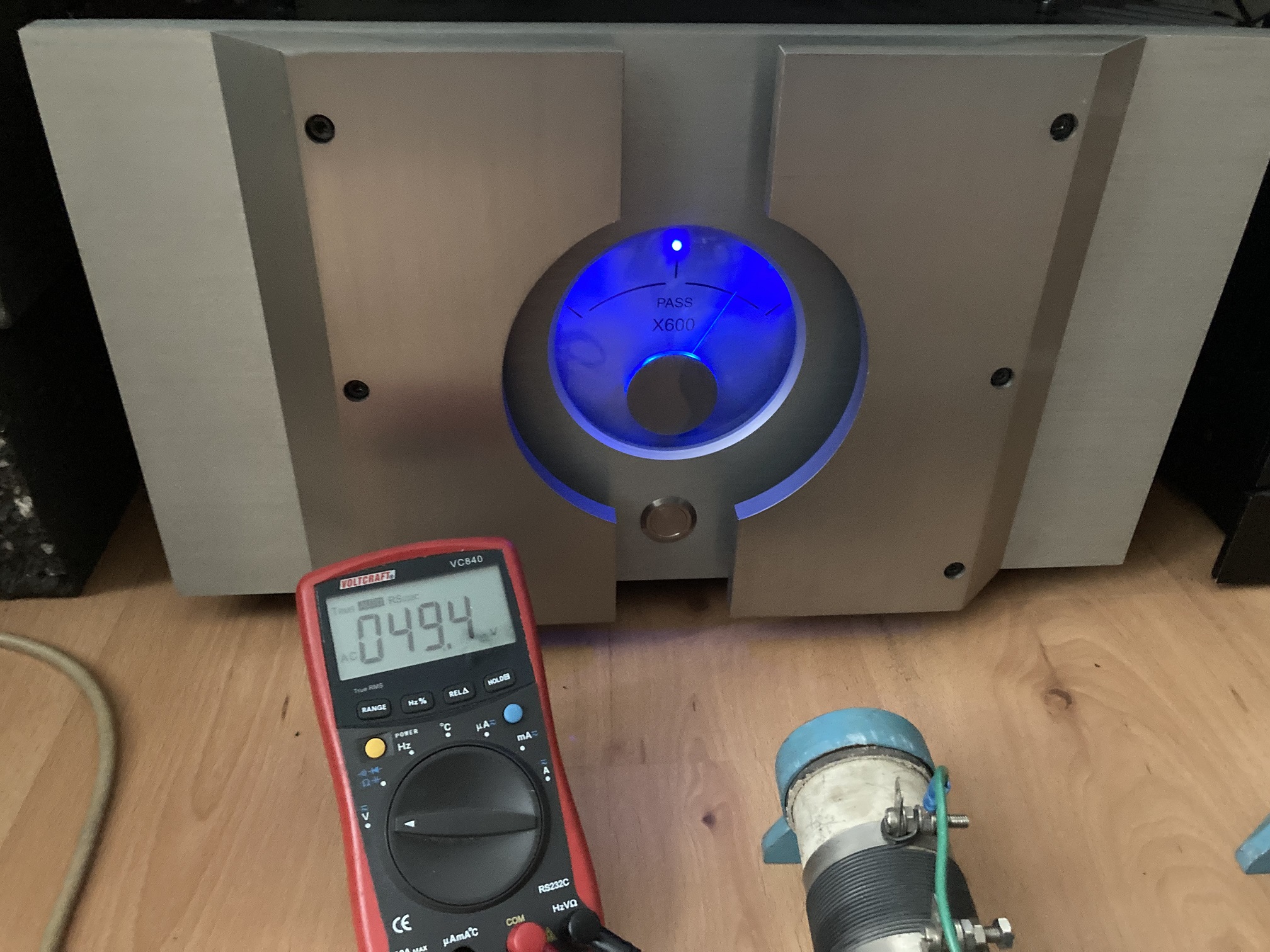

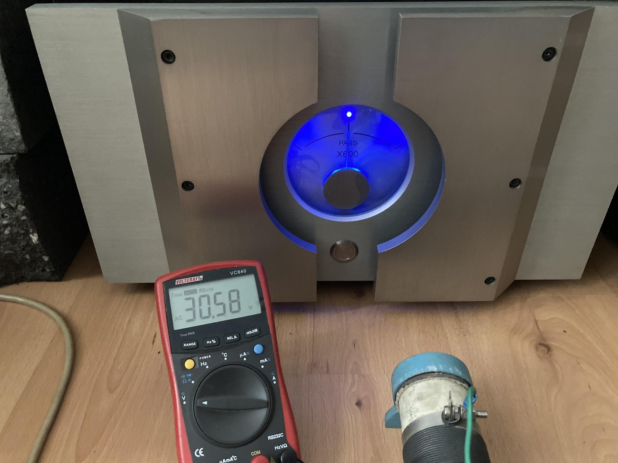

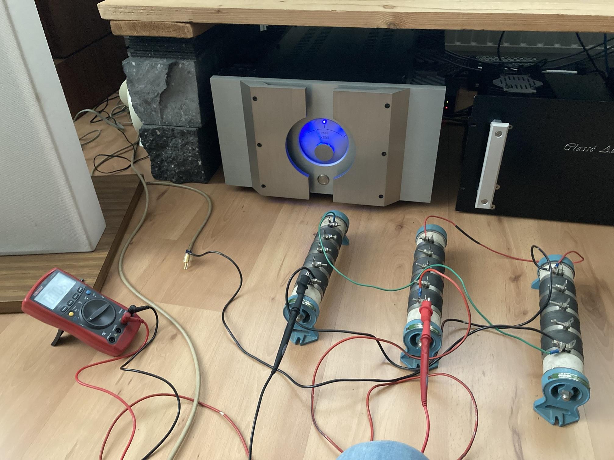

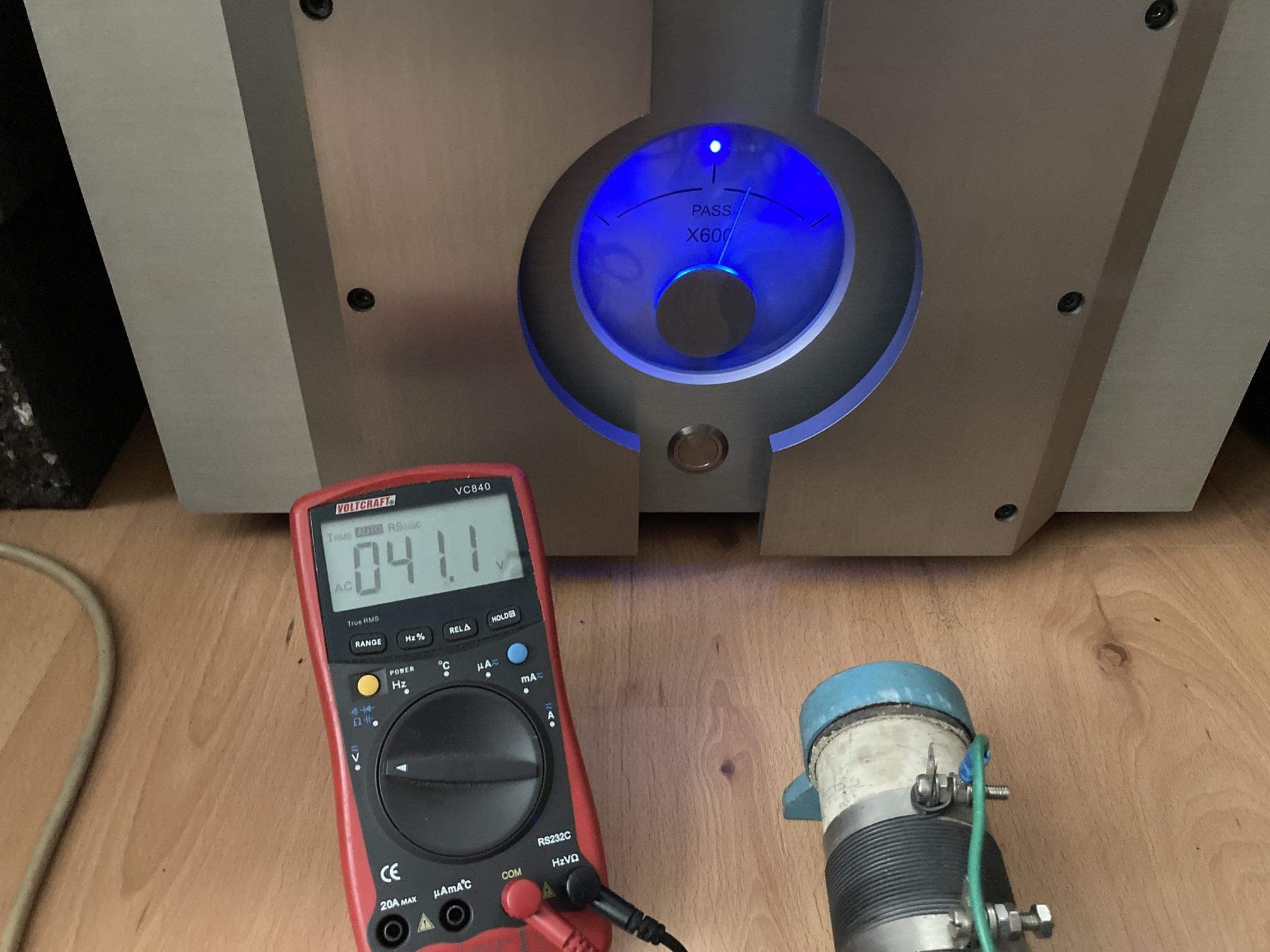

With the Infinity Kappa 9A and Acoustat 2 + 2 loudspeakers, it is not that difficult to get that lazy meter moving. But because there's no decent scale it is guessing how much power the X600 delivers with the meter in a specific position. So I took some powerresistors configured 8 Ohms and let a 1KHZ running trough them.
At 10 Volts the meter on the X600 starts moving so that's 12 Watts Class A RMS at 8 Ohms, bit disappointing with the heatsinks reaching 48 degrees Celcius.
Well it is what it is.
Then meter exactly in the middle of the scale is 30 Volts or 112 Watts.
Then a 200 Watt and 312 Watt position. Resistors are "singing" at 312 Watts and got hot so I did not dare to go all the way and chickened out...

Could you use some electrical train "break resistors" to test max. power from amp?
Yeah sure, have a couple lying around...😉
Something like this may do it 🙂
BRAKING RESISTOR 8 OHM 1200W - MEP Inc.
I wonder if an electrical toaster or electrical heating element could be used......maybe a couple in parallel to get low enough impedance 🙂
