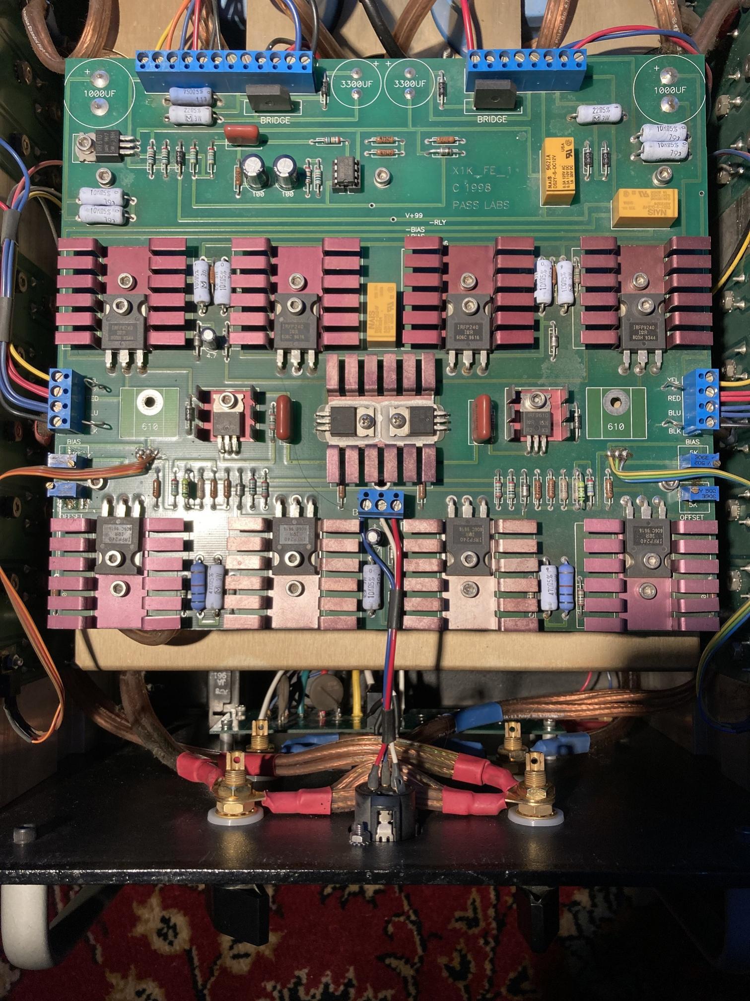

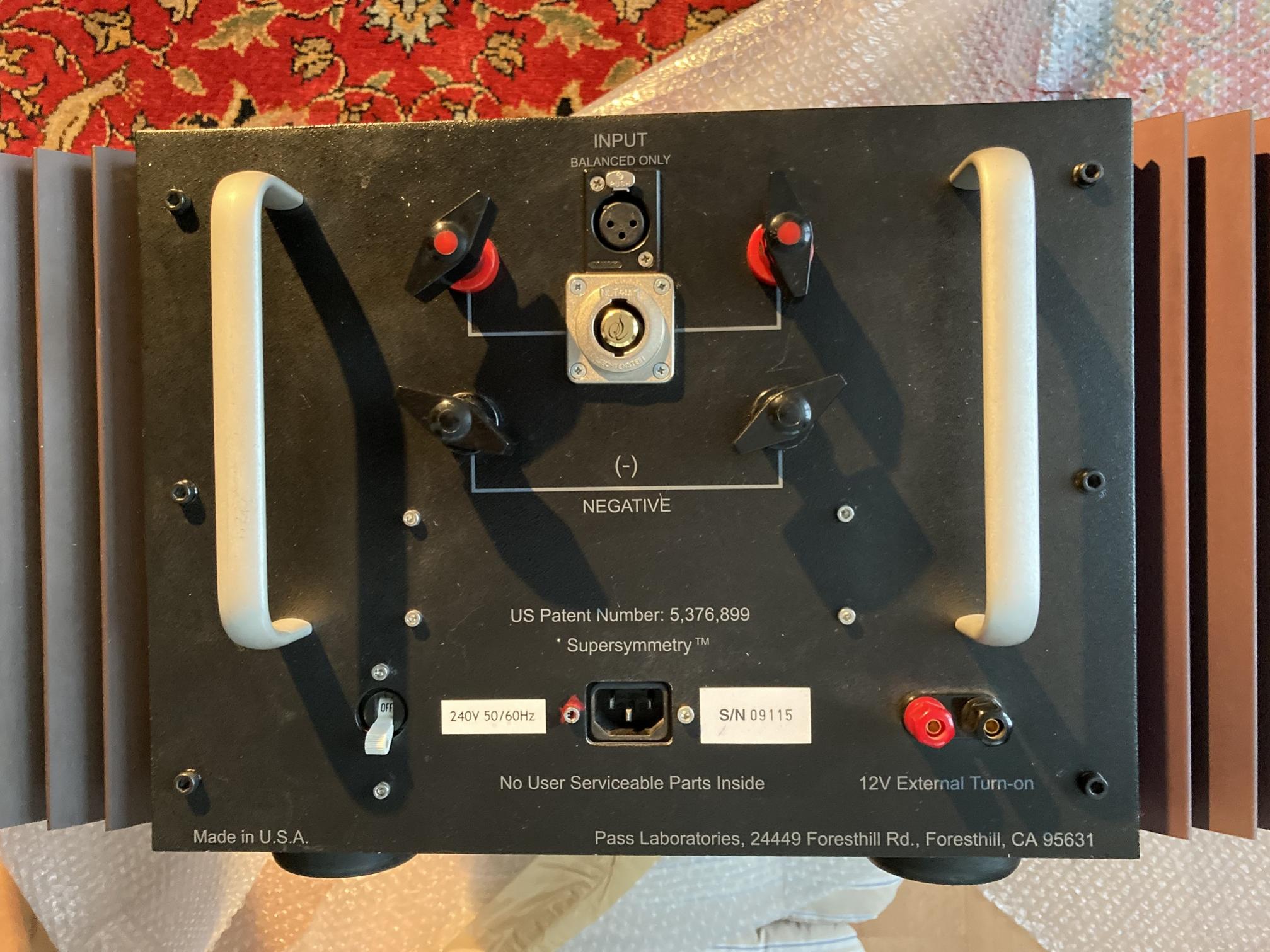

I've another question.
The former owner installed a RCA connector on the back but did not connect it to the front-end PCB. You can see it on the back but it is hidden under the myriad of Monster Cables ls cables inside.
These first X and XA amps have been designed to only accept balanced inputs by means of a XLR connector because of their X (Su-Sy) configuration.
The later incarnations .5 and now .8 have also RCA inputs.
From the manual I know that the XLR connector is wired as follows:
pin 1 is ground, pin 2 is the positive signal and pin 3 is the negative signal.
Maybe this is a dumb question but if I want to drive my X600's with a tube pre-amp with only single-ended outputs (RCA's), how should I proceed?
Normally you would connect pin 1 ground and 3 NEG together, but would that upset the working of these amplifiers?

Hi ZenMod,
Thanks.
And the white colored input lead is ground, blue is negative and red is positive if I'm correct.
Then RCA inner pole must be connected to the red terminal and the shield must be connected to the white terminal and the I can short from the outside with a U plug (which I do have somewhere ;-)) pins 1 and 3 (blue and white).
dunno for colors and usually I don't care, because that is not exactly standardized
what I know is
XLR pin 1 - GND
XLR pin 2 - positive hot
XLR pin 3 - negative hot
for RCA you're using GND and positiive hot, while negative hot must be grounded , as I wrote in previous post
