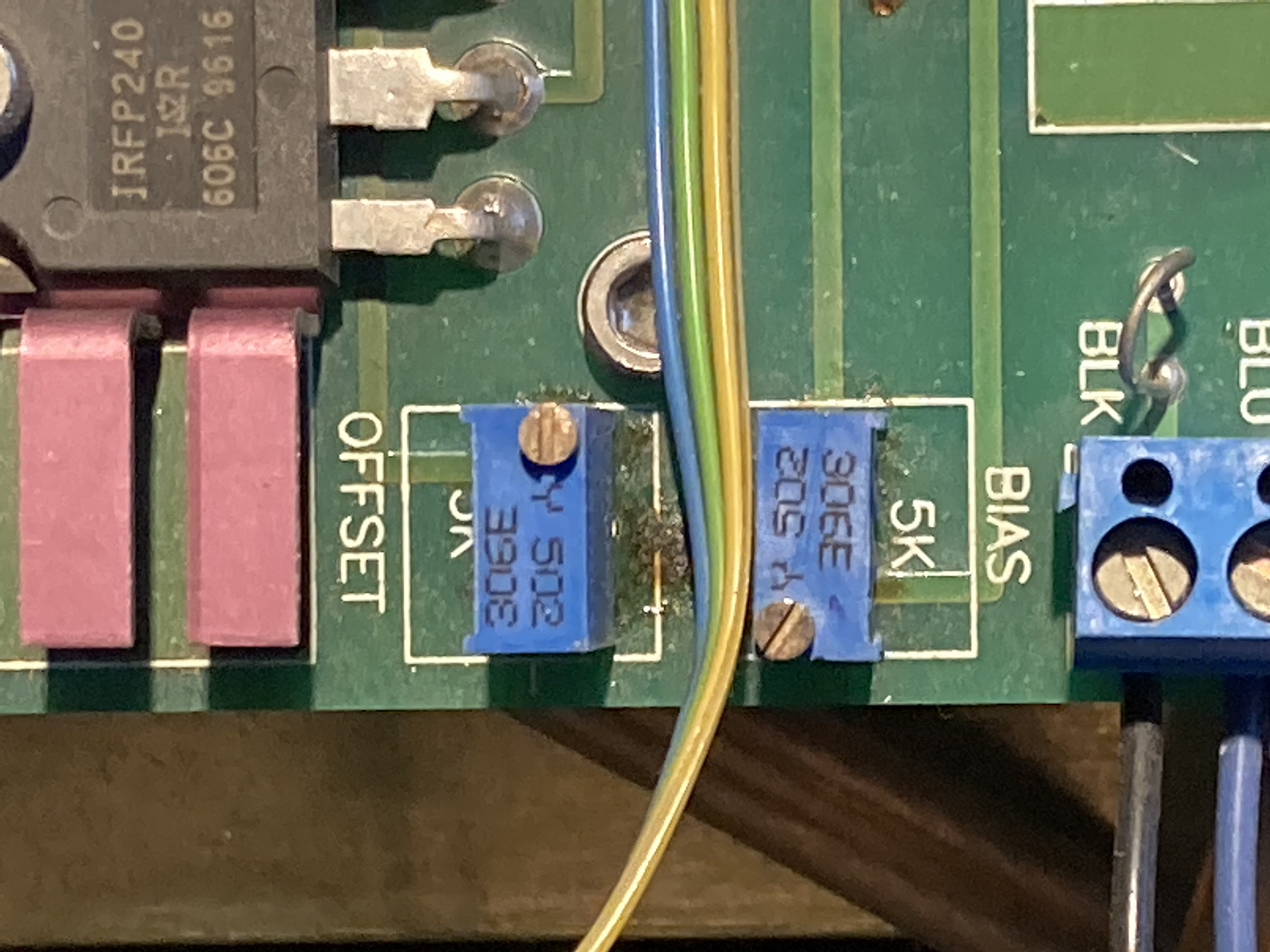

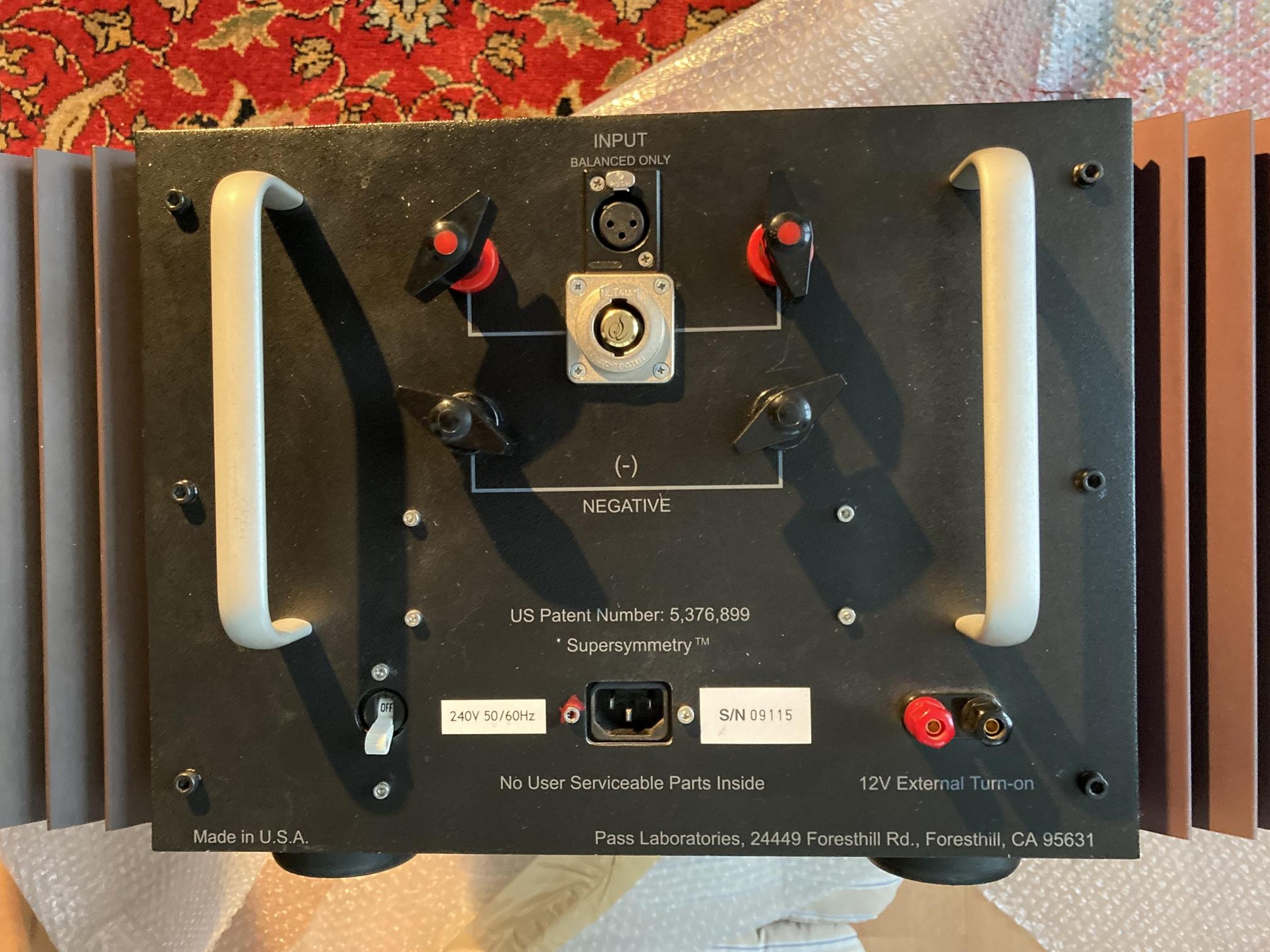

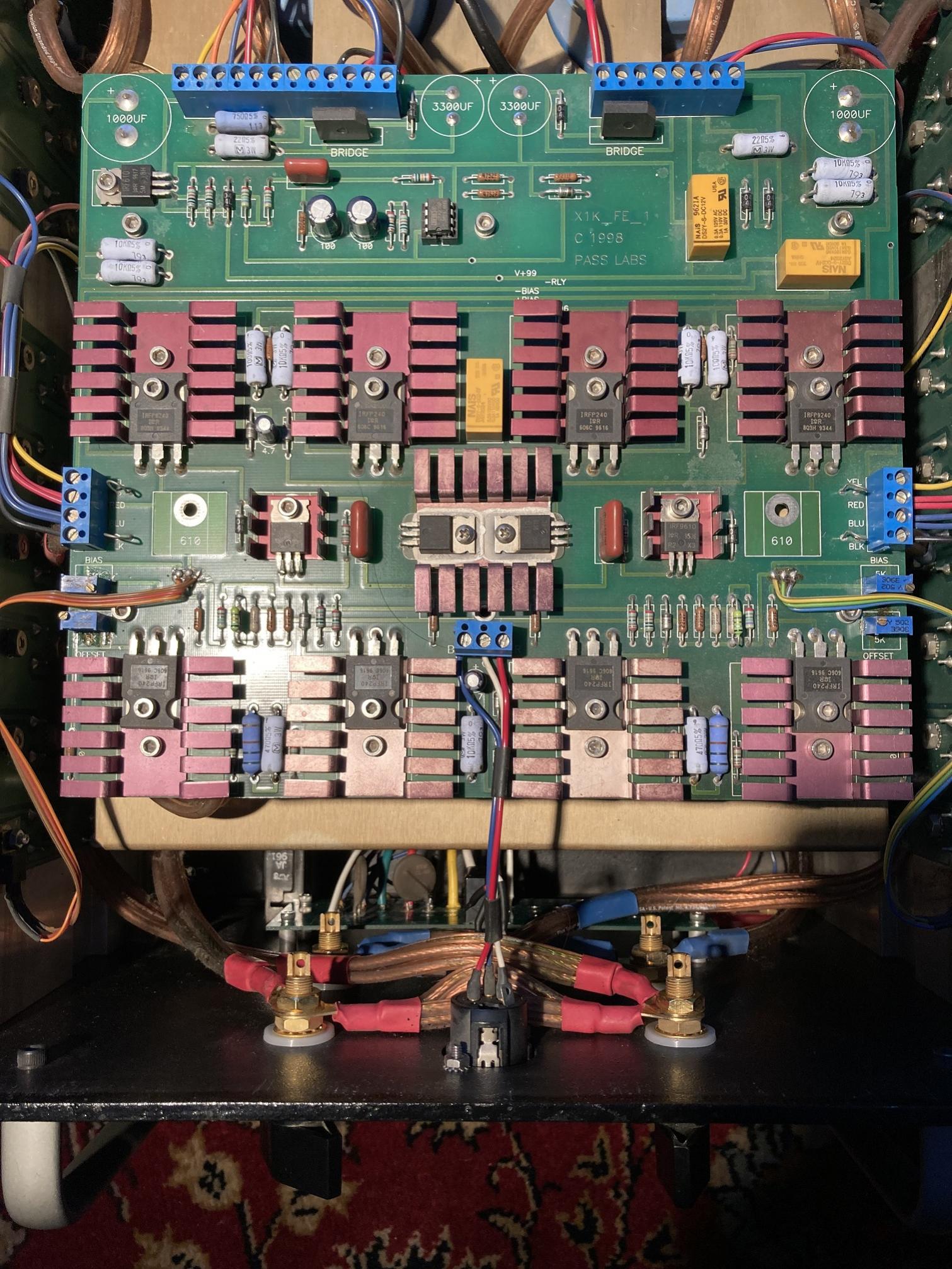

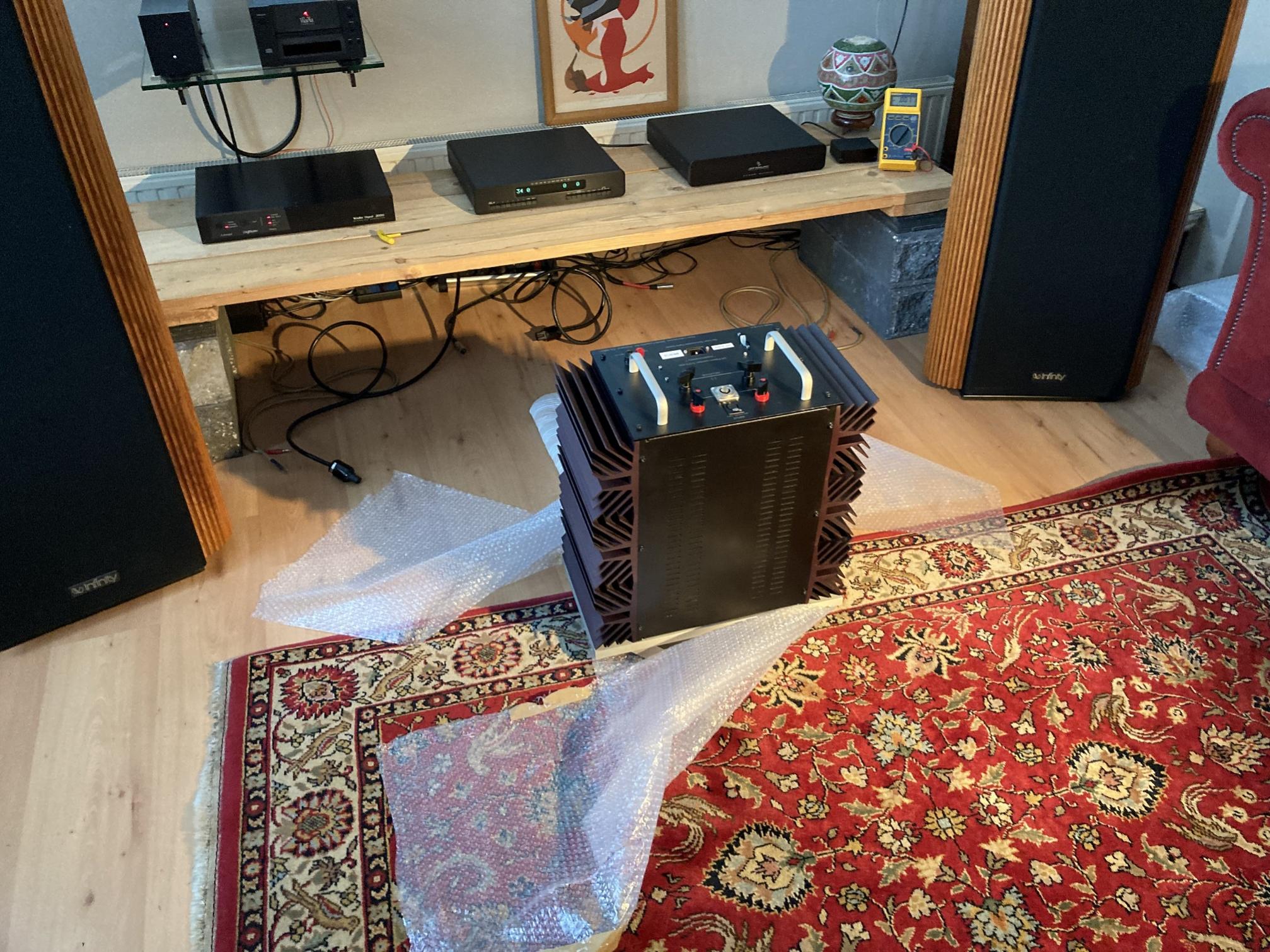

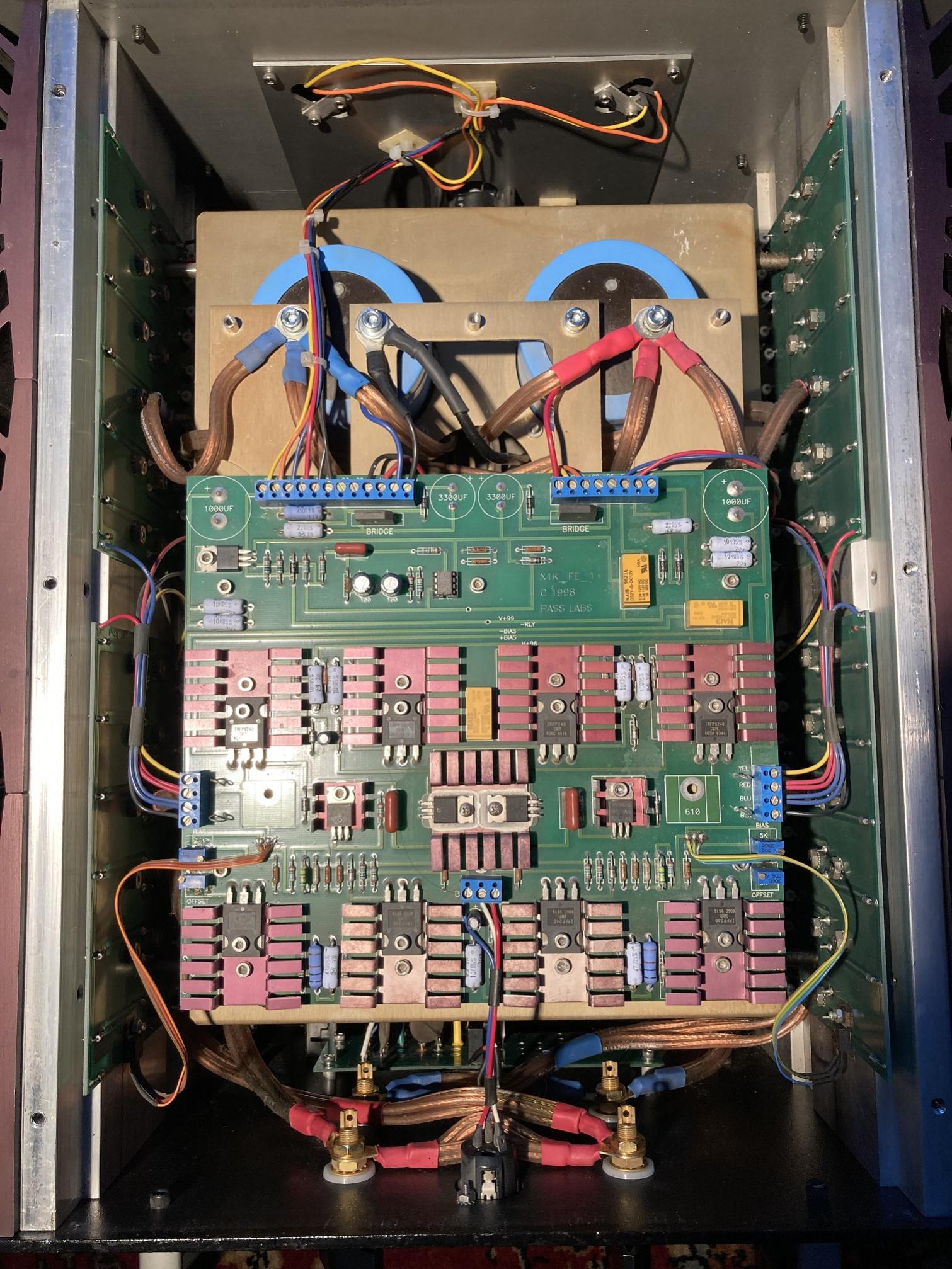

Meter won't move even with Kappa 9 low end.
Low end is the best I've had, better than Krell KRS-100's.
I'm very happy with my birthday presents!

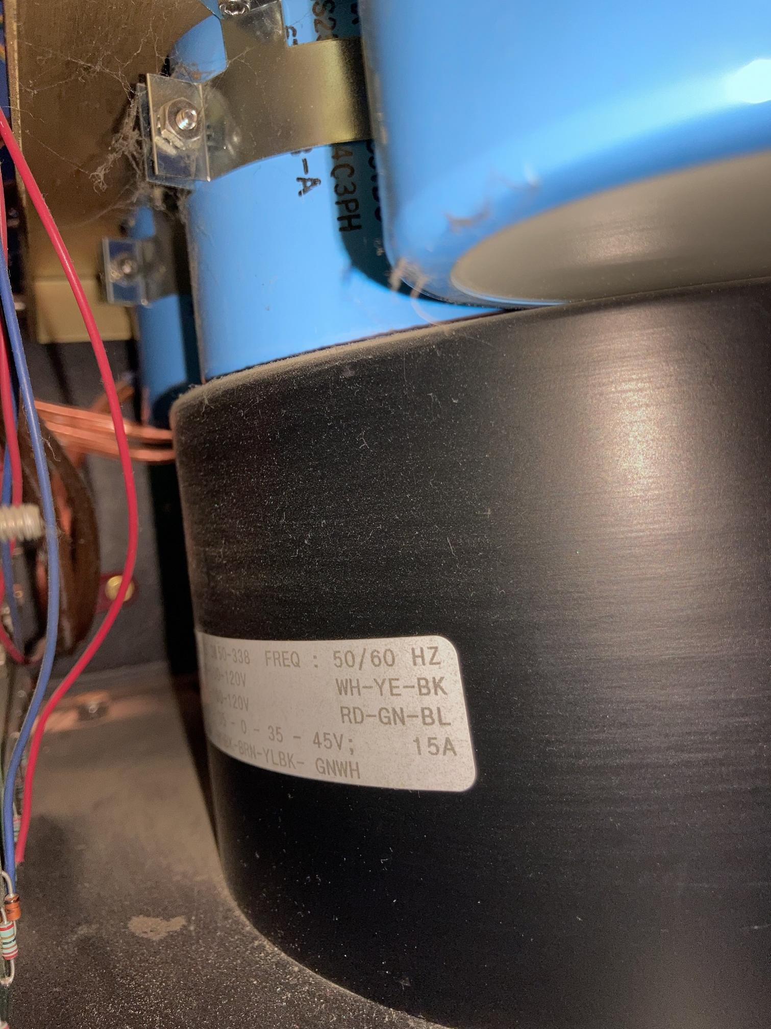

The powerlytics are happily flowing.
And little critters can live in the cellar nice and warm...

The only thing that would ever need to be done to those would be a re-cap, but the factory ones are probably good for years to come.
Nelson said when he serviced a pair of 1980 Stasis 1's, the Mallory filtercaps were still okay. Maybe there are some low voltage smaller caps that need to be replaced? Don't know what PassLabs does with those sold in continental US.
I don't trust the distributors over here particularly with these kind of amps.
I could perform a capacitance and ESR measurement with a special meter I have for these power filtercaps...

What I find also astonishing that these are the first big amps that are totally silent. No mechanical or electrical hum from those 15A toroidals. The fit and finish is also superb. No ringing of the cooling fins and the chassis parts fit very tight together. Must have been a tour de force 22 years ago.
Only the cooling fins are more purple than black....
There are two power supply electrolytics on the board and a couple in the bias circuits that are low hanging fruit, but I don't think I would bother unless you hear noise or the bias gets off.

Thanks!There are two power supply electrolytics on the board and a couple in the bias circuits that are low hanging fruit, but I don't think I would bother unless you hear noise or the bias gets off.
I hear no noise and the bias is on spec.
So I keep them hanging for a while.....
