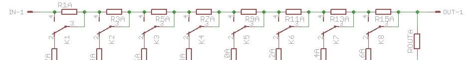

It does matter, the relay attenuations only work accurately when each relay is loaded with the specified load.
You ask for a 10k relay attenuator and all the calculations assume that this load is actually attached. Each relay presents that specified impedance to the preceding circuits when that relay is also loaded to the specified impedance. The last impedance (that fixed resistor) must be the Rload. The right hand calculator shows 10k2 to be used in parallel to 1000k to give the 10k1 shown in the box above.
Had they actually used 10k1 || 1000K then the impedance would be ~9k99901

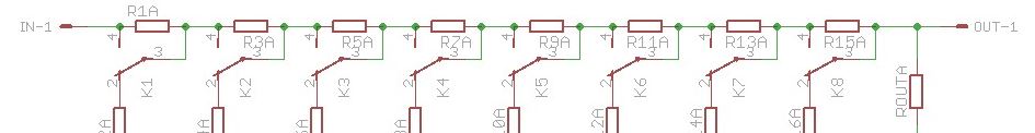

The first relay attenuator is loaded by all that follows.
The clever bit that allows this to work is that everything that follows is always 10k (or your set value).
Look at the first attenuator.
The contact is in the down position.
The first resistor (R1A) is the series resistor of the attenuator.
The lower resistor (R2A?) is a part of the shunting resistor. That shunting resistor AND all that follows are a parallel combination. You calculate that parallel combination and then use that in the normal Series+Shunt ladder attenuator.
When the relay contact moves up the top resistor is bypassed. The Shunting resistor has an open circuit.
Now all that follows is 10k.
If you move to the last relay (K8), exactly the same logic applies. All that follows = 10k etc......

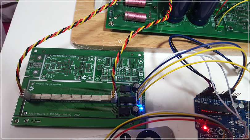

Hi Maxw,
Last night, I tired to check of the each relay's electric connections with multimeter.
I've connect one test probe on the digital ground, and put another probe on the all 8 relays' pin 1 & pin 8 step by step. And increase/decrease with encoder.
It's strange because all relays' pin 1 & 8 show 5V in the same time in every steps even when I decreased/increased volume level... but in every steps, there are still clicking sound without music. (The power is measured 5V(high) on CS & VDD of the board.)
I guess there should be 5V or 0V, even -5V on each relays' 1 & 8 pins as programmed order...Is it matter of the control chips? 😡
Last night, I tired to check of the each relay's electric connections with multimeter. I've connect one test probe on the digital ground, and put another probe on the all 8 relays' pin 1 & pin 8 step by step. And increase/decrease with encoder.
rainwalk, you need to understand more about how it works because this test method will not work. The relays are latching relays so they only need power to change, not constantly.
You can see here:
https://github.com/FutureSharks/preamp-passive/blob/master/preamp-passive.ino#L242-L246
The voltage is only applied to the relay for 1ms, much to fast for you to be able to measure. So the voltage across relay pins 1 and 8 will only be +5V or -5V for 1ms, then it should be 0v.
I'll write you some instructions on how to test later tonight.

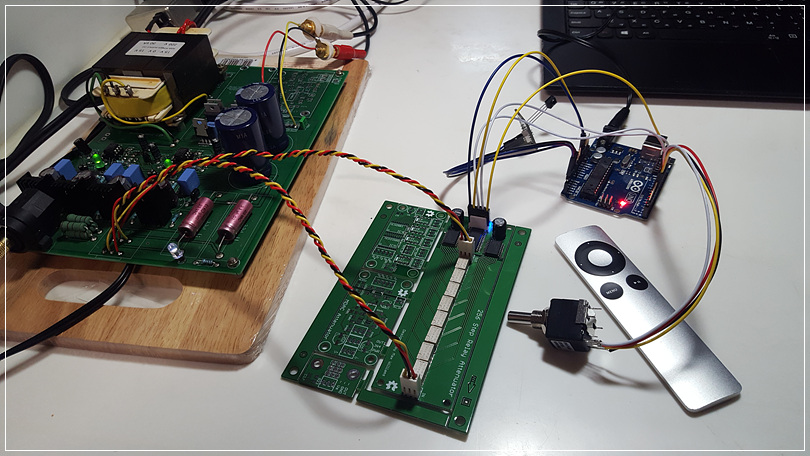

Hi Maxw,
I'm very pleased let you know that I finally succeed in building your passive attenuator. It's now working perfectly and very good sound.
As per your advice, I have modified the code and test each relay's movement. As a result, I found 2 relays from each board (total 2 board I have already made) were stuck. First time, I changed the one relay. But new relay also stuck. So I added 0 in to your code. 😉

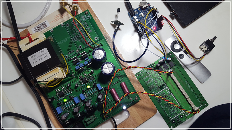

I just change delay(1) to (10). Now... all problem disappear into thin air😀 (ofcourse, Even total 4 realys are gone (I don't know, why...)
Then, everything perfect. I'm really happy becuase it make me confused for several weeks! I don't know why it didn't work with delay time 1 for me, but I hope it could be help to another diyer.
Thank you very much Maxw for your sharing and kind support so far. 😉
Only one thing I want to improve is that volume increase more smoothly.
I guess I need to try with various resistor values. And with my headphone amp, from step 1 to almost step 120~150, volume is too small so make useless 255 steps. I should test it with my preamp (not only for headphone amp) and then study for it later.
Anyway, It's tiny, easy😱 to diy, fantastic performance passive attenuator!! Great! Thank you again.
