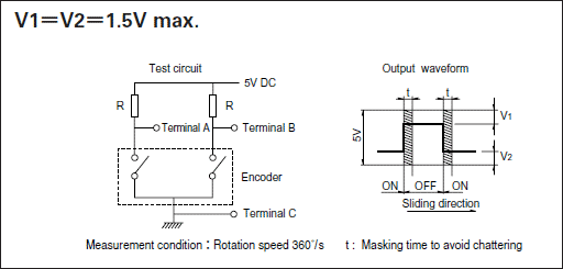

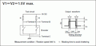

This is normal ALPS rotary encoder. Please see the picture attached,,
And I also find out the reference for this encoder, but I'm not sure it's for Arduino...😀

What code are you using? That code you just posted or my code?
Of course your latest code here.
https://github.com/FutureSharks/preamp-passive
Hmmm, OK.
Well, I think your encoder has either a poor connection or your grounding is bad or something. I've that exact thing before when this is the case. The attenuator just randomly changes very fast.

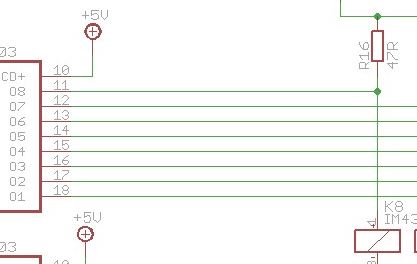

I found some error on the board.
when I tried to heard music with connected speaker, for the first time there was no sound even the relay clicking sound have been heard in every 5 seconds. So I've check again the board and your schematic. the input/out-put of your board should have to changed. It's mis-print I guess. I see your schematic again and I think I'm right. 😉 So I changed the input/output connect on the borard and I can heard the music finally.
So there is one serious question. Because input/output should have to change to opposite side, those all resistors should have to change their positon on the board also???
Second is for the value of resistors. In every 5 seconds, fist two steps(relays) volume level are same with my ears. Last step one is louder, but 1st & 2nd step have no difference.
Third is for the still encoder... when i tried to connect again my ALPS encoder, it still looks like machine gun😀... no changed...
but the difference, now I can heard the music even the volume rapidly/randomly increased, decreased with machine gun sound. 😛
I hope your kindness Maxw... because I'm really beginner so It's will take a year to build up right code by myself...
Hope you check my report in your side.

Sorry but I don't really understand where you think the mistake is 😕
I'm sorry I misdeem the schematic. I mistaken the IC pin number which in the box as out side number. Sorry for make you confused. 😕

I bought Bourns encoder from digikey and it have arrived this weekend.
Now the relarys working seemed perfect. Not anymore machine gun!😀
