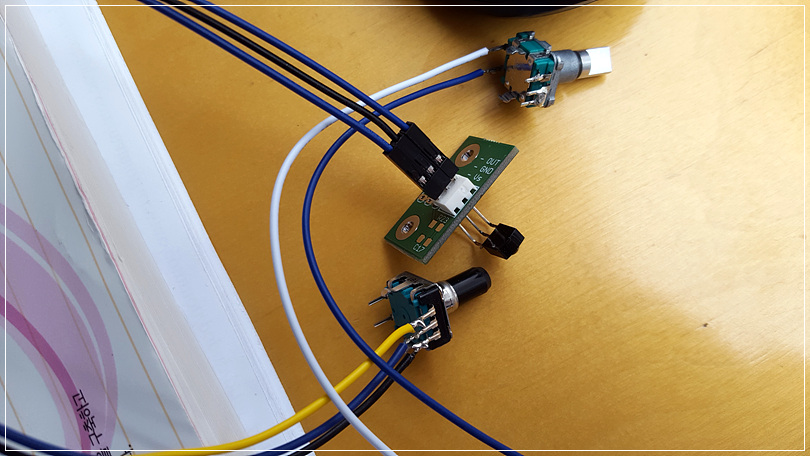

Hi Maxw,
As I told you before by email, now I'm building up your passive preamp as an relay R2R volume controller in my preamp.
As you guess, last night i tried to upload the code into arduino and connect the passive preamp PCB, but noting happen. The led light well. but when I turned to encoder there are noting happen. No clicking sound from preamp board.😱
I thought I never tried arduino, so that tere are some mis-operation... ex/ libraries, how to install..😕
for more quick check, would you let me know how to connect the encoder?
In you diagram, there are 4 lines from encoder. My one have 5 pin. up-side pin are 3. low-side pin are 2.
would you let me know or attache more detail picture??🙂

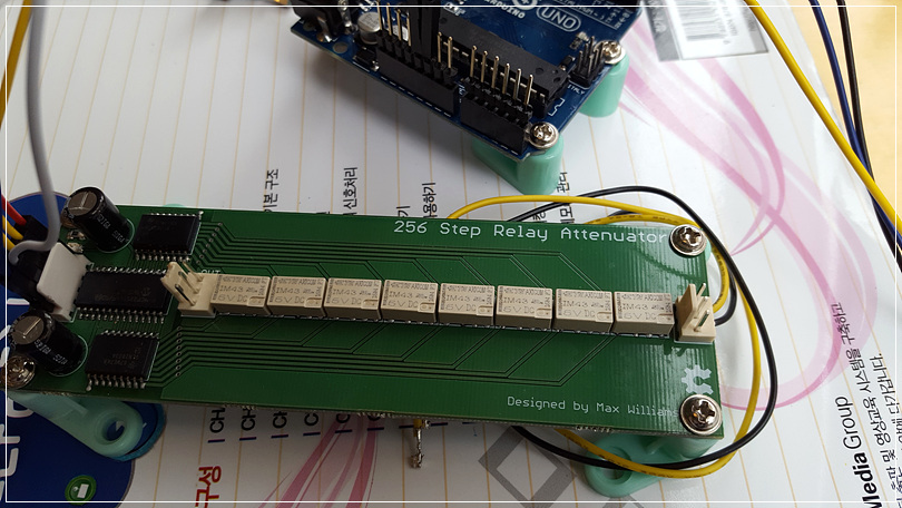

Hi Maxw,
Finally I upload code to my arduino uno. when I turned on the passive preamp, it's sould like machine gun. 🙂 Relay make machine gun sound but no music, and no music.
I also tried your old code in page 1, but it same. Would you give me some advice?? ^^
And when I look the code, (of course I'm really beginner of arduino) some strange lines in there. your diagram and pin number of the code looks different.
and would you alos let me know what pins should connected of the board header pin?
SI, SCK, CS on board mean that SI=SDI, SCK=CLK, CS=CS, right?

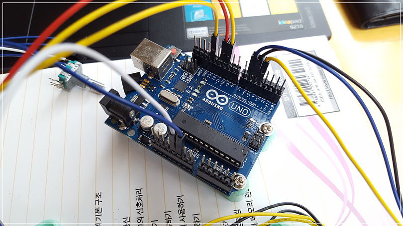

Hi RS232,
Thans for your asking. Unfortunately, I'm real beginner of Arduino so that I don't understand what you said, checked the pinout. 🙂
But I've check the Maxw's code and wired the pin as as my guess. The connect diagram seemed different with code.
Here is some of Maxw's code
// SPI library
#include "SPI.h"
// Arduino pin 9 & 10 = Input selector & Relay attenuator
// Arduino pin 11 = SDI
// Arduino pin 13 = CLK
// Relay attenuator stuff
const int AttenuatorCSPin = 10;
byte currentAttenuatorLevel = 30;
bool muteEnabled = false;
byte lastAttenuatorLevel;
/ Encoder stuff
const int encoder0GroundPin = 6;
const int encoder0PowerPin = 7;
int encoder0PinA = 5;
int encoder0PinB = 4;
int encoder0Pos = 0;
int encoder0PinALast = HIGH;
int n = LOW;
float encoderIncrement = 2;
would you let me know right connection method based on the code? for
Passive preamp board, Encoder (different from Maxw's one), IR board etc.
I use Arduino Uno board and other parts are same with Maxw's one.
Relay also same.
Here is my stuffs pictures for your reference. I test two different encoder but it's same... no music but relay clicking noise as like machine gun....

So you got the encoder working, you can hear the attenuator changing (yes, it's loud), but you get no sound, correct? Are you using an input selector? Can you just connect the attenuator only and skip anything else in the signal chain?
Yes it's a 10K attenuator and the resistor values are not the exact values. Both the eijndhoven and amb calculators will give the same values for a 10K attenuator and you can see in my BoM that my values are close enough but not exact. You will find that getting exact values for all resistors from a single supplier is really hard if you want metal film resistors.
Yes, you are right, some pins were inconsistent. I've fixed it here:
https://github.com/FutureSharks/preamp-passive
Was there another inconsistency?

Yes that is correct. Unfortunately pin naming is not exactly consistent between manufacturers.and would you alos let me know what pins should connected of the board header pin?

From your pics it looks like you have encoders with a button. So there should be 2 connectors on one side of the encoder for the button and 3 on the other side connected to the encoder (A/+5V/B)
My connection diagram looks different because my encoder has 4 connectors.
If you want to copy my approach of powering the encoder from a Arduino pin then connect A/B to pins 4/5 (doesn't matter which way) and connect +5V to pin 7.
If the relays click while you rotate the encoder then it's connected correctly. If you don't hear music then perhaps you have a different problem.
