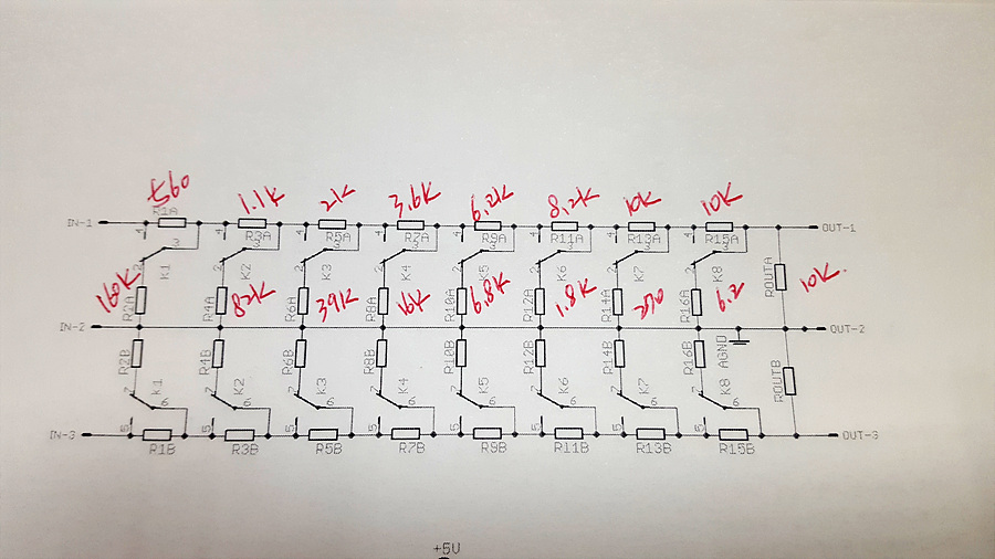

1. Check the resistor values. Are they correct? You have three projects to compare to: Mine, eijndhoven and the AMB. All three projects have the same schematic and part values. Just check you have it correct and then just stop soldering and unsoldering resistors.

would you check my resistor values based on your BOM?
I also check with AMB value, but it's looks very different.... 😕

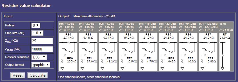

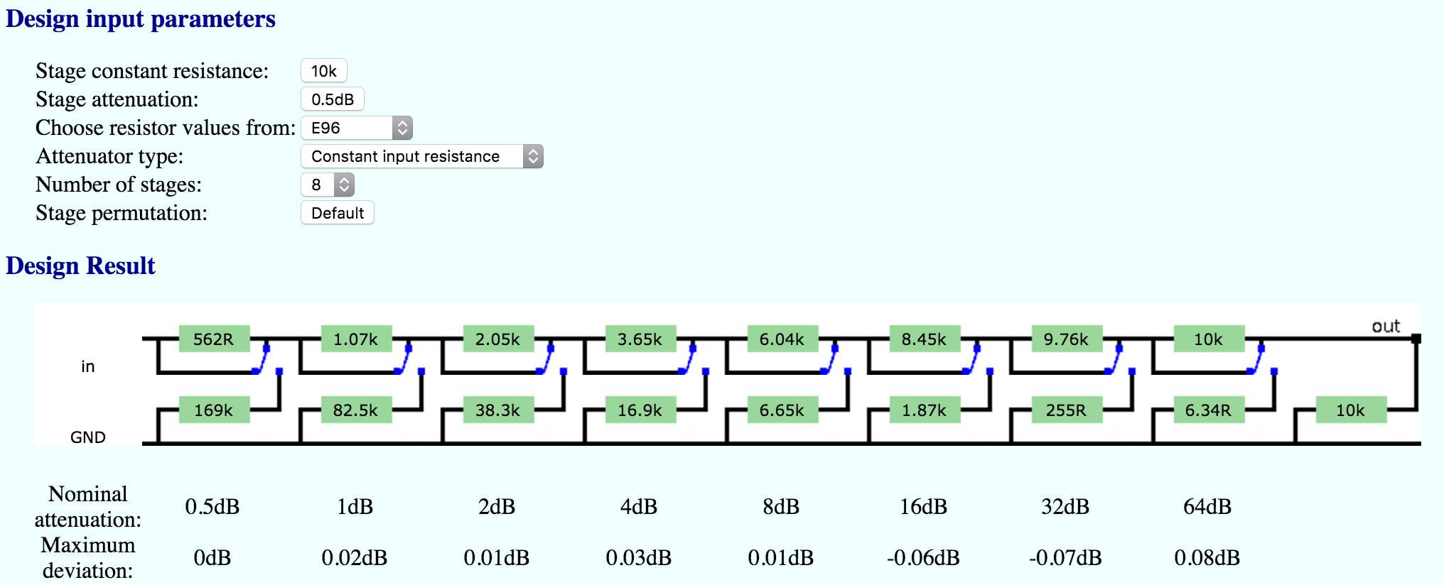

These calculators assume the load is a fixed value.
You set that value as an input. Rload
When you come to connect your attenuator into your system, the attenuator sees the input impedance of the Receiver.
You must insert a resistor to ensure the attenuator sees the impedance you asked for at the design stage.
Suppose you wanted 10k as your Rload.
The input impedance of your receiver is 47k
You fitted a 10k resistor to the attenuator.
The attenuator sees a load of 10k||47k = ~8k25
That loading resistor really needs to be selectable to suit the input impedance of the Receivers you may want to use.
For various impedances you could have a stepped final resistor.
for 10k Rload
Input Z . . Rload
100k. . . . 11k111
50k . . . . . 12k500
47k . . . . . 12k703
22k . . . . . 18k333
20k . . . . . 20k
10k . . . . . open

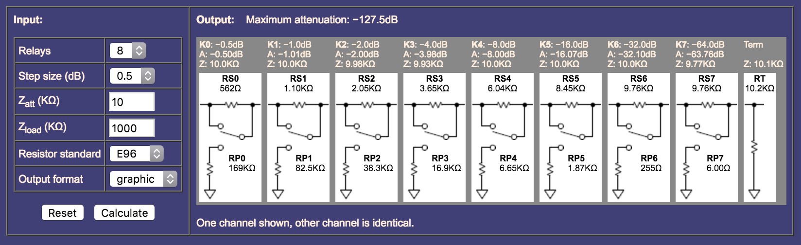

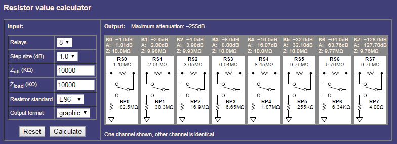

No.
Zatt is 10.
Zload leave as default 1000.
That is the values I used. Same as the eijndhoven.
No.
Zatt is 10.
Zload of 1000kohms is unreasonable.
Use a value that is likely to be attached, somewhere from 10k to 100k
Note that the left calculator assumes a 10k Rload
The right hand calculator tells you what resistor is required to adjust your Zin to match your required Rload.
It does matter, the relay attenuations only work accurately when each relay is loaded with the specified load.
You ask for a 10k relay attenuator and all the calculations assume that this load is actually attached. Each relay presents that specified impedance to the preceding circuits when that relay is also loaded to the specified impedance. The last impedance (that fixed resistor) must be the Rload. The right hand calculator shows 10k2 to be used in parallel to 1000k to give the 10k1 shown in the box above.
Had they actually used 10k1 || 1000K then the impedance would be ~9k99901

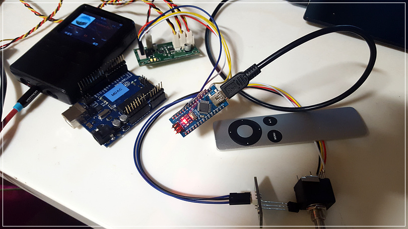

For the past week, I also made your MDAC and it's working perfectly with my Apple remocon and Arduino Uno, also Nano too.
I haven't attached the selector yet, but other things all work well. Thanks you, Maxw.
Now I'm going to check if there are sound coloring and other conditions.
One thing that ask to you is that how I make MDAC with no gain?
As per your comment, it have 12db gain. What resistor should have to removed for no gain??
