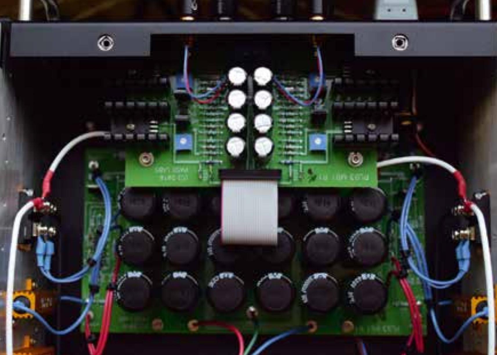

Me an idiot. I see now what you guys mean by hockey pucks. So they are output devices.
Yeah that two fat IXYS mosfet's push-pull amp stage.

I think Henryve was about bridges because some one write (-) (+) on them.

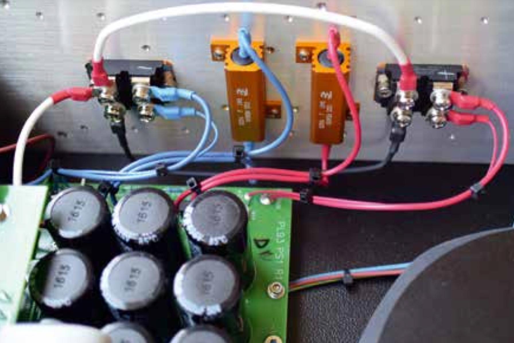

OK they are fat mosfet's P and N channel's and mysterious orange resistors 😀

The wires going to the orange resistors comes from the cap boards of the PSU. The conclusion is a simple one. 😉
It's easy.
Bipolar (+)(-) psu= CRC||CRC parallel for mono channel.
Ah ok that explain 4 power resistors in psu. One possible answer.
Not sure what components are under of front end pcb maybe bunch of mox 0.47 R resistors ?
See the right and left side of psu capacitors we get few components in relation with hockey puck's power output stage.
