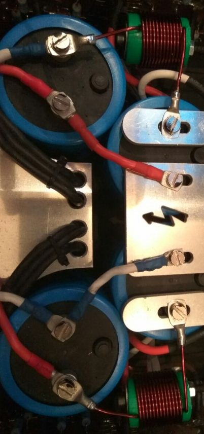

My friend and me did experiment with P.S. filters.
There was 6 caps 33mF.
Clean C banks has best punch on the bass.
We start with 33mF+0.1ohms+33mFll33mF and we notice that bass lousing punch, start to be soft. It come backs with around 0.02-0.03ohms resistance.
Then we decided to try to keep that resistance wich doesnot influencing bass response and to add some inductivity.
On the end that was the best compromise sound related, clearly it smoothing midrange and keeps good bass.

I'm not certain to fully understand... did you replace the resistor by an inductor with equivalent dcr?

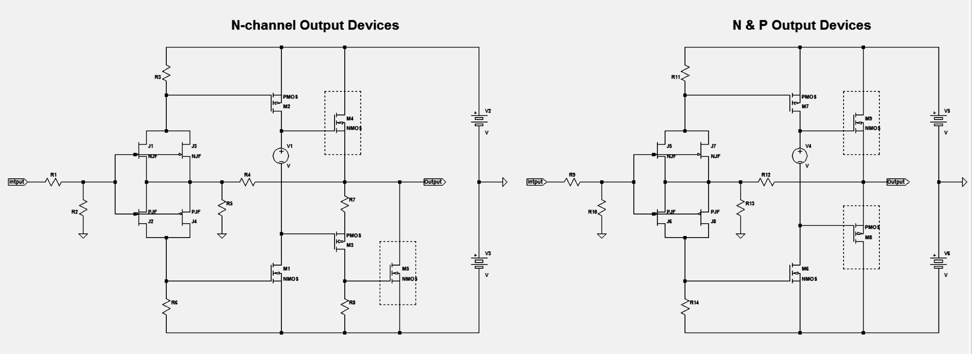

...The XA25 has an RCA input and not balanced outputs....
I will tell you this so that you can reverse engineer it:
1- Three stages,
2- DF is about 700,
3- high current,
4- high slew,
5- 0.00x% distortion,
6- 40 uV output noise,
7- big Class A envelope,
8- 25 watts into 8,
9- 100 watts into 2.....
From the home page:
...front end circuit uses uses:
10- two pairs of NOS complementary Fets in common-source mode
11- in a current feedback (CFA) confi guration.
12- The amplifier is direct coupled
13- and has no DC servos or frequency compensation.

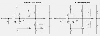

One (two) possible solution might be:
The PSU voltages are low for a 25W amplifier, and there is no mention of cascoding the input stage JFet transistors.
However it clearly says "two pairs of complementary Fets...", hence the parallell-coupled pairs of complementary Fets...
It is interesting to see how Mr Pass'es designs have evolved through the years:
- From complex to simple (it usually is the other way around ;-) ),
- From complementary to Single Ended,
- and then back to Complementary gain blocks again.
