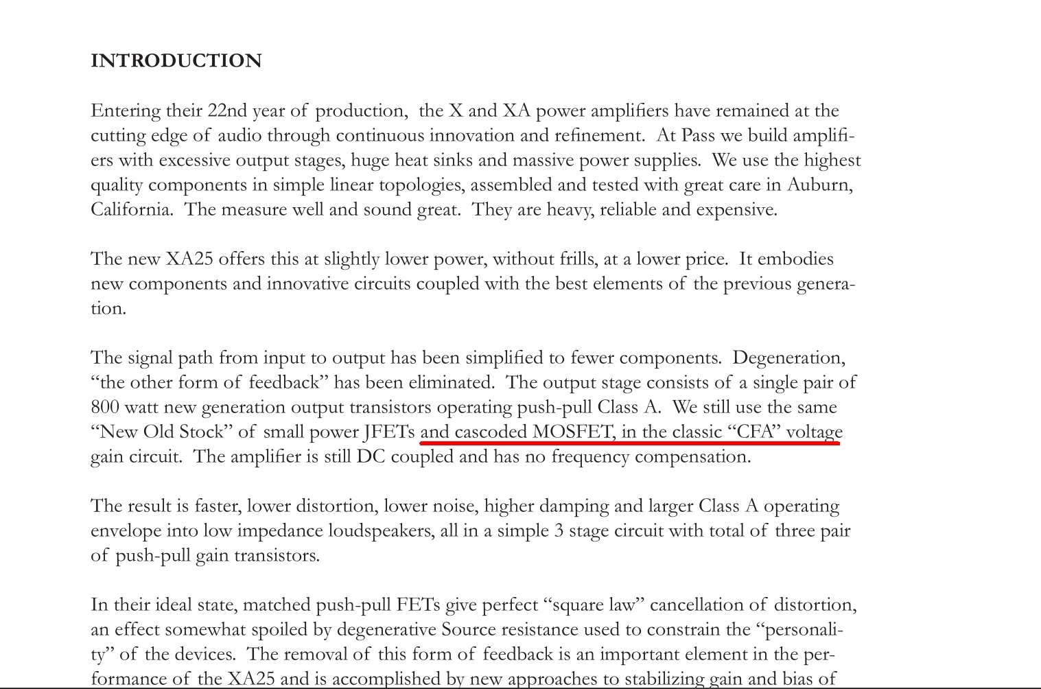

Well, the online XA25 manual reads:
- Degeneration, “the other form of feedback” has been eliminated.
- The output stage consists of a single pair of 800 watt new generation output transistors operating push-pull Class A.
- We still use the same “New Old Stock” of small power JFETs and cascoded MOSFET, in the classic “CFA” voltage
gain circuit.
- The amplifier is still DC coupled and has no frequency compensation.

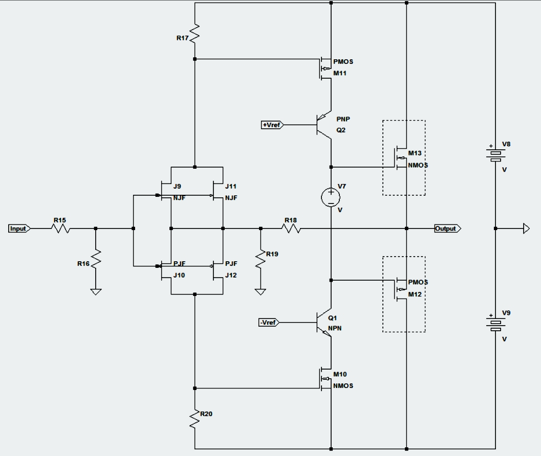

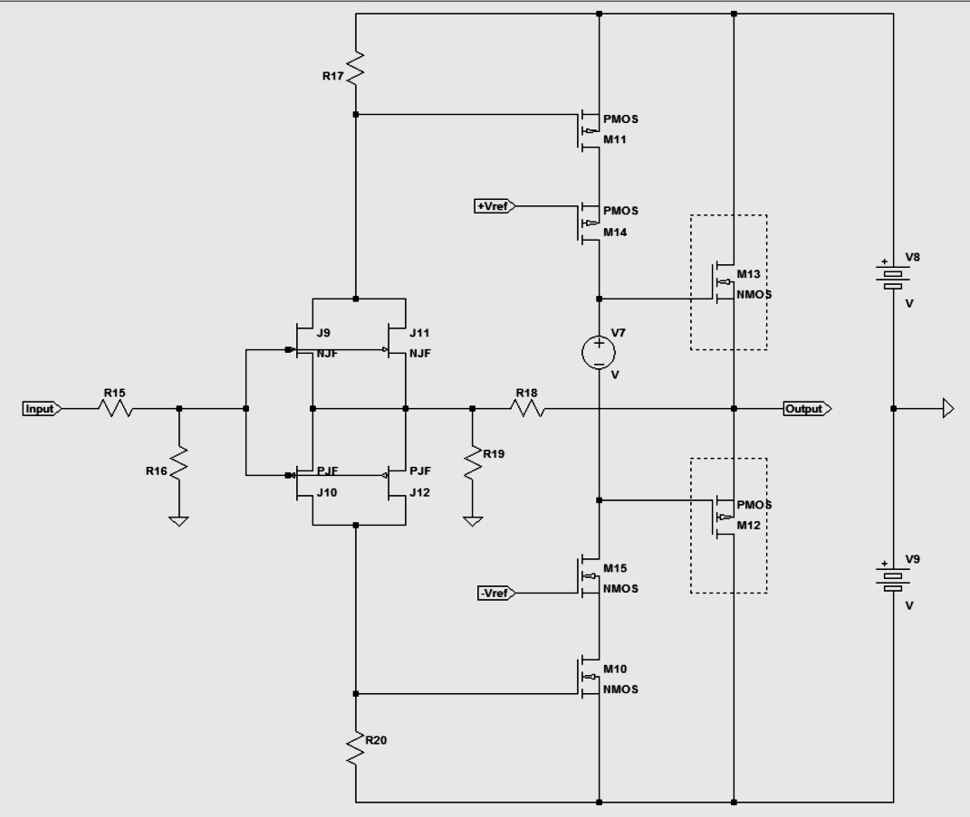

This changes the schematics above to include two cascode transistors:

Thanx for the info.
However, there is no mention of cascoded input JFETs in the manual, but the online manual clearly states cascoded Mosfets:
" We still use the same “New Old Stock” of small power JFETs and cascoded MOSFET, in the classic “CFA” voltage gain circuit."
Cheers...

I know that
but , if you take a look at pictures , you'll see just one pair of obvious candidates for cascode duty ..... and if they're taken by mosfets , that leaves tiny input JFets exposed to highish rails
so , it's more likely other way - input JFets are cascoded , so being umbrella-ed from excessive voltage , while mosfet drivers are
anyway , these contemplations are not near most important thing in XA25 - which is biasing mechanismus of hockey pucks - where exactly sensing is , and where exactly biasing is situated (how far to input side)
FE is sort of trivial to that ......... just follow all Papa's breadcrumbs we already have scattered all around

if you rephrase it ( as "power" being culprit term there ) as :
" We still use the same “New Old Stock” of cascoded JFETs and small power MOSFETs, in the classic “CFA” voltage gain circuit."
that could explain pictures ....... (especially if we know that small power JFet's are pretty rare breed)
The PSU rail voltages for a 25W amplfiier is around 20 Volts.
That is not excessive for the input JFets.
However, you might be right: that is the input JFets might very well be cascoded.
But remember, there is no mention of it in the XA25 manual, and I dont see why Mr Pass would not want to mention that.
From an electrical point of view, it is more beneficial to cascode the second stage Mosfets - the ones you call drivers, sine they need to run at quite high bias current levels.
well , your thinking have some logic
feel free to try your own ideas in vivo ,same as any other Greedy Boy around 🙂

As I stated earlier, cascoding the input JFets makes very little sense, specially in reference to the
XA25 literature, and the fact that the PSU voltages applied to the circuit are quite low.
Cascoding the second stage Mosfets are very beneficial in such a simple design, with only one drawback: limiting the output voltage swing.
Parallelling the input JFets has many benefits in this particular design, and it is likely that it has been implemented in the XA25.
logic is perfect ........ if you believe that Pa is feeding pucks with so low voltage (think of massive inter-electrode capacitances)
I know that I wouldn't ...... but that's just me

Anyway.... to quote from the latest operations manual:
'The signal path from input to output has been simpli ed to fewer components. Degeneration, “the other form of feedback” has been eliminated. The output stage consists of a single pair of 800 watt new generation output transistors operating push-pull Class A. We still use the same “New Old Stock” of small power JFETs and cascoded MOSFET, in the classic “CFA” voltage gain circuit. The ampli er is still DC coupled and has no frequency compensation.
The result is faster, lower distortion, lower noise, higher damping and larger Class A operating envelope into low impedance loudspeakers, all in a simple 3 stage circuit with total of three pair of push-pull gain transistors.
