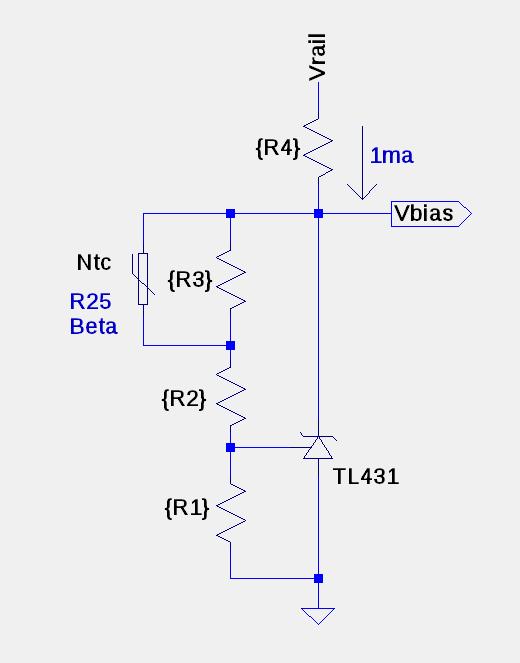

How did you implement the thermistor to control the bias drift? Are you using TL431? I have a simple idea of how use a thermistor with the TL431, but am unsure what value I would need to accomplish my goal.

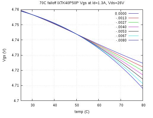

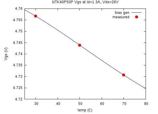

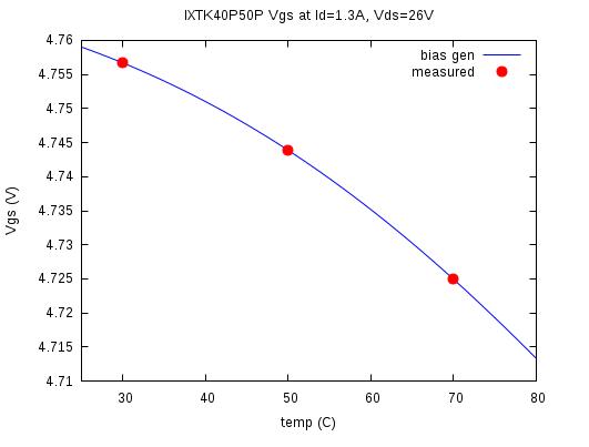

After understanding that capabilities of the IXYS hocky-pucks better, I conclude that there is absolutely no need for Positive Current Feedback (PCF). Wrt. the bias circuit: I did some serious equation analysis a simple thermistor based TL431 bias circuit. By measuring the bias voltage needed for the desired idle current at 3 temperatures, such as 25C, 50C, and somewhat higher, one can solve a system of equations for 3 resistors in the bias circuit so that the ible current will be nearly constant between 25C and 50C. Shown are the circuit, and some Vbias .vs Temperature curves showing the output from the bias circuit as the temperature to the thermistor (NTC) changes.
  • The first plot shows big red dots where the circuit Vbias was measured for 1.3A bias idle current, and the behavior of the bias circuit that was fit to the measured data.
  • In the second plot I intentionally lowered the Vgs value of the 70C measurement so that the bias generator would exhibit a fairly constant current behavior between 25C and 50C, but gradually reduce the bias current at temperatures above 50C.
  • The third plot shows a family of possible bias curves for different amounts of Vgs reduction at 70C.

I can confirm that with a TL and an thermistor on the heatsink the bias is very stable.
