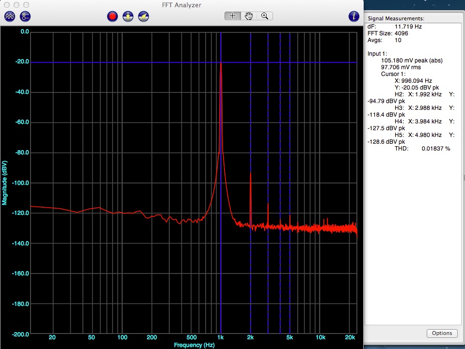

Still only one channel of my try to use the Sony fronted and two IXYS to form an amp a bit similar to Nelson XA25. I will make the second channel tomorrow.
First thanks Mr. Pass for this everlasting inspiration, riddles and hints you give us for our entertainment!
Yesterday I measured the fairly well but dark sounding amp and .....
ugly 5% distortion what a disappointment and the knowledge that even 5% distortion with heavy k2 sound not too bad to my ears......
O.K. a fault in the frontend, biasing system or output stage? Isolating the failure made clear that my single ended fronted made at 4V around 0.012% distortion itself, of course k2 dominant.
And the output stage alone, thanks Mr. Pass again for the lecture at BAF2016, therefore I was encouraged to measure the output stage alone and here the guilty was....
5% distortion. One day later I found the reason.....
bad eyes.... the 220R gatestopper at the pucks were 221k!
Corrected and the world is full of sunshine....the output stage adds nearly nothing...
Again I used the old APT20M19jVR part and the IXT170P10T.
I think the IXFN170N10 could be a good complement. But helas already difficult to get.

and here the distortion at the moment fronted and output stage, 1W with 8R.
Not Nelsons values but a starting point.
Tomorrow I will look for the phase of k2.
