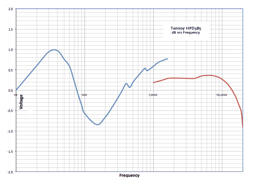

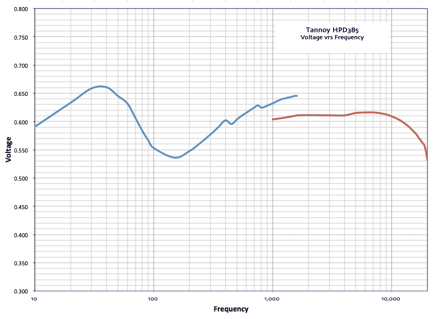

How do i convert voltage to dB?

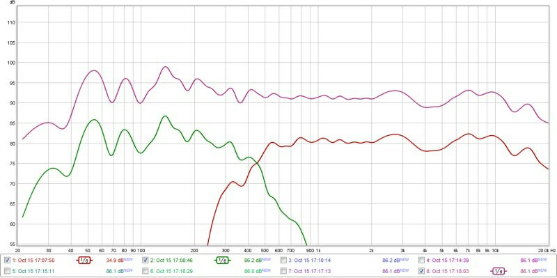

Here is the result, bigish dip in the 3500 to 500hz area.
This measurement was inside so bass is a bit over the place.
The ripple of the low frequency driver seems notable. It reminds me of the ripple that occurs with an unstuffed transmission line for the octaves immediately above the 1/4 wave length tuning frequency. I have never seen a room do this to a speaker. I have seen this when you attach a driver to a long PVC pipe.
Yea the bass is a bit wobbly but those are room nodes as the measurements were taken inside. The dip that concerns me is the top of the mid drivers range which when summed makes the dip from 3500 to 5000hz. (Not 3500-500 as first mentioned.)
Trouble the natural roll off of these drivers is virtually identical to the cross over, the crossover really only appears to provide protection.
Is there a scaling factor missing? Normakized to the 1st measurement at 10Hz.

As far as I know dB is just a way (logarithmically) to show the relation between an input and an output. Then it has been defined the way it is so 6 or 3 dB is x2 depending on if it is voltage or watt. Then the curve is compressed compared to just showing the linear relation.
I tried inverting one of the drivers but that just made things worse... I was thinking that your new xover might be able to provide compensation for the early drop off on the mid range as shown in the individual plots.
Or...... should I not worry about this dip? Just that I thought a fair bit of music detail would be contained in this 3500-5000hz range.
