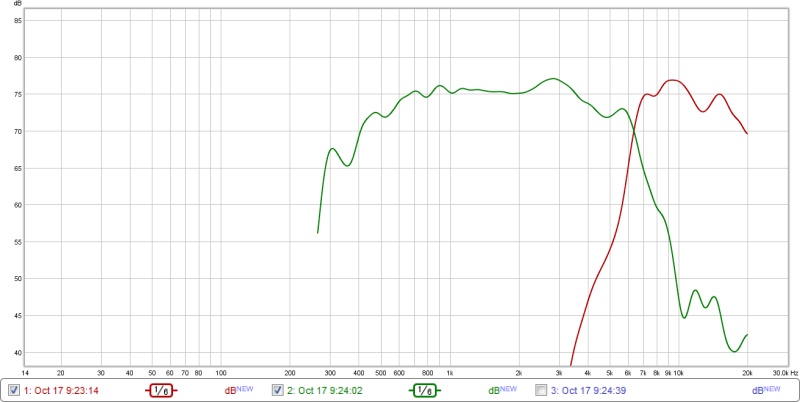

Nelson, do you think the new active xover will have suitable adjustment to level out the dip in the mid range respose of the attached plot?
I currently use a shelf filter in minidsp to drop the FR below 4khz.
I'm sure your active xover will be a lot better than minidsp....
Many thanks, Dave
