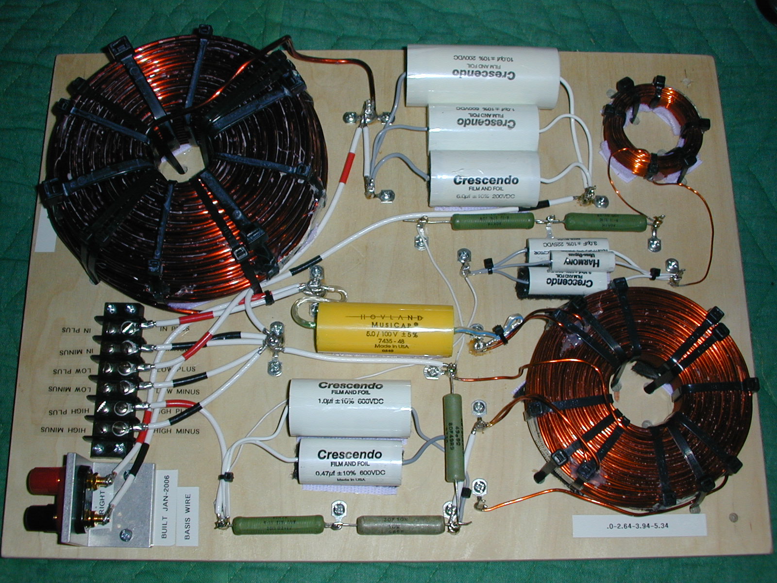

Hi Mr. Nelson, Hi all,
I'm thinking of biamplifying my Tannoy Cheviot Loudspeakers, equipped with Dual Concentric HPD315 (12" Woofer with Xover frequency around 1000Hz and concentric compression driver for the HF).
I look forward the B4 Kit to disconnect the actual passive crossover and go with active bi-amplification.
In your opinion is a viable solution?
Lu
Lu
Thanks ZenMod.
My current passive xover has a notch filter (3.3.uF + .7mH + 10R).
I thought I would keep it passive.I hope not to say nonsense.
Apologize, but I did not understand why you think the boost is essential.
Could you explain me better ?
Lu

@ascaso
there is one series cell , made of cap and resistor in parallel
that's for linear boost of voltage , 6db/oct , because all compression drivers are declining in SPL with frequency , starting from frequency in strict corelation with diameter of dome, practically VC dia
I believe that corelation was established by Ray Newman , of JBL
If you can post a curve of the voltage appearing across the drivers vs
frequency for the speaker, then I can come up with an opinion as to
whether the crossovers designed so far can do it.
If not, it might suggest another new design.
@Mr. Nelson @Zen Mod
Many thanks for the interest,
I apologize but for now I can't post that measures.
If I understood well, Mr Nelson Speaker are the HPD385 (15" woofer) the mine are HPD315 (12" woofer).
I'm not sure that the HF Drivers are the same both for 315 and for 385.
Anyway the xover regarding the HF seem to be very close or equal on both HPDs.
Here are both the xover.
Thanks alot another time !
Lu
tannoy
tannoy
Lu
tannoy
tannoy
