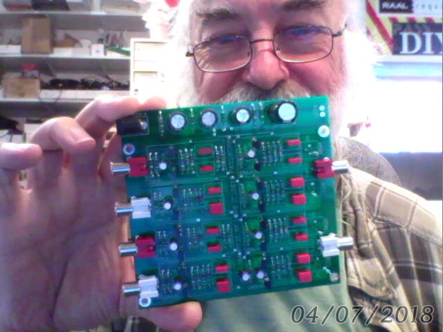

Is this the same board that will come to the diyAudio store?
What are the dimensions?
I would be interested in the board dimensions (numbers), not just photos. Could anyone in the know please post these?
There was mention of it fitting in a 2U 230mm wide galaxy enclosure.

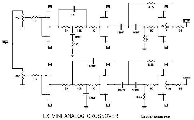

Is the third JFET stage in the B4 really necessary? (Marked with red ovals in the attached picture snipped from the B4 manual)? Came to think about that after staring at the LXmini analogue filter at S.L.'s page.

probably not in bypass mode, but I would leave it there to separate two filters

In either position of the bypass switch it's just buffering a buffer. Not really necessary, but not doing any harm either.

Actually, I think the diagram is in error.
