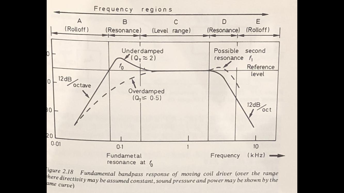

I believe Nelson Pass' post #370 dealt with this. The figure shows the tweeter 12 dB roll off and woofer 12 dB roll off, as HP and LP filters respectively.This is only the electric side of the crossover. In the real world, you need to use the acoustic respsonses of the drivers and adjust to suit.
To this the second order crossover network is shown. A simulation will show the response not to be flat when summing. I believe NP encouraged us to play with this.
You can explore the concept with a simulator, where the simplest model
of the output of a cone speaker has 12 dB/oct acoustic rolloff.
Try adjusting this simulation for a flat sum at woofer+tweeter nodes.
From Martin Colloms’ book “High performance loudspeakers” fourth edition. I guess I would like to locate my crossover frequency somewhere in the “C” range not using the natural roll off as part of the crossover. I also mean that if you stretch the woofers response up to the “C” it will become much more directive than the tweeter taking over. I am sure this gives abruptly off axis behavior.
Hard to avoid, since the phase variation of the driver extends well into
the C region.

Those drivers! The phase! All that, perfection is impossible, but one can have different permutations of imperfection, I guess.
