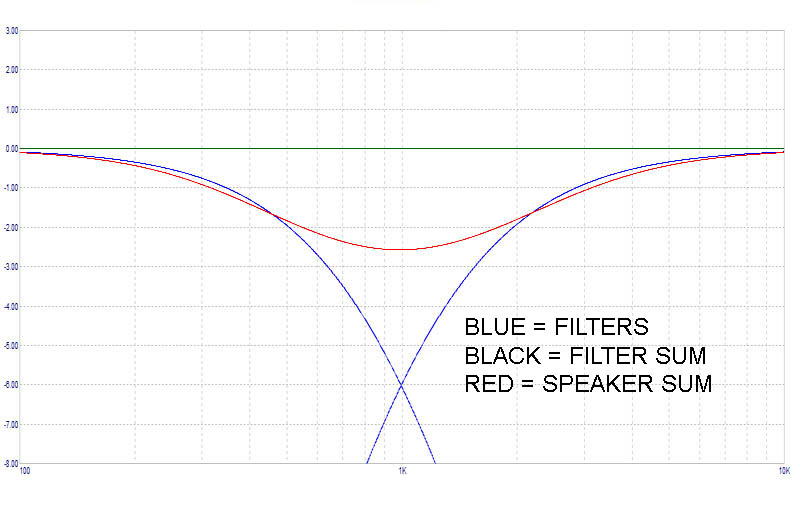

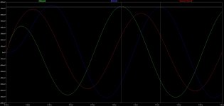

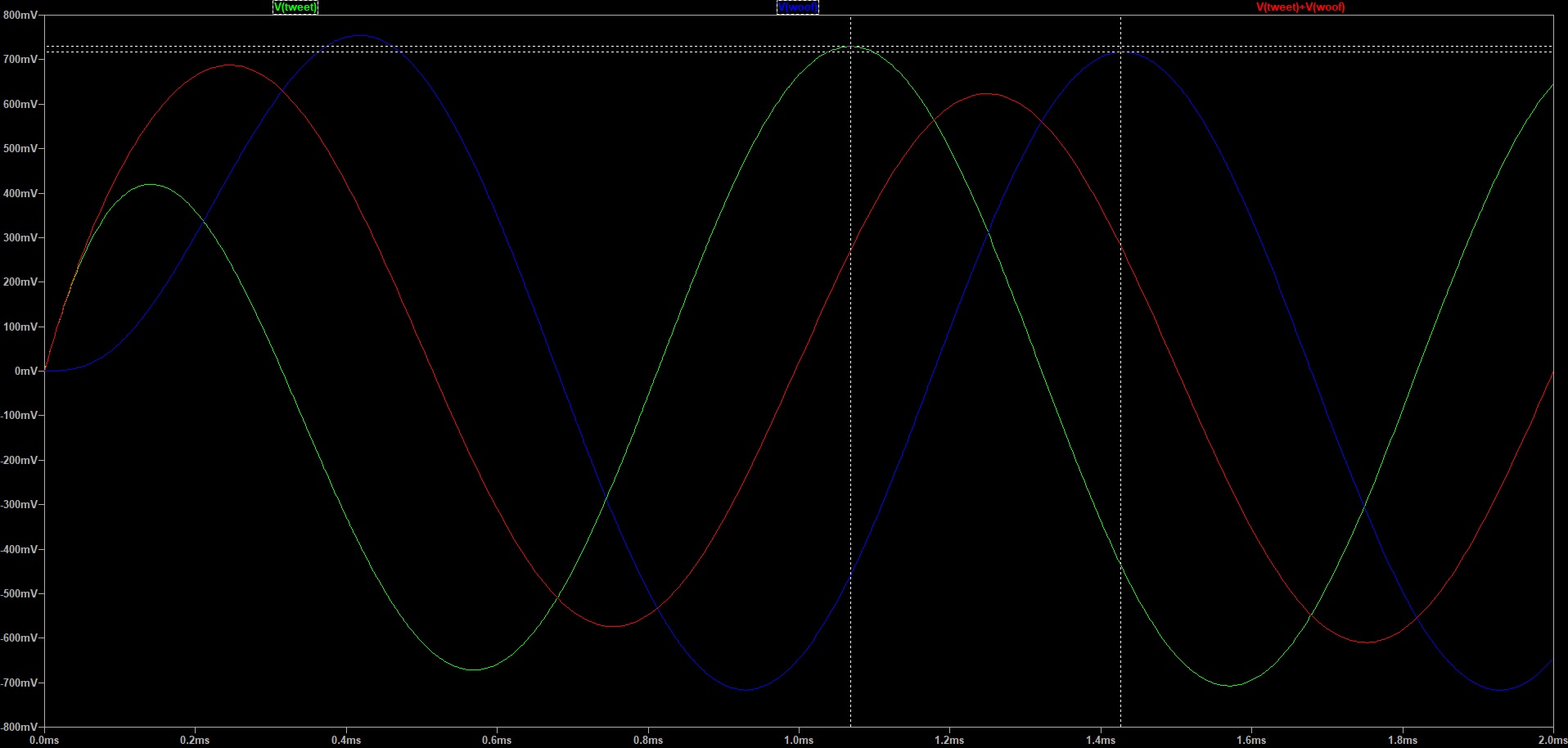

This is the situation at 1 kHz. The woofer is lagging the tweeter by some ~380 us. The crossover should [somehow] compensate for this situation.
Ref to Post 370 again.
The crossover is intended to make summed response at the crossover point flat.
The phase response of the woofer with respect to the tweeter is a different matter. That the woofer lags the tweeter is not surprising .
Of course.
As mentioned earlier the sum gives a 4 dB notch at 1 kHz. NP encouraged us to find a set of values for the crossover shown in post 370 to flatten that. The numbers I mentioned is part of the facts one has to work with. Maybe I stated the obvious, but it was to get to a better second order filter.

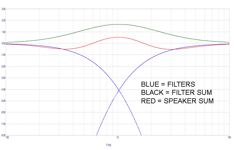

Here's a cheap example, a 2 pole pair of filters which sum flat at 1 KHz
but paired with drivers that roll off at 500 Hz (tweeter) and 2 KHz
(woofer).
If we play with the values a bit, we improve it to about +/- .5 dB.
You can probably do better than that, this took me a minute.
