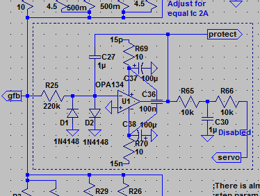

Made a PSU unit with 2SA1930/2SC5171 TOSHIBA VAS grade BJTs. PMOS IRF9610 NMOS IRF610. 10uF caps = Nippon KMQ 100V 105C. 100uF caps = Nippon KY 25V 105C. Vin-Vout for reaching 140mA CCS (load demand will be 70mA per rail) = 7V. Rise above ambient on sink behind the power semis = 26C (48C with 22C room temp). Drift = -90mV over settling time = 20 minutes. No parasitic oscillations whatsoever. I.e. this PSU build is stable on its own before connected to its target load.
Notes: 1. Preparing and aligning the sink is a royal PITA.😀 2. Its sinking capacity is borderline. I would stay +6V to +7V Vin at most. I.e. 2X18VAC should do.
3. Is there statistical info about using the several 1uF film caps on the phono rails or not when oscillations happened?
4. Use short path to ground when probing for oscillations.

First of all, I’m very happy that the PSU works as intended 🙂
About the notes:
1: Yes it’s known 🙂 (Sorry for that) but they look great.
2: Yes, again it’s know 🙂 but the advised transformer voltage (with no pre-PSU that includes damping is, as you note) 18Vac, giving 24 to 25Vdc on the PSU.
3: That may be a point where we need to improve the design a bit, it would be better, in hindsight, to add a few 10 Ohm resistors in the opamp supply lines (as I normally do) (see attached schema partial).
4: Yes 🙂
Your experience makes me think that we have to change the specification for the power transistors. Let’s see what happens when the RIAA is connected.

Is it the alternative fast transistors that tamed it or is it something with the lytics being bypassed several times over the long phono rails introducing tank circuits that help setting it off? Just a thought.
Maybe this could be tested by not stuffing C91, C92 and C93, then (when tested) add C91 and C91, and then after testing, stuff C93. WOuld you do that?
