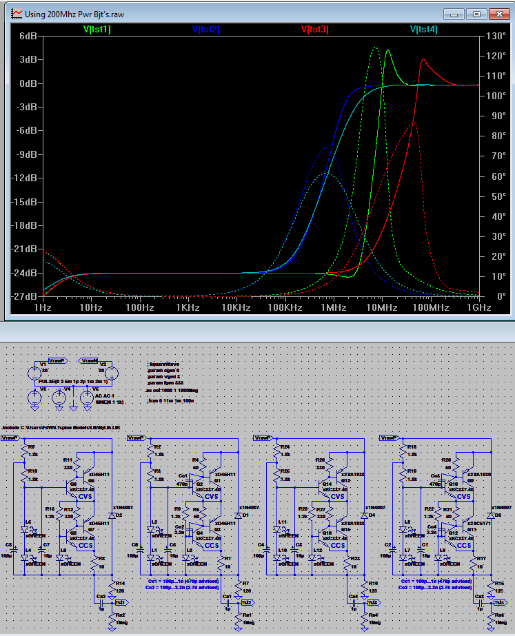

Now I needed to do the sim's, these are the results, the 2SC/SA's look really good. It looks also the compensated version (tst4) will never be able to oscillate, the phase line is near to straight (o.k. not straight but less then 60deg). Uven the un-compensated 2SA never gets to 90deg.

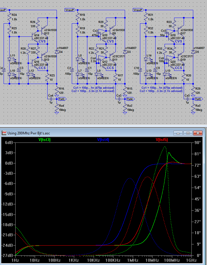

And here with a 3rd 2SA version that is very lightly compensate, phase max at 63deg (very good) 🙂

What is the output impedance sim of the total reg for 70mA spare above load?
With a load of 50mA(dc) and 50mA(acpp) sinusoidal load variance (eg a load sinus of mA to 25mA(low) to 75mA(high)) the simulator gives a 31uVpp ripple. That should be equivalent to (in my reckoning) 31upp/50mpp = 620uOhm. But this is for a very unrealistic load (really worst case 🙂). If this is what you wanted to know 🙂
Energize the main voltage source for ACampl=1, also the load sink. Run an AC sweep on the output with the probe off .params prb=0 go click to the chart's left side and ask for logarithmic. What you see complies to Ohm scale too now. That way you can see what it does across wide band.
Also I do not think this is realistic, in real life, the PCB (layout and track resistances) is not modeled in there. SO this is why I never posted sim results like that 🙂
Jack had run the 1.1 on AP2 once and it was bang on to the sim and actually a bit better than the model for supersonic. It can be near if you will model the lines inductance and their resistance. Still 0.62mOhm strikes me as a bit optimistic for the limited Gfs a 9610/610 can have when shunting 50mA. Even on optimal local node.
