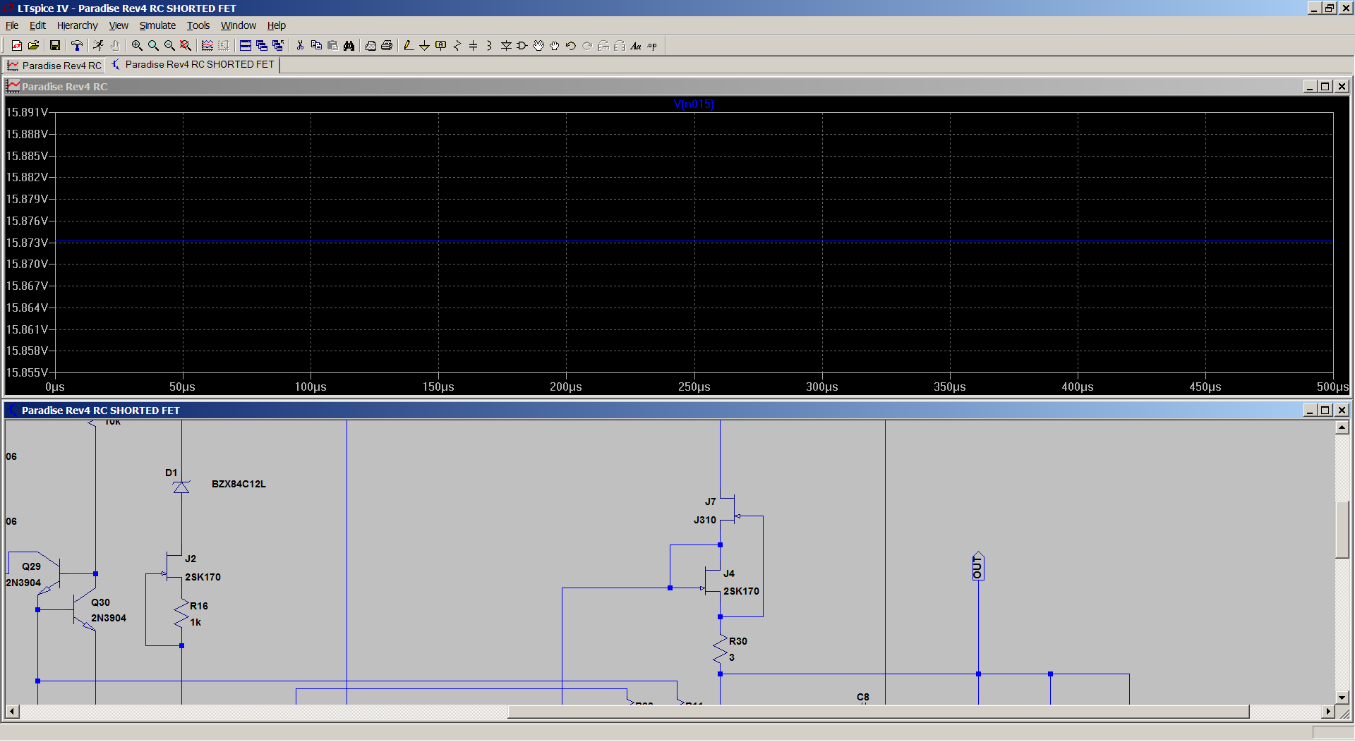

OK! Got the babys here on spot now.
Checked the servo output again. -It is not 18V; it is +15,57V!
The voltages at R5 are -0,575V and +0,615V.
(At the "good channel they are -0,62 and + 0,563V.)
The voltages at R5 look OK, considering the servo output voltage. I would imagine the output voltage of the amplifier is negative, correct? (Sorry I forgot). Could you please measure the voltage at the "Ext RIAA" connector?

Output Voltage is +15,57V and RIAA is 15,8V.
Servo Voltage (Pin6 OPA) is -18Volt!
hi Gandralf, something is going VERY wrong here. Looks like the servo is doing his job, though, and the problem is somewhere else. I suspect the current mirror around Q6-Q9, you may want to check if all those transistors are correct and working. The voltages on test points TP9 and TP10 should be as indicated in the assembly guide (-16.5V); if they are stuck at -18V then no current is flowing in that mirror.
Let me know if you can find the problem, alternatively send the boards to me (but within this week, please - have to travel end of next week.....)
I had a similar experience once and found a shorted fet on the output buffer.
Please check the two top fets on the output buffer.
yes, it could be the output buffer. according to these values, the current mirror is biased correctly. Something is pulling down the voltage at the connection of the mirrors.
Is there a voltage difference between "Ext RIAA" and the output?
... oops, just saw you already posted that value - yes it looks like Q99 has a problem.....
