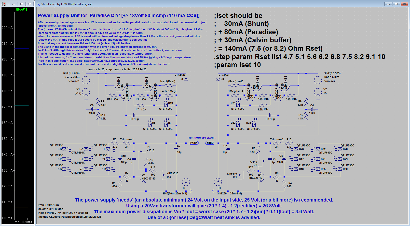

About the Paradise PSU when using Calvin buffers
When using Calvin buffers in combination with the Paradise RIAA the preamp is going to need a bit more power than originally planned. The Paradise RIAA needs about 80mA and the Calvin buffer needs an additional 30mA.
For the shunt to function it needs to consume a few mA’s (30mA is the design value, actual values from 25 up to 50mA are acceptable). This results in 30ma x 18V = 540mW and 110mA x 8V = 880mW constant power consumption in the voltage regulator (Shunt, CVS and CCS), the total power supply consumption is:
2 x ((30mA 18V) + (110mA 8V (26Vin – 18Vout))) = 2.8Watt
When connecting the Calvin buffer an additional 30mA needs to be supplied, the CCS setting needs to be changed from 110mA to 140mA, this can be done by changing the 10 Ohm resistors to 7.5 Ohm resistors. See the attached JPG (The attached screen shows the CCS current in the PSU for (E24) resistors from 4.7 to 10 Ohm (currents from 240…105mA (give or take a few mA’s)).
The ‘normal’ power supply dissipation now changes to:
2 x ((30mA 18V) + (140mA 8V (26Vin – 18Vout))) = 3.4Watt
This should not be a problem with the supplied heat sink, but care should be taken to ventilate the area surrounding the PSU heat sink.
When testing the PSU (with the RIAA and buffer disconnected) the total power consumption in the PSU will be 140mA x 26V = 7.3Watt. If the PSU is not placed in a closed box this should not be a problem, the heat sink may get hot (up to 70C or so) and should not be touched (but you will know 🙂 (as a regular soldering iron user)).
As ever, be sure that the final enclosure is well ventilated (especially around the PSU).

Frans: do you really need 30mA EXTRA? since the original output-stage is removed and the calvin does need 30mA - shouldn't it really be 30mA minus the original ops-usage? and then the next question is: how many mA did the original stage use approx?
To be on the save side, you could go and measure, then add 30mA for the shunt and 'there you go!' 🙂. I do not think that you are going to use any thing other then the 'predicted' 7.5 Ohm current-setting-resistor (but I could be wrong (I have been known to be wrong) but not by a mile (or country mile)) (Better first check these calculations 🙂).
It used 6mA, so the delta really is 24mA. Frans and myself had a good conversation around this topic, and the value Frans is suggesting is absolutely fine IMHO.
It kinda becomes a topic of taste - people say that the shunt should absorb as much current as the load, to be in its "sweet spot", but I would say that the "best" shunt current really is determined by the design of the shunt, and at which bias point it operates best. This shunt (especially with the powerful MOSFETs) is probably happier on the slightly higher current side of life 😀
