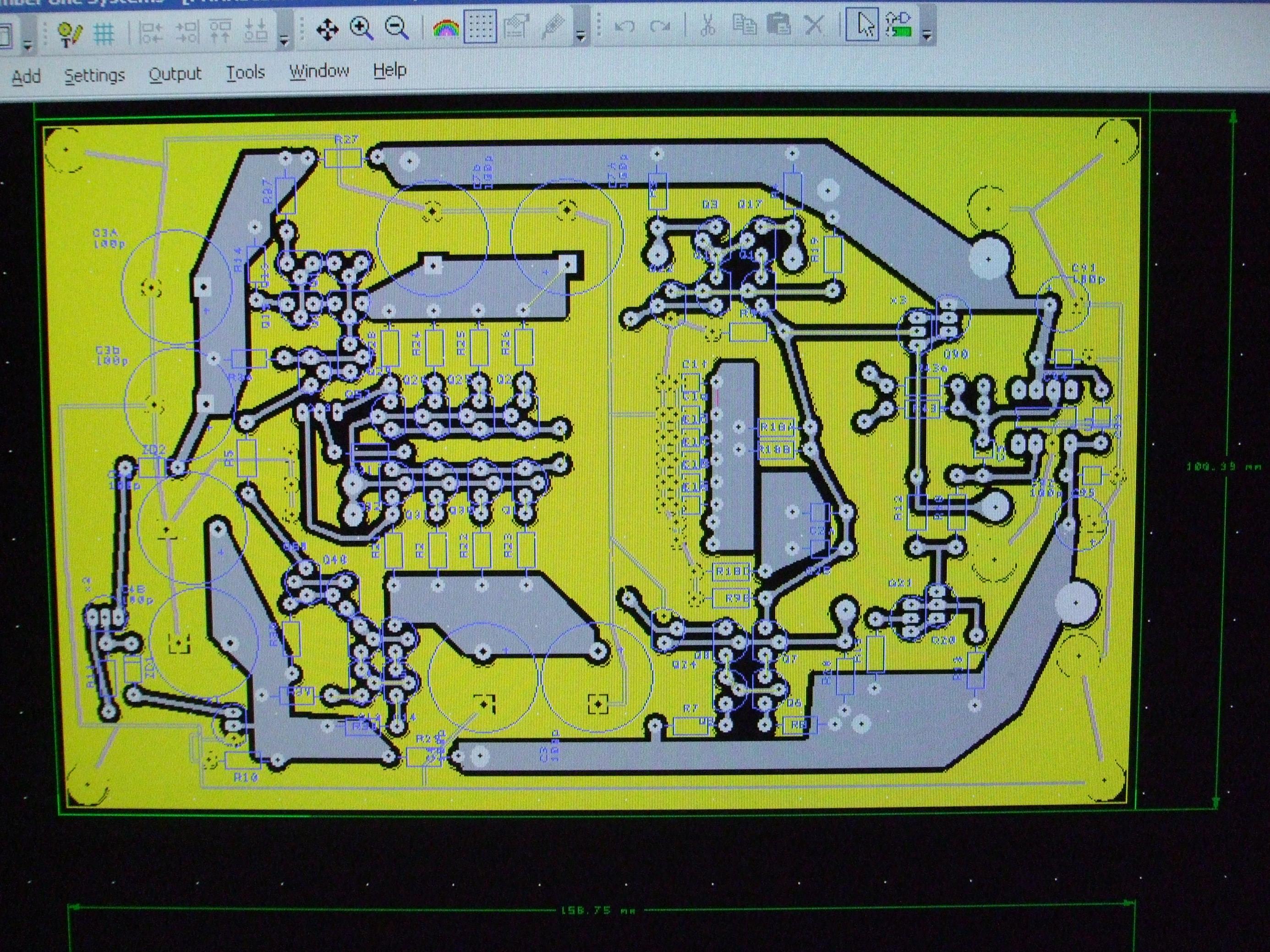

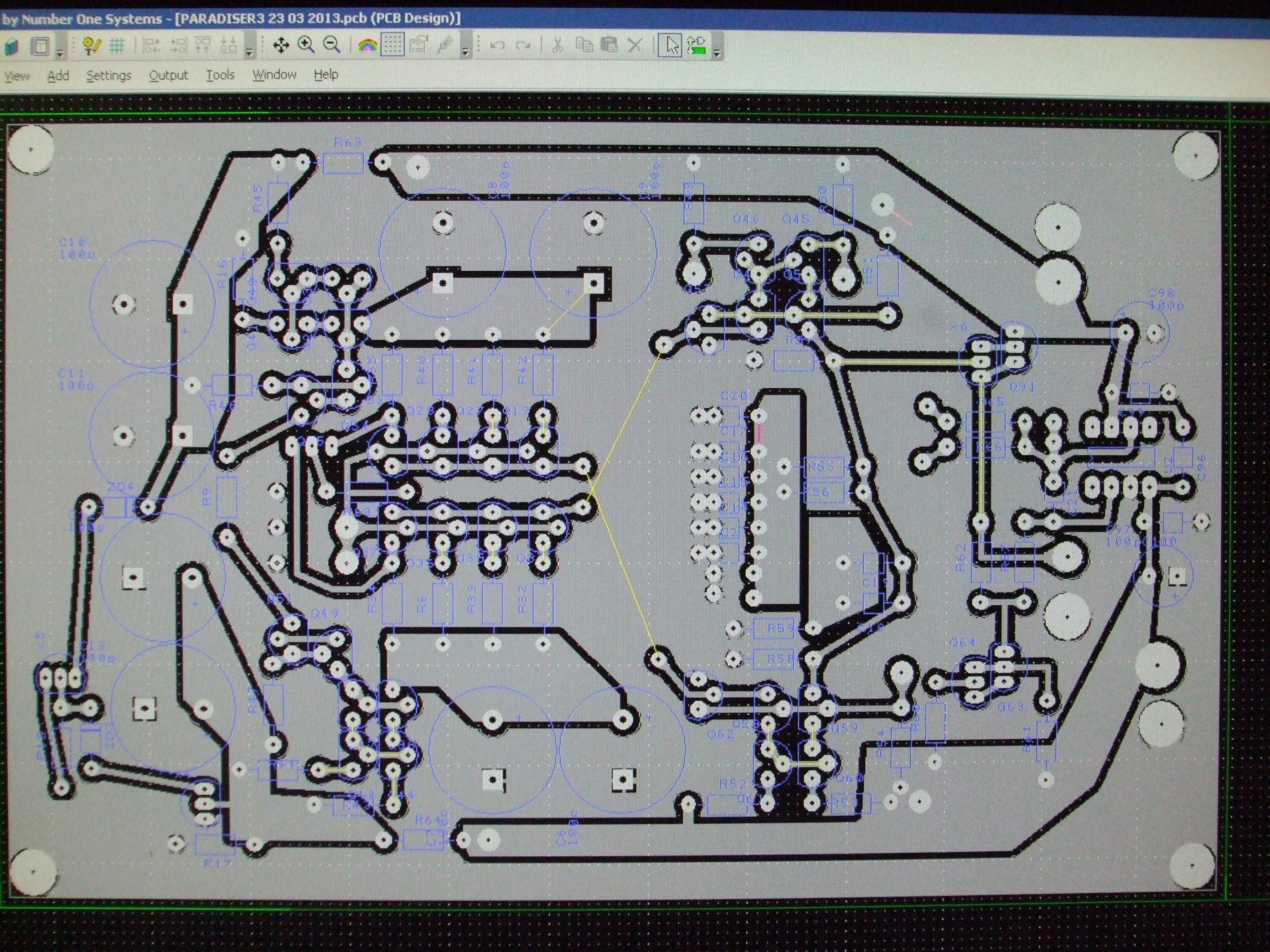

I went so far as etching the boards then house move so not even unpaked Fifi
But if some one want to take this up I can send the Gerbers (Whit Circuit owner permission)

Paradise circuit what else ?
See group of 4 transistors for thermal and shorth signal tracks.
Is single layer so same compromises whit a few external jumpers (2 yelow wires)
Yelow board has original components names
looks good! would be interesting to build and find out if it performs any different. The input stage looks very nice and compact.
There is quite a bit of space left on board especially around the servo and a 2-chip affair like the one I published years ago on MPP tread may do the trick
But is it going to be needed when thermal coupling and separate supply with Kelvin returns may be just the ticket?
Eventually I will get around to drill those boards and from there idiot proofing and tidy up winter is coming so one will stop pottering around the garden soon
As I said If any one want to take this up ...
;)picture of the boards was around here a few months ago
