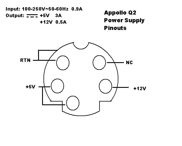

Appollo Q2 Power Pinouts
Hope this helps on your Q2 Power Issues. The Q2 really does present a descent picture. I know everyone is in love with all these DIY Projectors (Awesome results) I just love the simplicity of these Projection Panels. I've owned and sold all kinds for the Last two years. The QA-2500 is still my favorite.
If anyone needs the Appollo Pinout schem - Let me know.

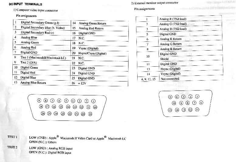

I used the pinout from page 5 of this thread that is supposed to be for sharp panels (image below). I think that using a regular cable is a great idea, just didn't want to ruin a good cable. (kinda silly since I live around the corner from a thrift store and can get them for $2) If I get a decent panel and it needs a cable then you're the first one I'd get ahold of, but this thing is passive matrix and low color so not going to do much. It has a really cool fan though that Im going to rob for my diy setup.
thanks again
thanks again
