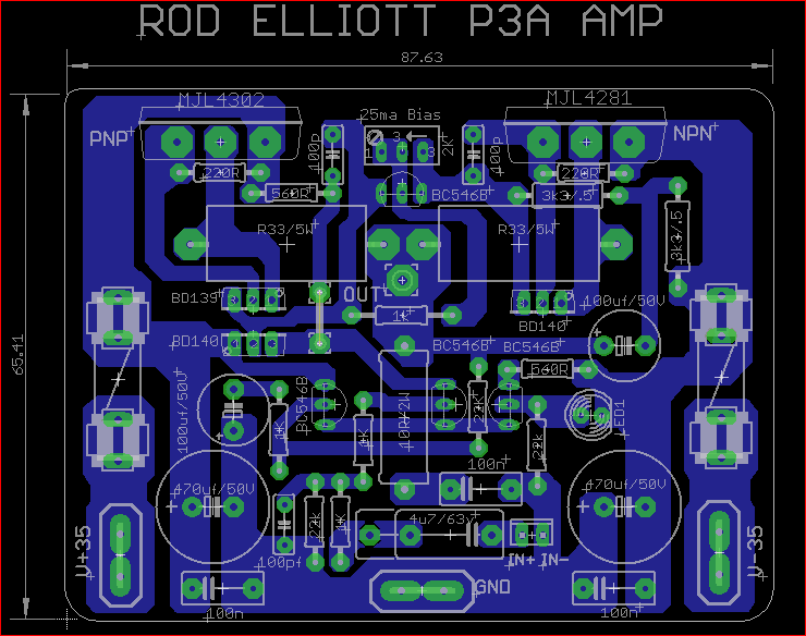

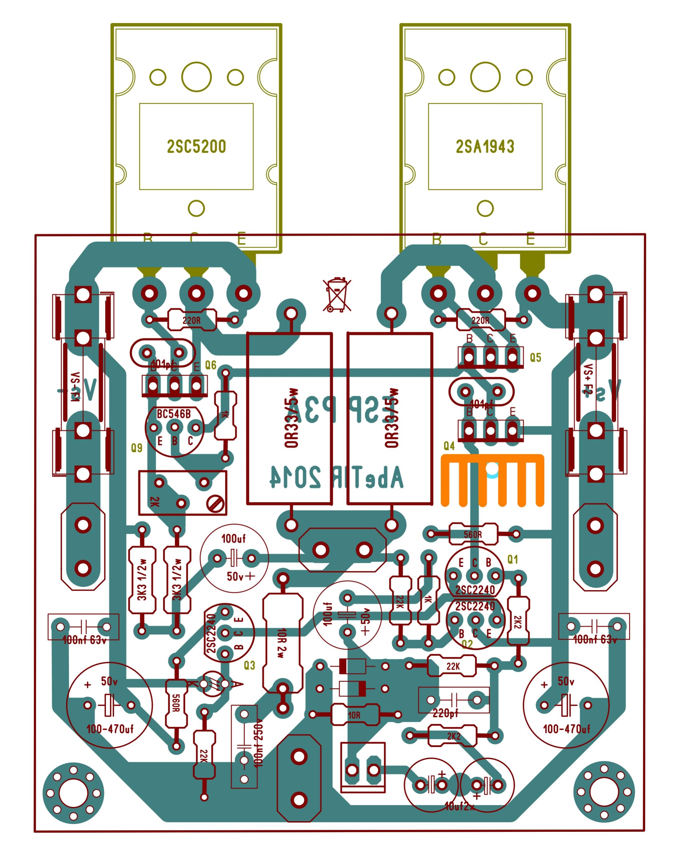

Hello,
I just built p3a with abetir pcb layout.
Feeding with bipolar 28vdc.
Powered up with dbt. Few seconds after 560ohm resistor smoked.. Small signal transistors bc546, drivers bc139&140 outputs a1492&c3856.
Any idea anyone?
ps: 2240 > 546 pinouts are arranged already. No diodes installed yet, including led..
Sorry you are having a problem but its not a complex design and possible faults aren't particularly hard to diagnose. Let's think about the DBT first.
If you used a dim bulb tester, it would need to be fitted in the mains supply before the power supply and probably no more than about 40W bulb rating to protect anything. Does the bulb glow or flicker at all when you power up? If not, it can't be protecting your amp. and for the type of failure you have, it may not be helping. What sort of power supply are you using? Is it intended for permanent use with the amplifier or is it a dual bench supply that is suitable for high currents?
The only 560R resistor I can read on the layout diagram, is a dropping resistor between the -ve power rail and current source transistor Q3. This is in the input stage which should operate at very low (only 1-2 mA or so) current. If this stage draws enough current to burn the resistor, you have either made a mistake fitting Q1,2,3 or perhaps one is shorted or they are not genuine 2SC2240 transistors. Remove and test for shorts before refitting or replacing them as you don't need a repeat performance.
However, as you haven't fitted the LED yet, Q3 is not regulating anything and this could be the real problem. The LED is not an indicator but it is used as a voltage reference to maintain the small current. Don't omit it.
BTW, there are now plenty of fakes and poor copies of these obsolete parts so I wouldn't buy them. KSC1845/KSC992 are still in production and are drop-in relacements but there are plenty of other low noise transistors that will work fine here including the original specified ones.
