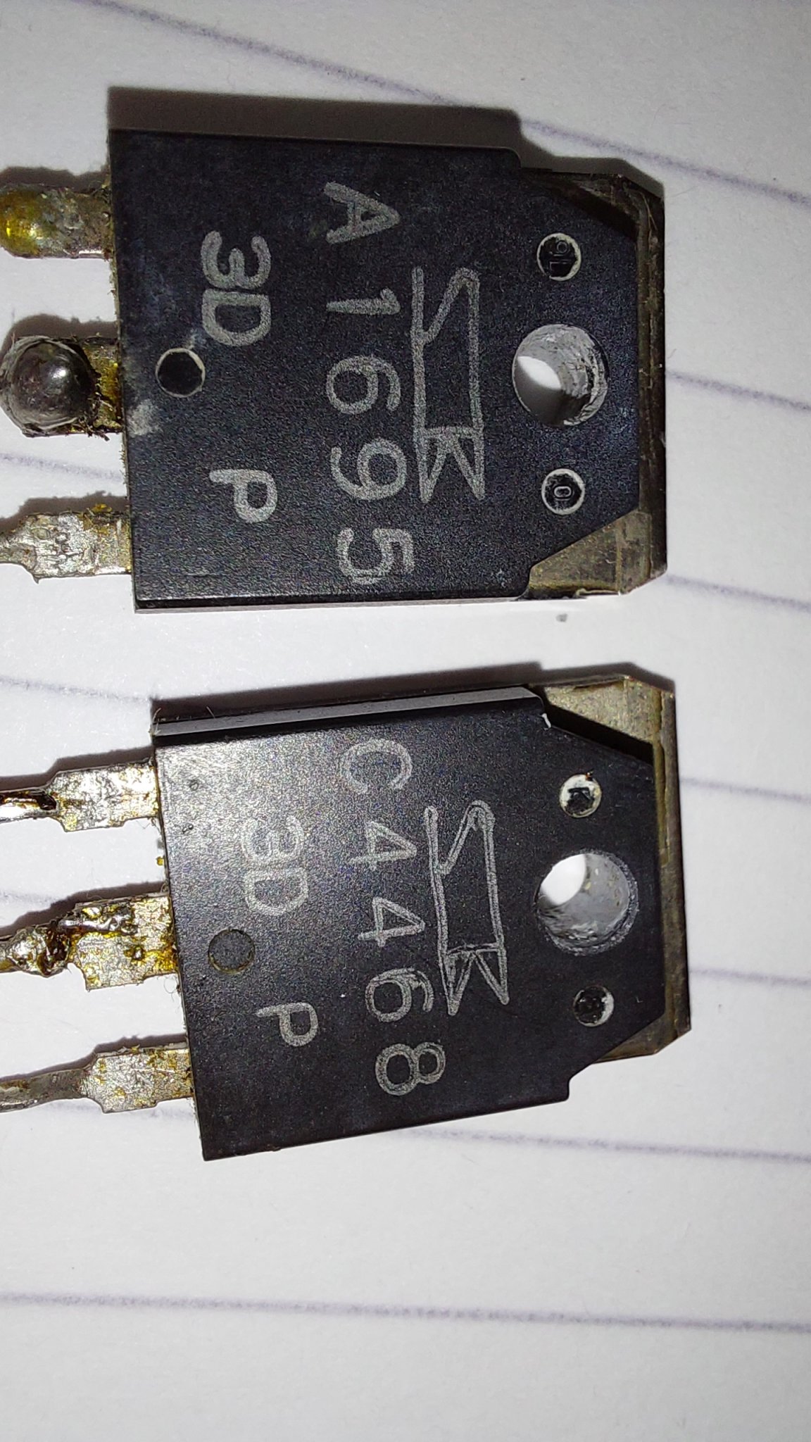

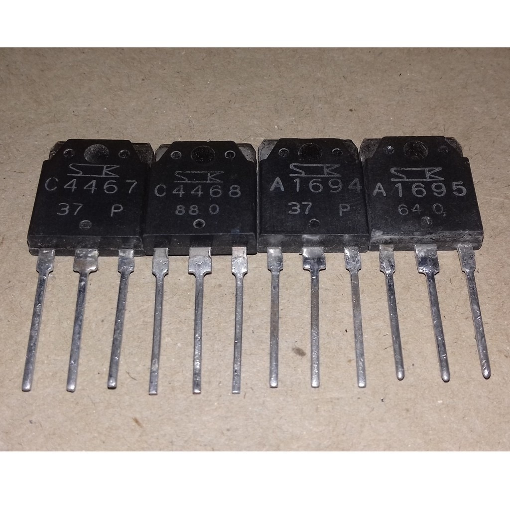

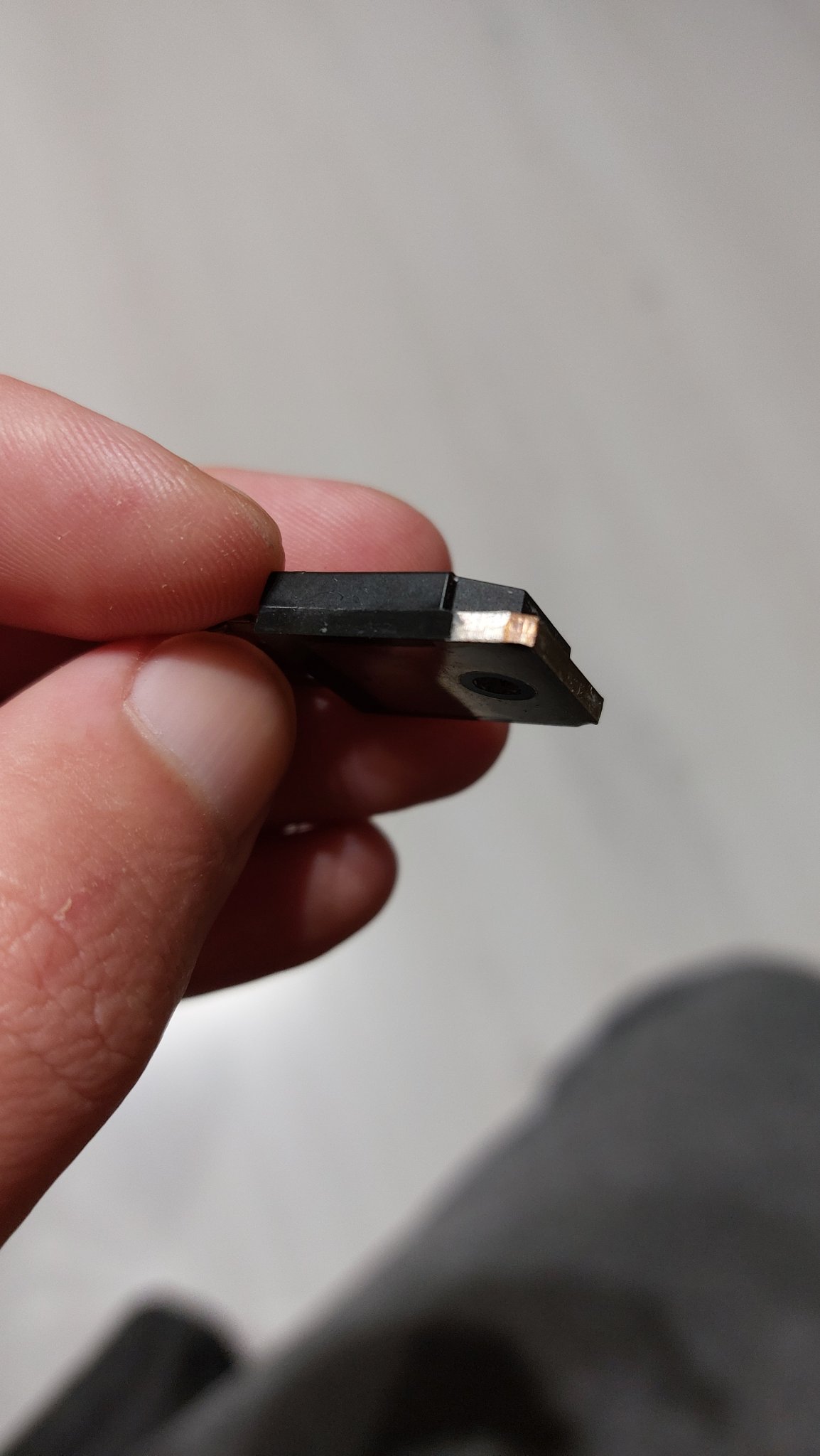

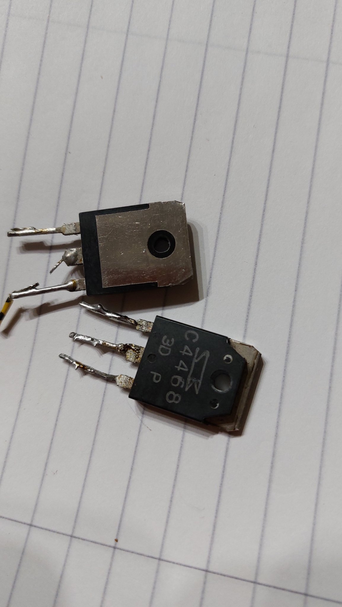

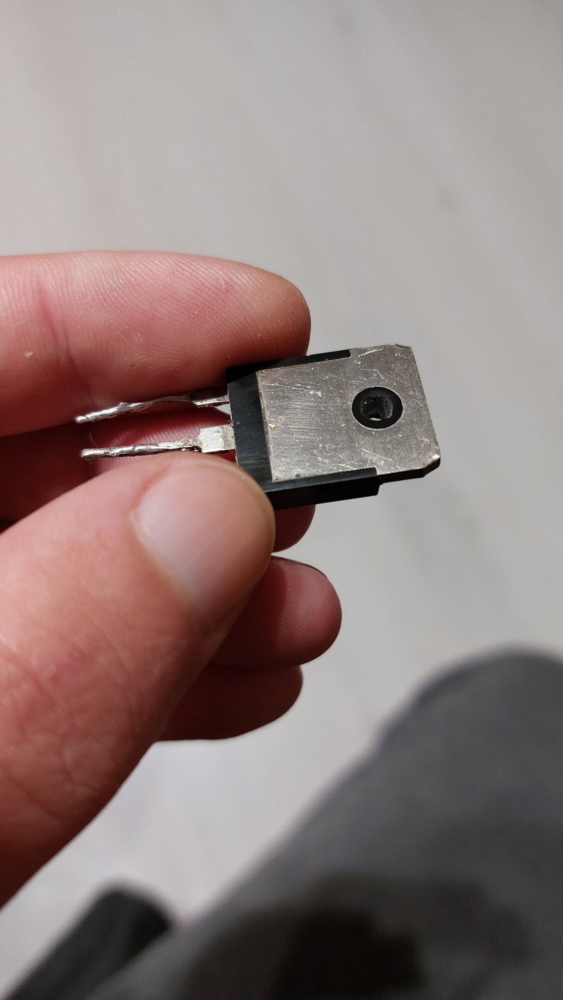

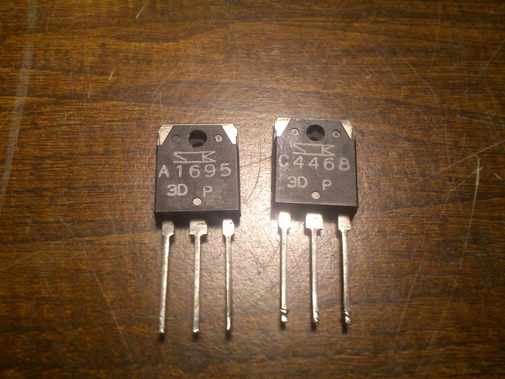

@amplidude How do they look to you? Bavk is very shiny phone camera can't really pick that up .
PS: don't mind the ulgy legs, one of them broke because gravity is a b....
Long story short it was attached to a heatsink that met the ground at some point. Me being a fool .
I have 8 of them from that amp. 4pnp 4 npn, maybe I'll use 4 per channel. Rise the voltage to +- 45.

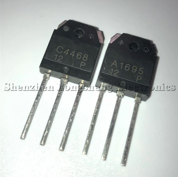

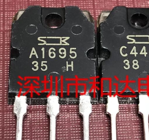

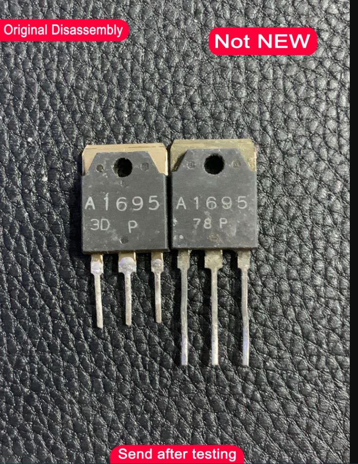

@amplidude these are from old , salvaged. first 3 photos. and the rest are from aliexperess, alibaba, other " new batch " fake probably, they look different, they have a " square " where the name is printed.
I couldn't find a cracked photo.

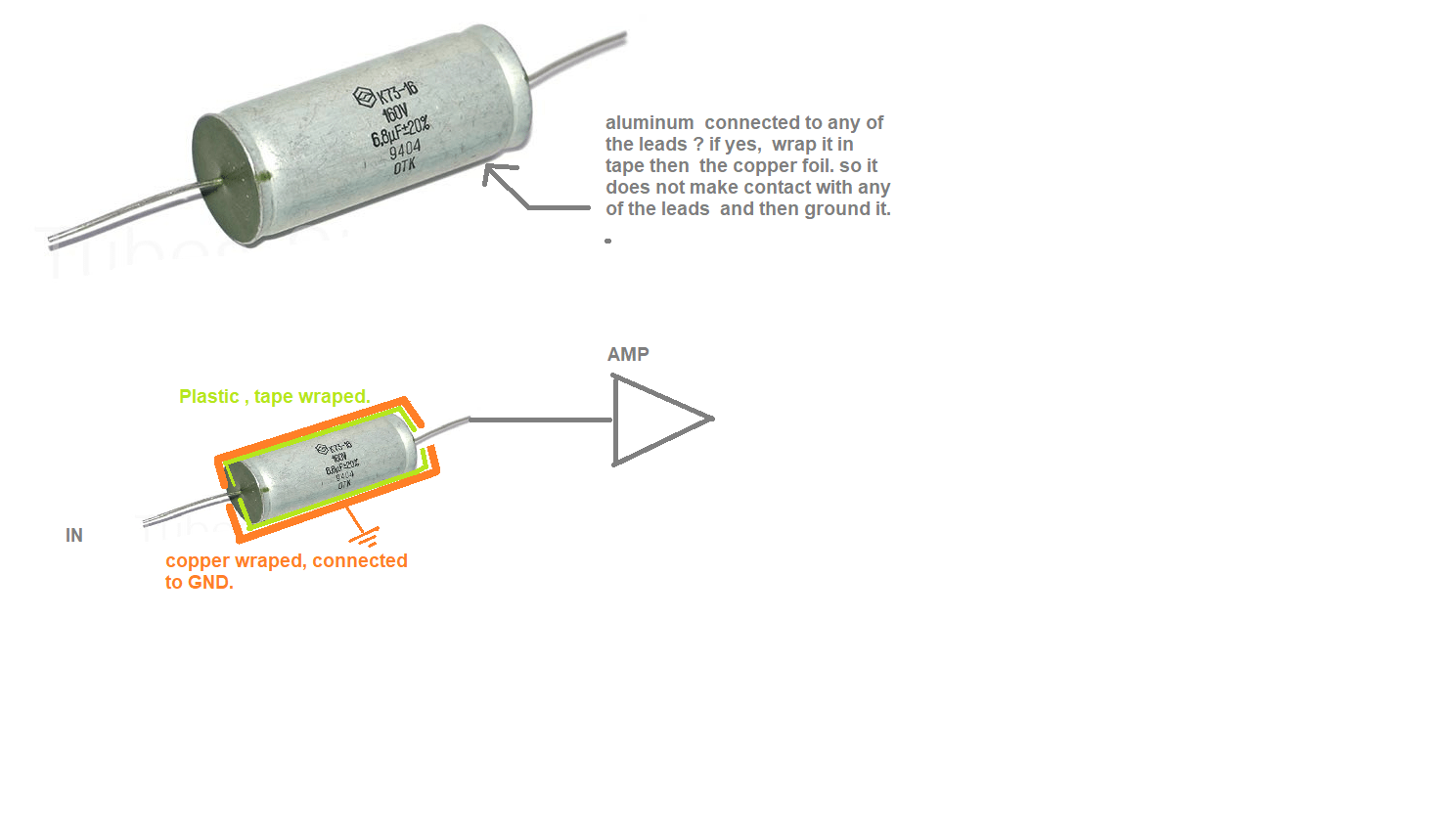

What if you wrap the whole cap in aluminium tape, ground it , and try again, does it perform the same after this, no matter if you switch the " polarity " ?
I actually today have grinded some copper foil I had laying from a old inductor, will attempt to do what you proposed and see readings.
Good, Im curious. but , I googled your cap, looks like it has aluminium around it, is it connected to any of the two wires?. Im sure it is since you said if you wire it in different " polarity " it " acts " better. " But I must say I was surprised about the 9db difference." . and if it is you can not ground it. " over 9db noise reduction, reason is that the outerlayer foil is grounded, shielding the inner turns, " .
I was thinking something like this ( picture down bellow ).
Also , english is not my native langauge, sorry for mistakes, I hope I'm getting understood.

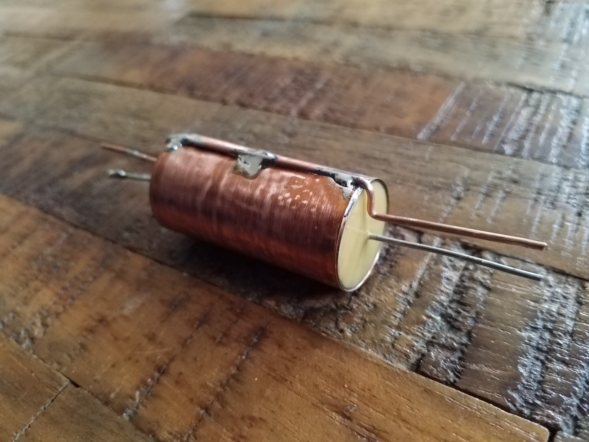

- What I was thinking, let's say a film cap that is plastic on the outside, if you wrap it in some kind of foil, aluminum , copper does not matter, and connect it to GND ( not attached to any of the cap leads ) , would you still see the improvements you saw with your capacitor connected in the " correct " way ?.
So I made this capacitor copper condom on a roederstein mkt 1813 10uf.
Without condom and outer foil connected too scilloscope gnd it picked up 10mv noise,
With this steampunk condom, oscilloscope could not pick up any signal
With lowest setting, 5mv pr division, and it did so in either direction.
I will use this in my p3a it seems logical.
Had it been a gauss band jaques would have mumified himself in foil..🙂

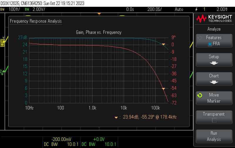

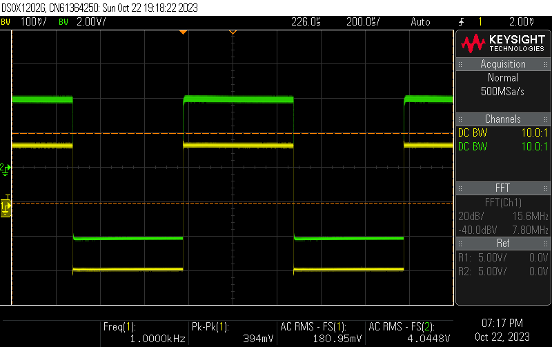

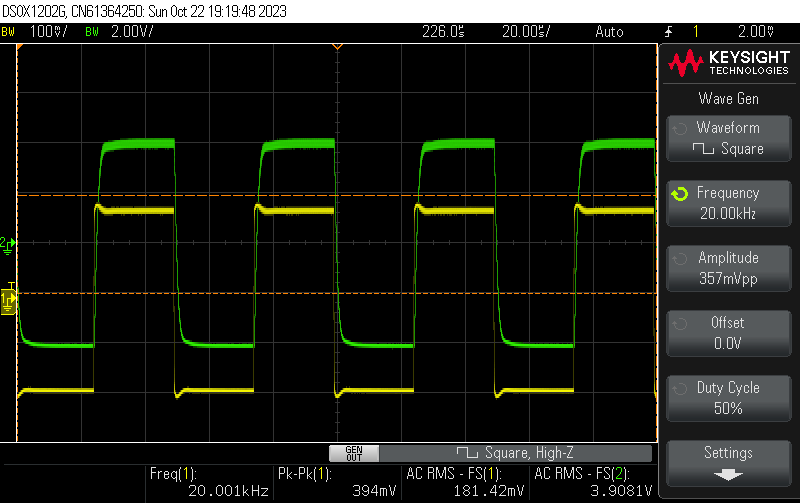

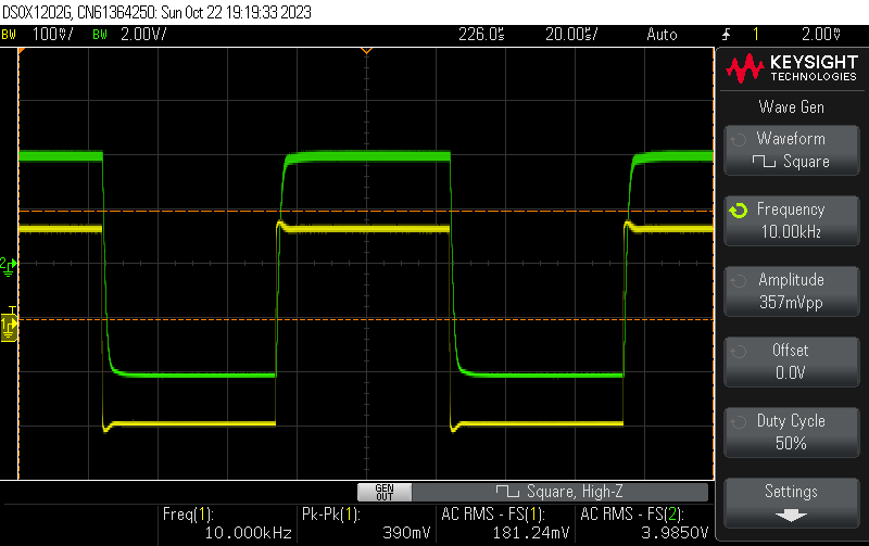

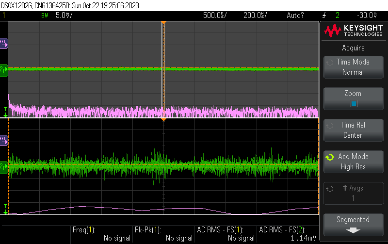

here are a few measurements, all done with 8 ohm load all 2.83 volt rms .
1, frequency response, 3db down at circa 180khz.
2. 1khz squre wave
3. 10khz square wave
4. 20khz square wave
5. amplifier noise, shorted input 8r load.
By the looks of it the generator seems to be struggling, a bit of overshoot.
Response is ruler flat from 10hz to 20k, and further.
Input capacitor is a very big dc link capacitor 200uf, just lying on table with cables crossing, doesn't seem to pick up much noise according to last photo.
ps. green trace is amp, yellow generator

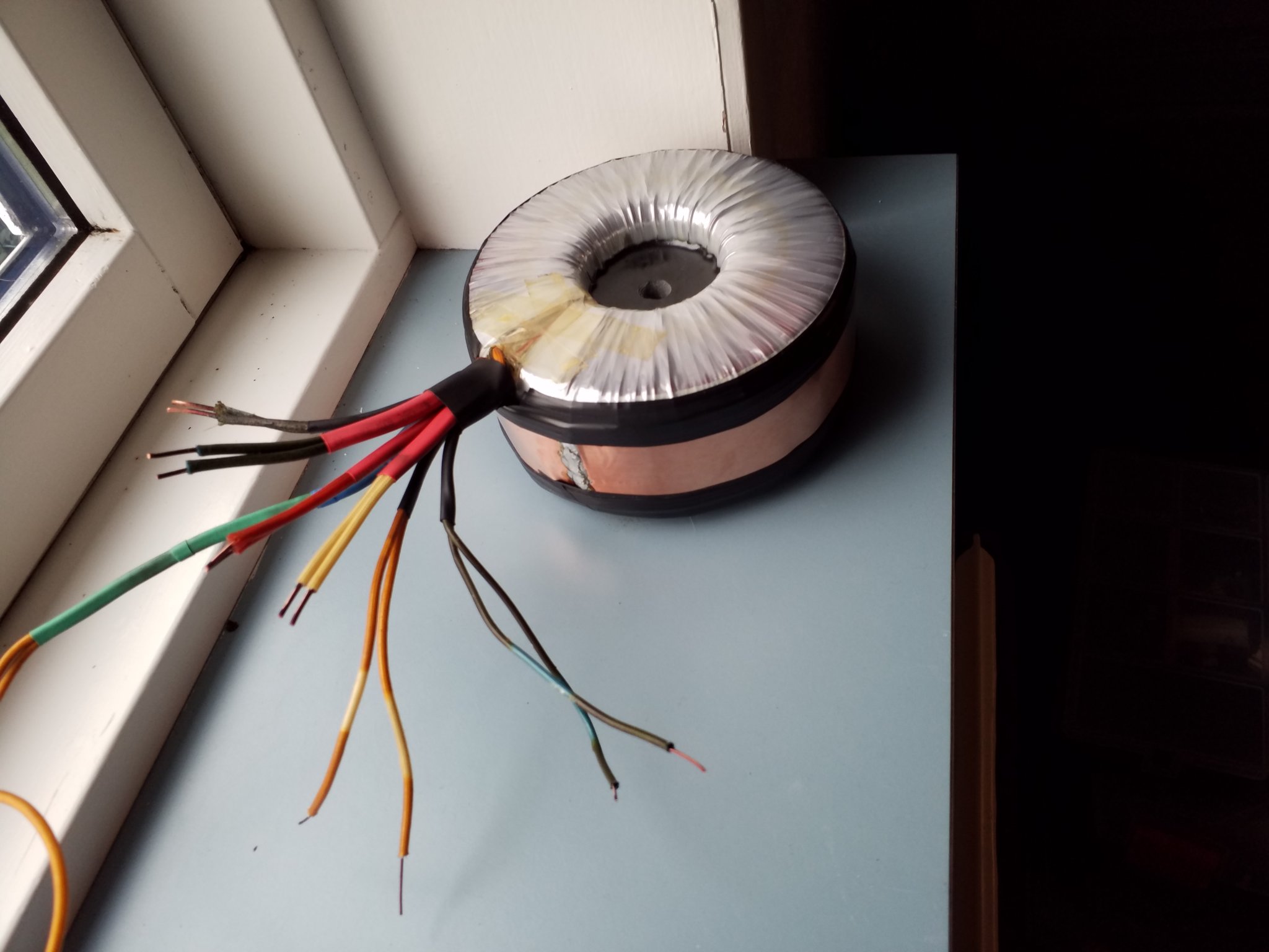

Found this nifty transformer the other day, it's perfect for my p3a, 4 single tap with 22 volts, and 2 with 17 volt for speaker protection, it was somewhat beaten up, so nursed it a bit, it got a gauss belly band, now I can do dual rectifiers for left and right, btw , it's a 500w toroid, no buzz.
