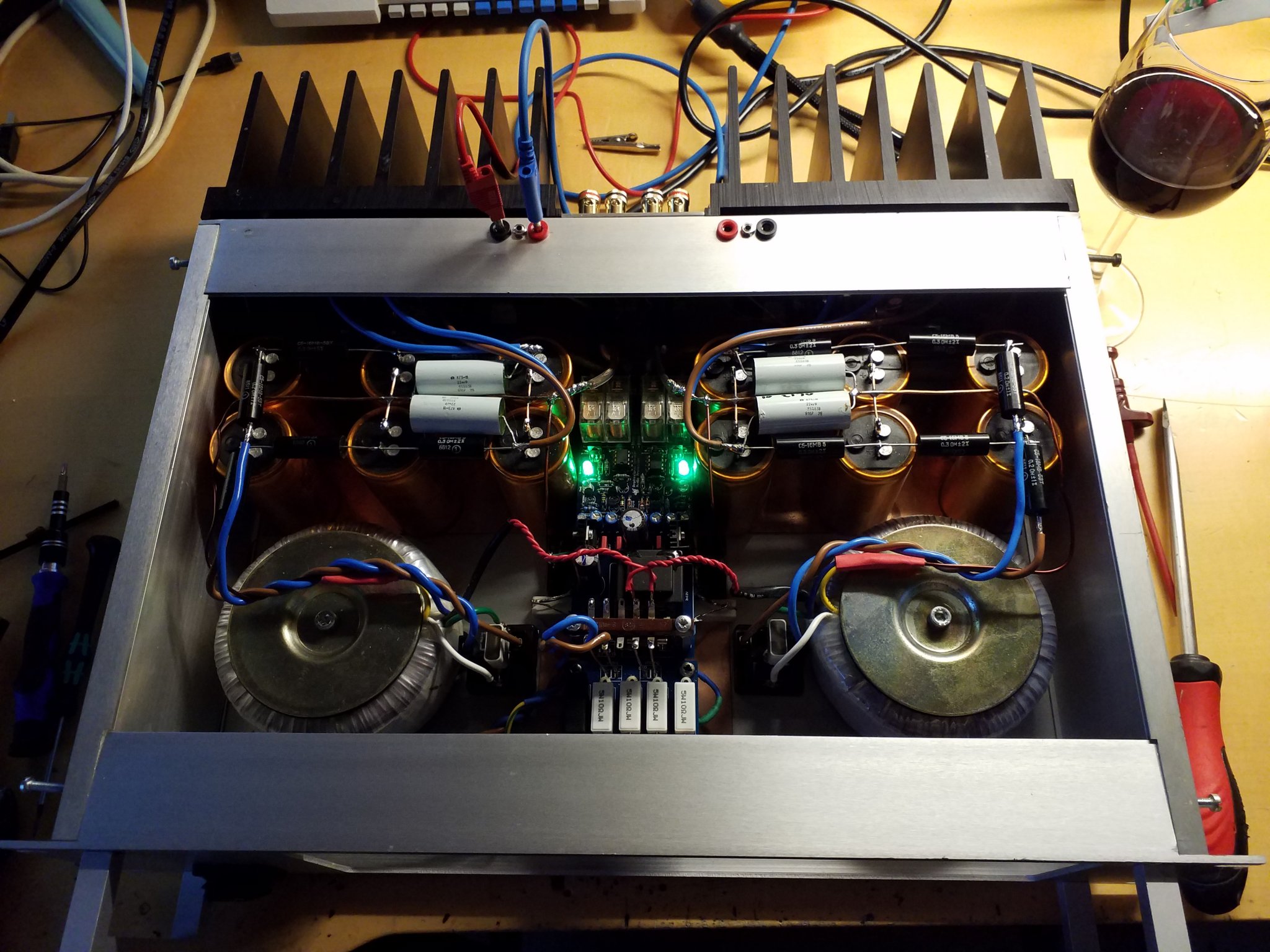

After a few hours listening, I'm very thrilled, what a great little amp, no harshness at all, seen many describe it as crystal clear, I will join this club.

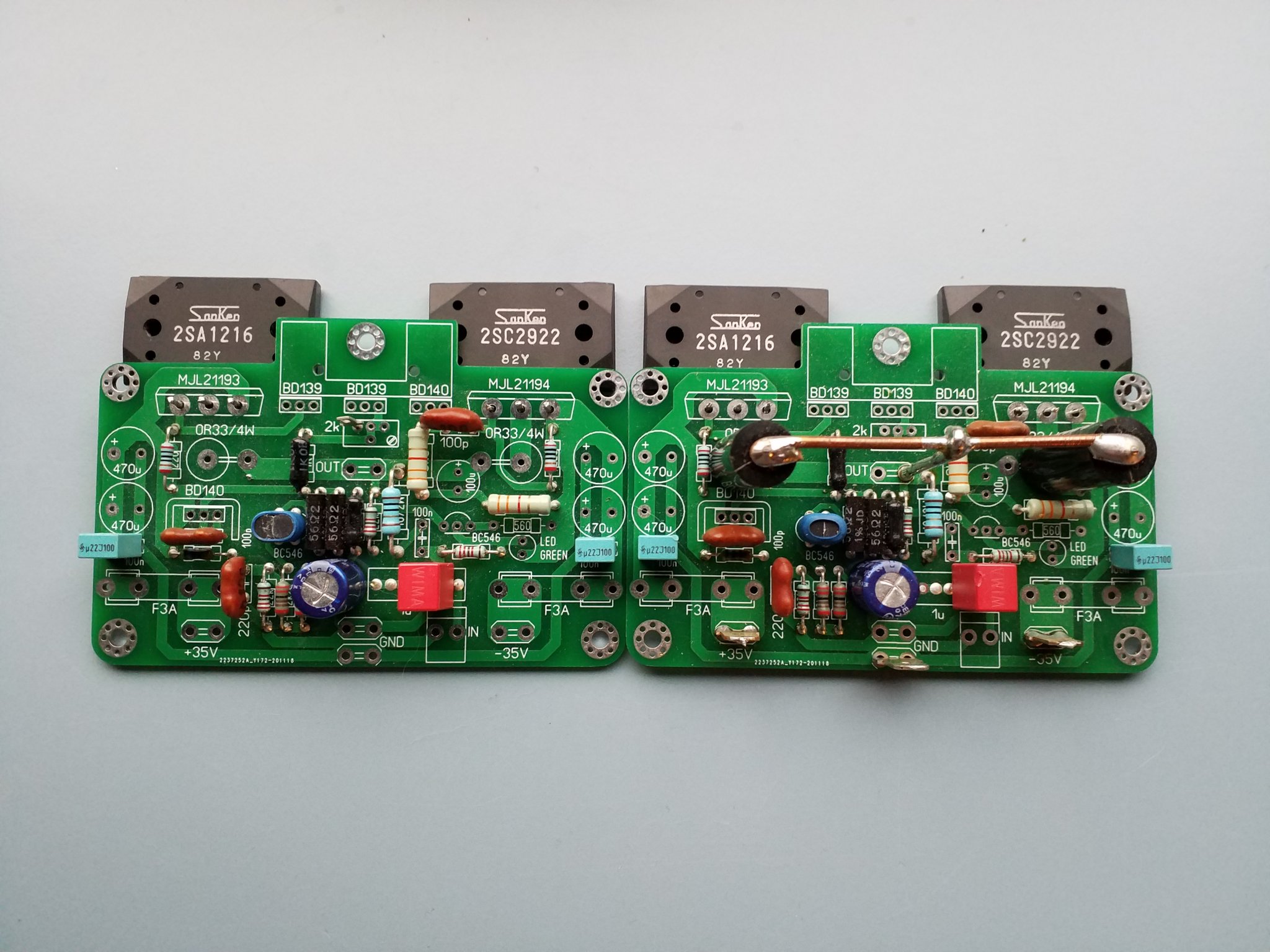

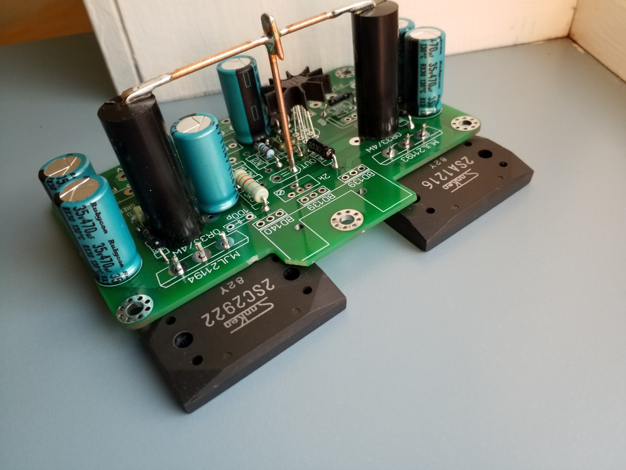

I have more p3a pcb and decided to try this combination with sanken 2sa1216 and 2sc922.
I saw rod had used the same pcb as p3a for a class a version, with lower rails like the one I showed further up in thread, I have two more toroidals left and all parts except chassis.
I might be asking for trouble, theese are much faster devices

It looks odd but q9 on my boards are bd139, and placed in the middle of the two drivers which are 2sa1381-2sc3503, so thermal couple is very good.
Now its completed, and man this amp sings beautifully, I will take some measurements this weekend and post the here, this little beast will be my future reference.

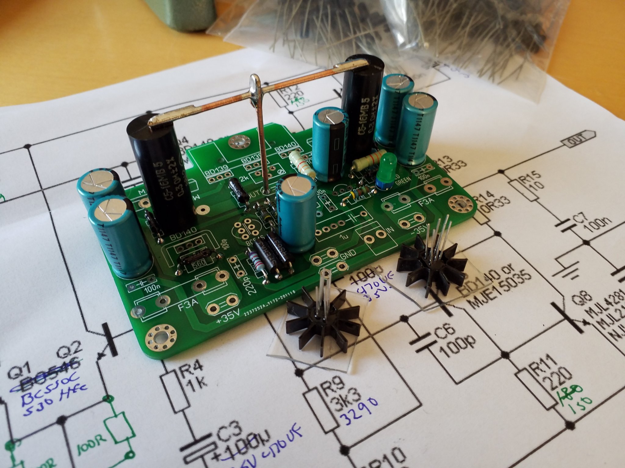

Have started a new p3a running class A , one of red elliots projects, still have two 300 watt 20 volt toroids.
Will spend some days with some fine tuning, finding a perfect bias level.
But as said will post measurement done with quantasylum.
As shown I will try use 2sa1216 and its compliment, any ideas for drivers?, and how about base resistor? 220r seems as a reasonable value..?
The build will run 1.5 amp bias and rail voltage would be +/÷ 27 volt

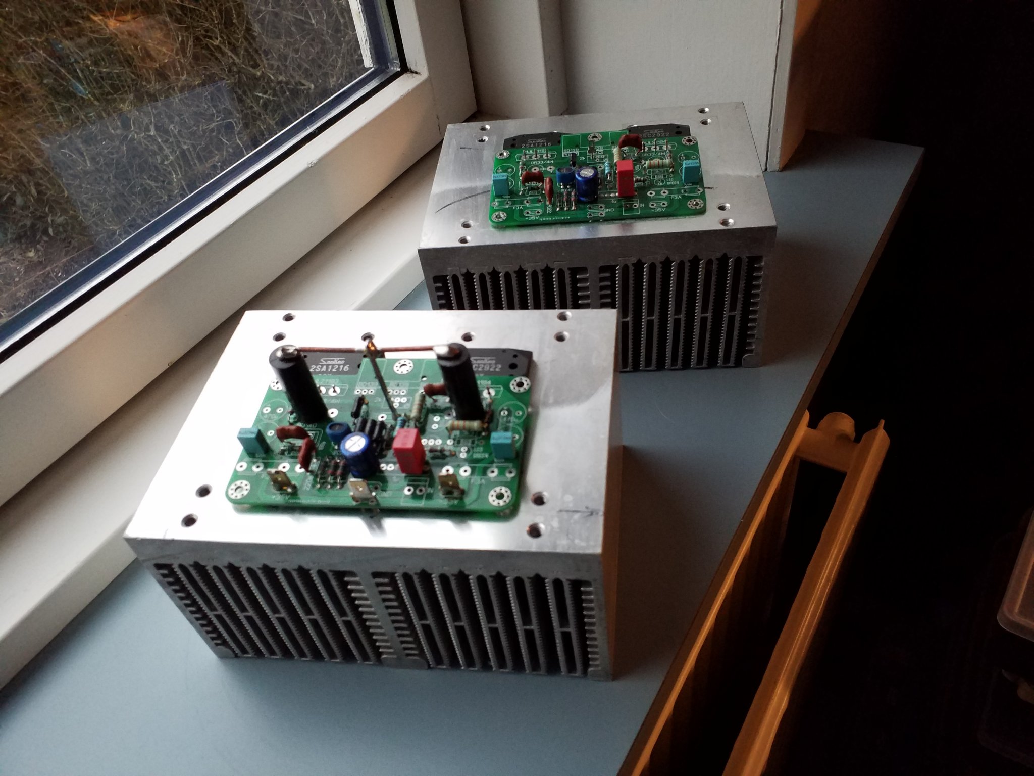

Been working on my new p3a today
Input. Bc550c matched tight with dca pro
Vas driver . 2sa1145 Y . Cob 2.5pf Ft 200 hz
Driver. Tta004b ttc004b 12pf 100 hz
Bias. Tta004b
Output. Sanken 2sa1216 2sc2922 Y
Powered it up through 50r resistors, seems to work so far, no oscillation.
Next step heatsinks and full power.

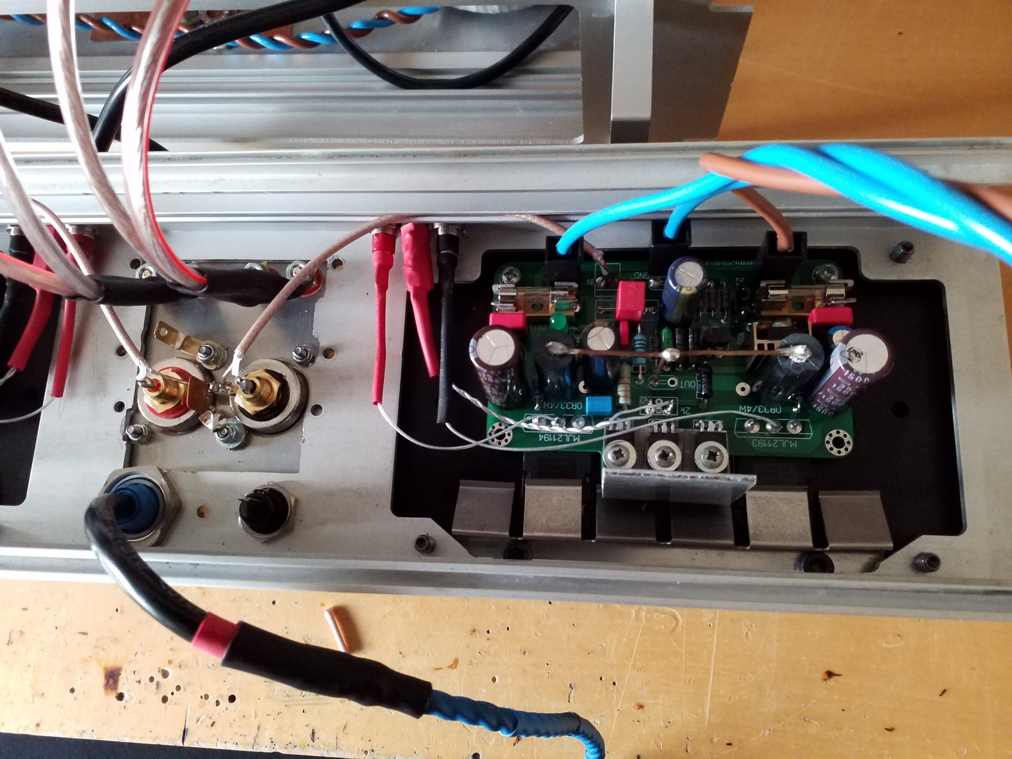

I've made P3A long time ago Rev.A. PCB ordered from Elliot. In meantime I used another amplifier. But a few days ago I wanted to check again my P3A. After so long time amplifier started to work without problem. Bias current was adjusted to 1,5A to get A class as it is in P3B project. For my ears A class sound better. First tried on my OB speakers but after I reconnected my Magnepan LRS. Instrument was still connected but I was surprised that bias current is changing in rhythm of music. Reconnected again to OB, bias stay stable. I know that Magneplanar has complicate load but I didn't expect variable bias current. Anyway amplifier is working perfectly with complicate LRS speakers.
My P3A sound much better after 2-3h connection on power. Anyone have same experience? Maybe because I have old Rev.A 17yrs.old. There is no thermal connection between transistors.
If your bias is very low then the time for the amp to warm up depenting also on outside temp may varry
if amplifier gets warmer it will play better .... Applies for most class AB amplifiers

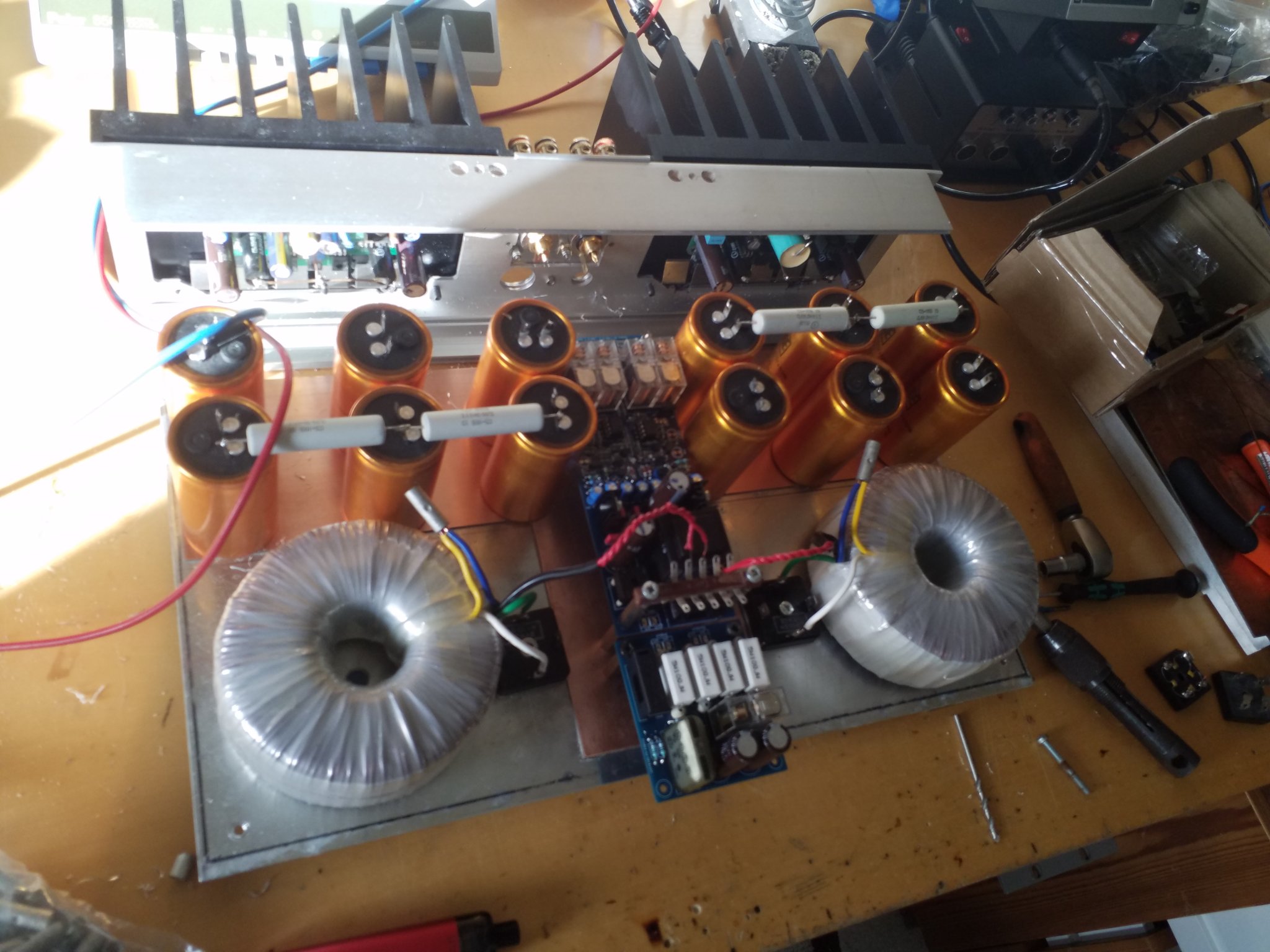

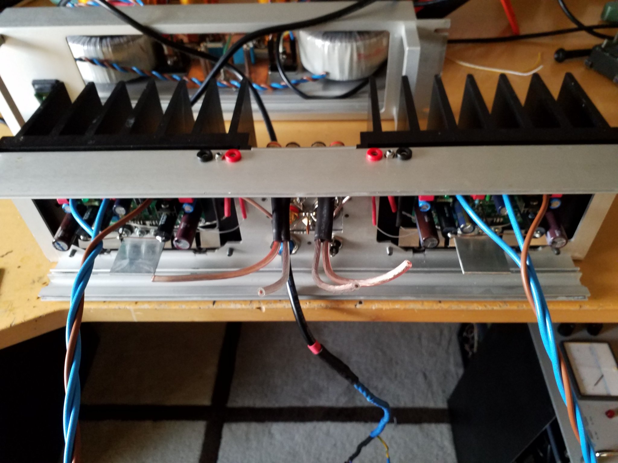

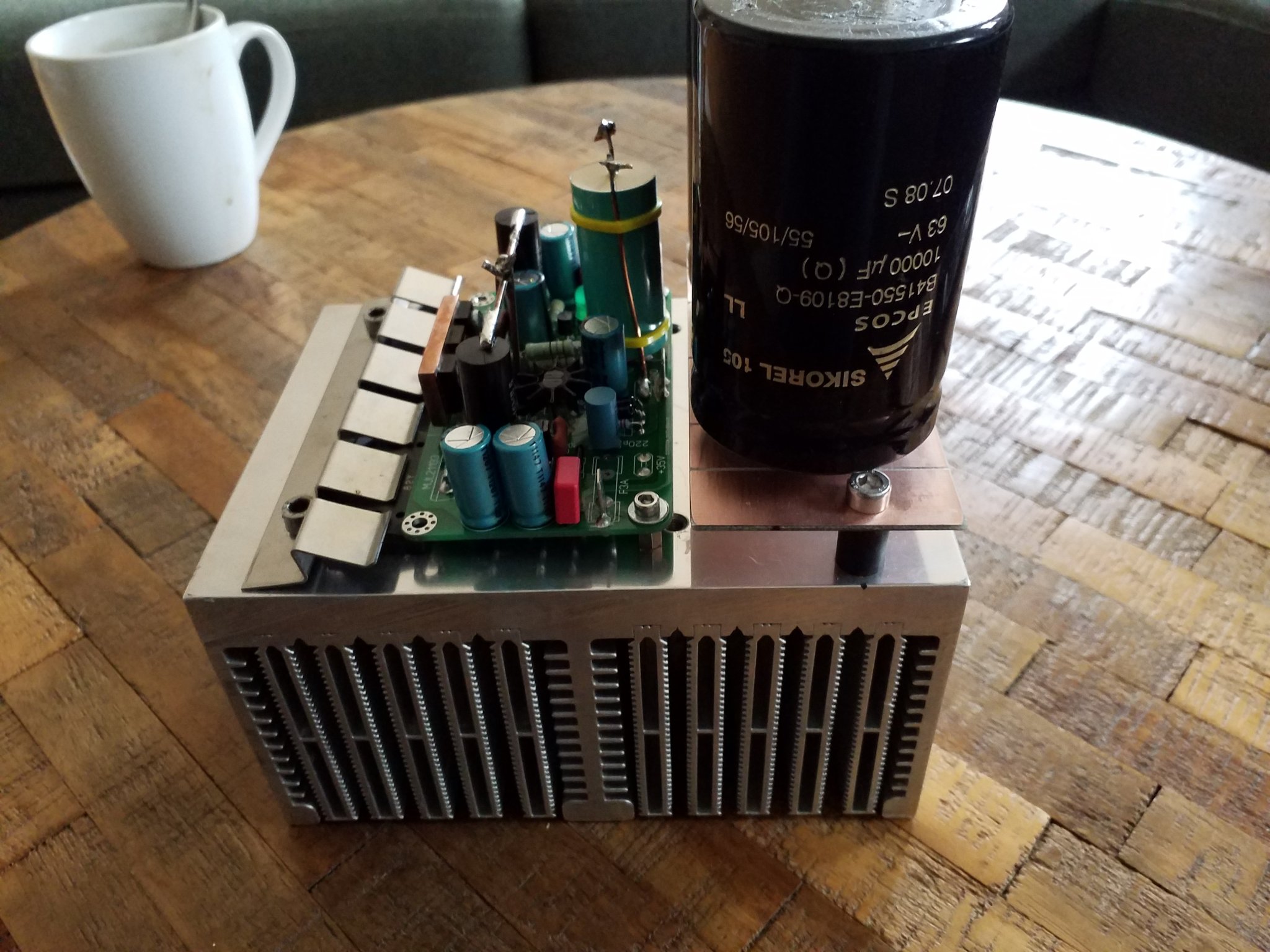

A bit more progress, the p3a are just how I want them now, i got them mounted on nice sinks, and added epcos sikorel 10000uf 63v just up against the pcb to minimize inductances, tomorrow the modules are ready to go into their chassis.
Man I like this amp, the best, most pleasing sound I've ever heard. The sikorels will be fed by a crc capacitor bank
