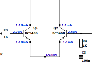

I have TinaTI so I can't use your LT Spice file. Can you see how much current goes through each of BC546 input transistors?
Screenshot attached. In addition, each transistor is dissipating about 40mW with 35V rails.

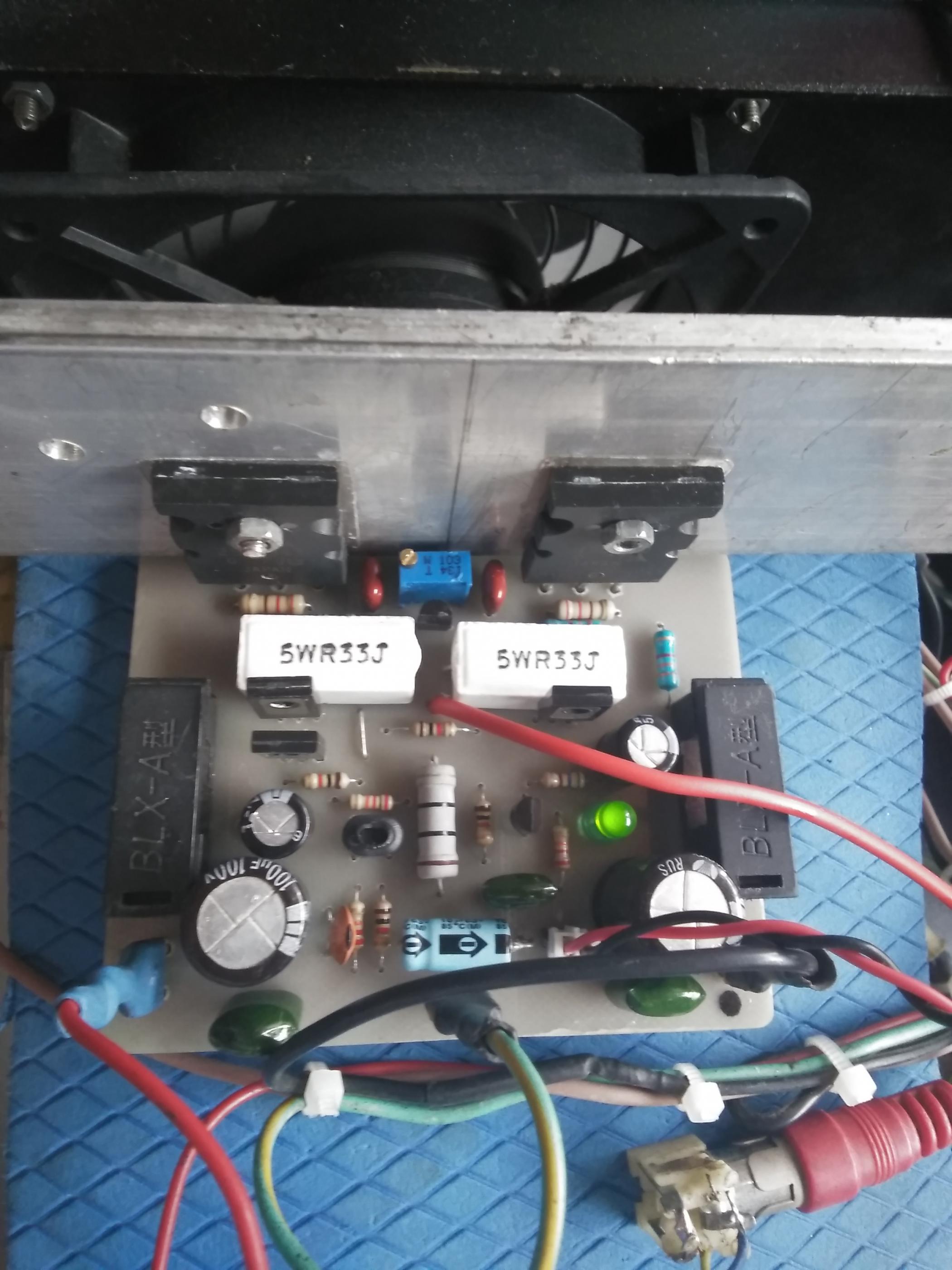

Ok. My P3A is working flawlessly.
Feeding 28vdc from C-core transformer&CRC power supply , 70mA bias, bd139-140 drivers, a1492&c3856 outputs.
I don't have scope, so I have no idea about technical perfection (or non perfection) of my work.
Dc offset is around 1-5mv for both channels.
Miller cap is 100pf ceramic.
I listened for five hours with nos pcm56 dac feeding p88 preamp and then p3a. Load is 4 ohm bookshelf speakers.
Sound is surprisingly well, balanced and dynamic. Not harsh.
I can say, it's quite close to my f5 but with higher gain.
It has more punch at low frequencies than my AM-69.
Overall, I think it has a lot of potential.
Btw, I used everything from my stash, so no ordered or special or butique parts..
