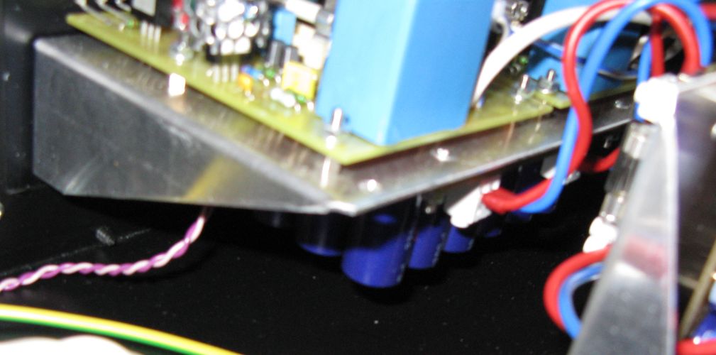

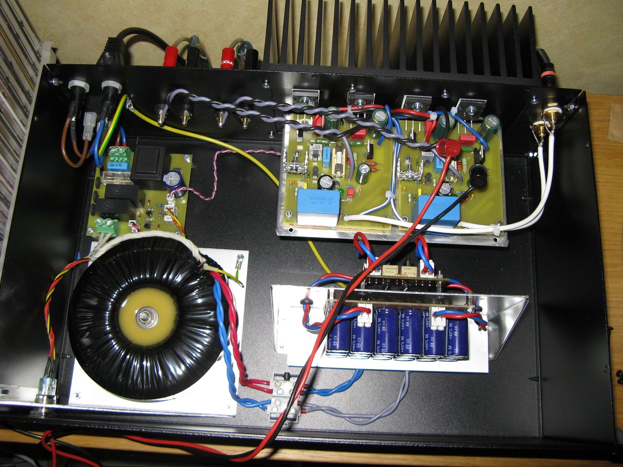

Here is a picture of my recently completed P3A. I made my own layout mostly to be able to use the components I already have, mainly the slightly grotesque 5µF 1100V input capacitors, it can now safely handle the offset voltage from broken valve preamps...
I use ground planes, two of them to be precise one around the outputs that handles local decoupling and output zobel network, the other is for all low signal ground, each ground plane have a separate cable to the central ground point.
The power supply uses two rectifiers and the two supply halves are brought together only at the central ground point. There is no audible hum at all with my normal speakers even if I put my ear next to the speaker maybe a faint hiss from the tweeter if the room is really quiet.
The first picture does not show the board with half of the capacitors and the central ground point very well, it hangs under the shelf that the amplifier boards are mounted on so the connections to the supply is very short maybe 4cm, here is an attempt to show it better.
