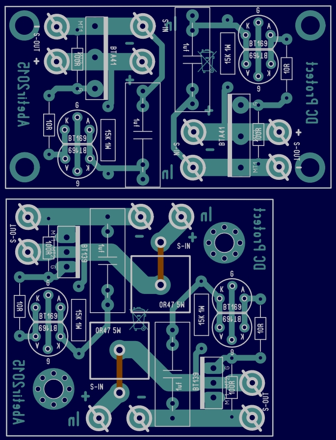

My build is pretty compact onboard fuses are omitted, I currently have one fuse located at the AC mains but I was thinking of installing a crowbar dc fault protect. I know its not a wise thing to do because of its possibility to destroy other components right on its path when it triggers. (hopefully it won't happen)
I like this circuit for its dormant state (passive) no power is required and does not seem to intervene with the circuitry unless called for action (only in the event of a DC fault).
I do not want to put relays at the moment because it will be needing add'l external PSU and the board is somewhat larger. I have read that fuses is a must when implementing crowbar circuit.

Perhaps mount a pair of fuses to the chassis (I.e. Chassis mount fuses) then you don't have to include them on the PCB?
Yes, you can mount the fuses anywhere you find convenient and safe. Even in-line fuseholders for automotive/solar 12V systems will be fine. However, crowbar protection for small amplifiers is a waste of resources, in my experience, You will likely find that for every time it protects your amplifier, even a carefully set crowbar trigger will just as soon cause the destruction of both amplifier and fuses.
It seems to be a more reliable protection system in very large amplifiers, though they can suffer occasional disasters too. Try the fuses alone and see if you have problems first. If so, fit a universal DC/current limiter chip such as the clones of uPC1237 etc. Despite the apparent advantages for audio amplifiers, I think the crowbar is a last resort technique myself and you soon tire of needless replacements.
