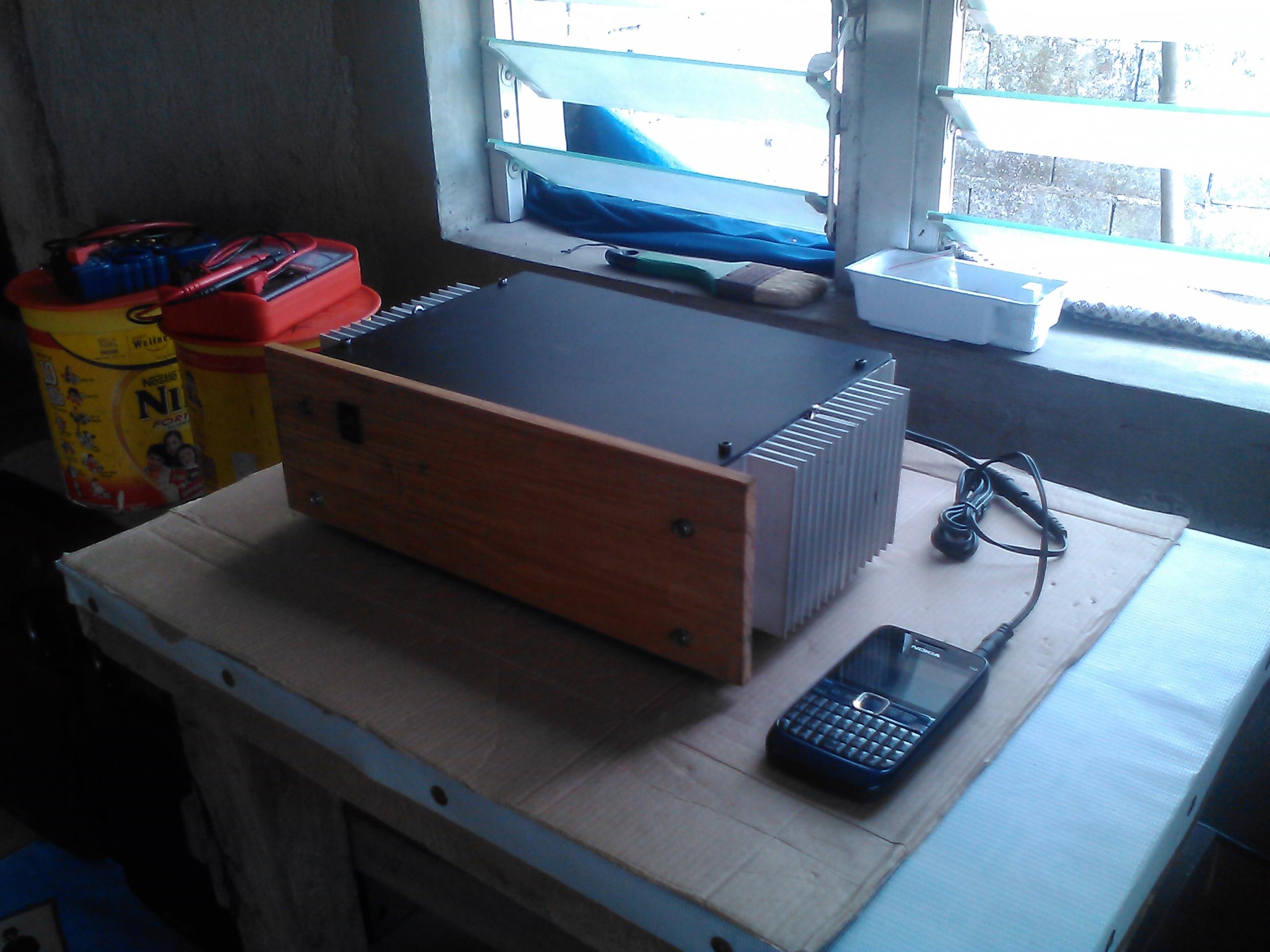

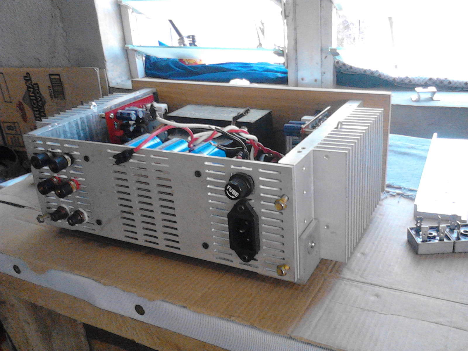

My P3A has its new home...

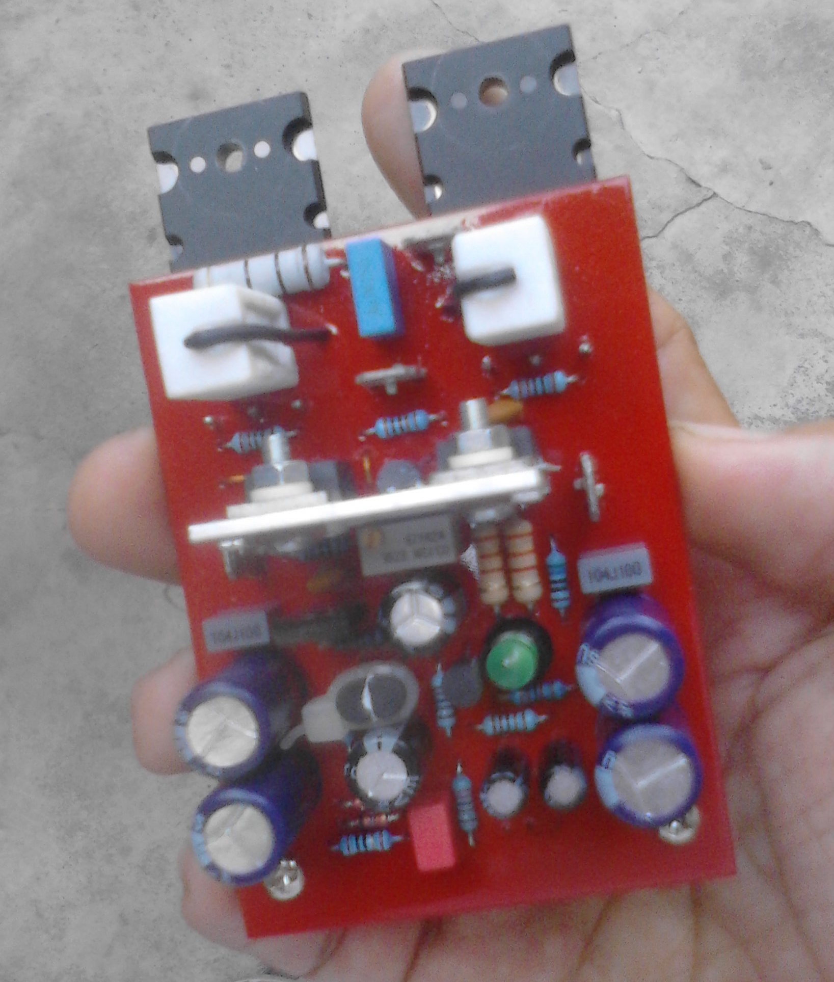

Nice project 🙂
It would seem to be in control at your playing level, at least. I couldn't find our posts that refer to this though.
It refers to this arrangement (attached photo), by the way I have biased my P3A at 100ma for a test, I could not hear any sonic differences between the minimum 20ma however at 2 hours playtime heatsink was totally HOT to the touch. I have settled to 22ma (15mv across two 0.33r) and I am satisfied with it. Heatsink is barely warm after 4 hours of playtime at minimum vol level.
I have replaced the MJE drivers with Fairchilds 2SC4793/SA1837, Sakis was right the MJEs sounds metallic, the only noticeable thing was that the highs is crispy clean but seems to be lacking in bass punch.
