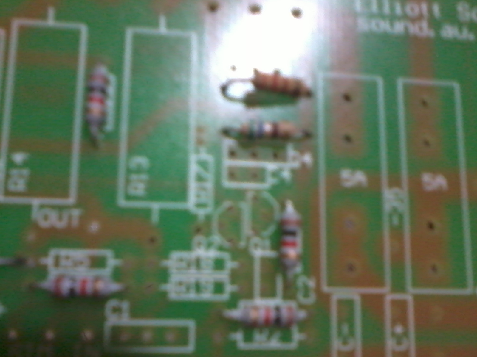

Hi, today I start populating an original ESP P3a board that I buy from RE some years ago.
While inserting the resistors in their places on the board, I noted that R18, R19 and R17 on one channel, and R18, R19 in the other channel, are not figured in the original schematic.
I suspect these resistor places are related to the optional attachment of a "Sound Inpairment Monitor" circuit, and can safely left unpopulated, Am I right?
If you bought from ESP, you would also have received notes with the PCB, explaining assembly and the SIM feature. The design has since been revised, eliminating the SIM and discussion on the P3a project webpage. However, it is still shown as a separate project, P57.
The SIM adaptor was not much more than a pair of 10k resistors, one from each base of Q1,Q2 to external test connection pins. Yes, you can assemble it just as you see in the pic of the earlier version, where the resistors and pins are also omitted. As the dual amplifier board is also intended to be cut in 2 for separate boards, I can't imagine why R17 is on one board and not the other. As it is not shown on the latest version, perhaps you should check the circuit by inspecting the traces, which will soon reveal where it is connected and whether it is necessary at all.

Yes, thanks, R17 is only in one channel and go to R5, the other end connect to nothing, so I will ignore it all. BTW. at the time I received a key to enter the construction section of Rod site, but it was long lost/forgotten, due to many time and PCs passed under the bridge..
