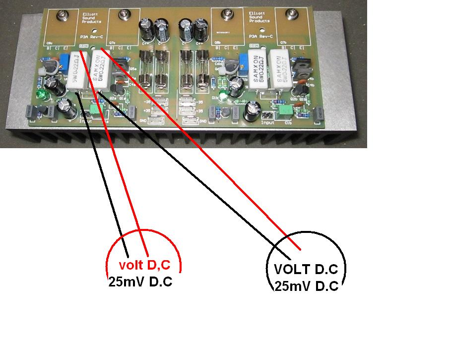

@ AndrewT
thanks Andrew
i'm not used to match emitter resistance i didn't know that earlier but i'll do as you said... but what a bout the drivers ... this can't be also due to the drivers? i don't know a way to match drivers except measuring each one Hfe with Hfe meter
Regards
thanks Andrew
Regards
Short the input ,leave the output empty(nothing connected)
measure output using a voltmeter at d.c scale. What is your measurement?
also Rod recommends total bias of 75mA (50mV from collector to collector). whats the rms voltage of input source? i think it should be 1.22v for full power.
the drivers do not affect the bias current passing from top to bottom through the outputs.... but what a bout the drivers ... this can't be also due to the drivers? i don't know a way to match drivers except measuring each one Hfe with Hfe meter ............
The drivers do affect the base voltages and this affects the output offset.
It is the DIFFERENCE between the bases that changes the output bias current and that is controlled by the bias voltage coming from the Vbe multiplier.

@thimios :
the output voltage when shorted the input was about 5mv idon't know if accurate or not i use multimeter Sanwa CD800A.
@prasi :
yes prasi i adjusted the bias current for 50mV ... and my input source is the PC jack i measured the AC of input signal without connecting to amp was 0.4VAC with mutlimeter i think it's peak) and measured with the amp connected is 0.2VAC.
is this normal? i think it's good reason for not full power
@AndrewT :
Good to know that Andrew...my offset is 12mV

12mV d.c offset is ok(5mV when input shorted is even better).

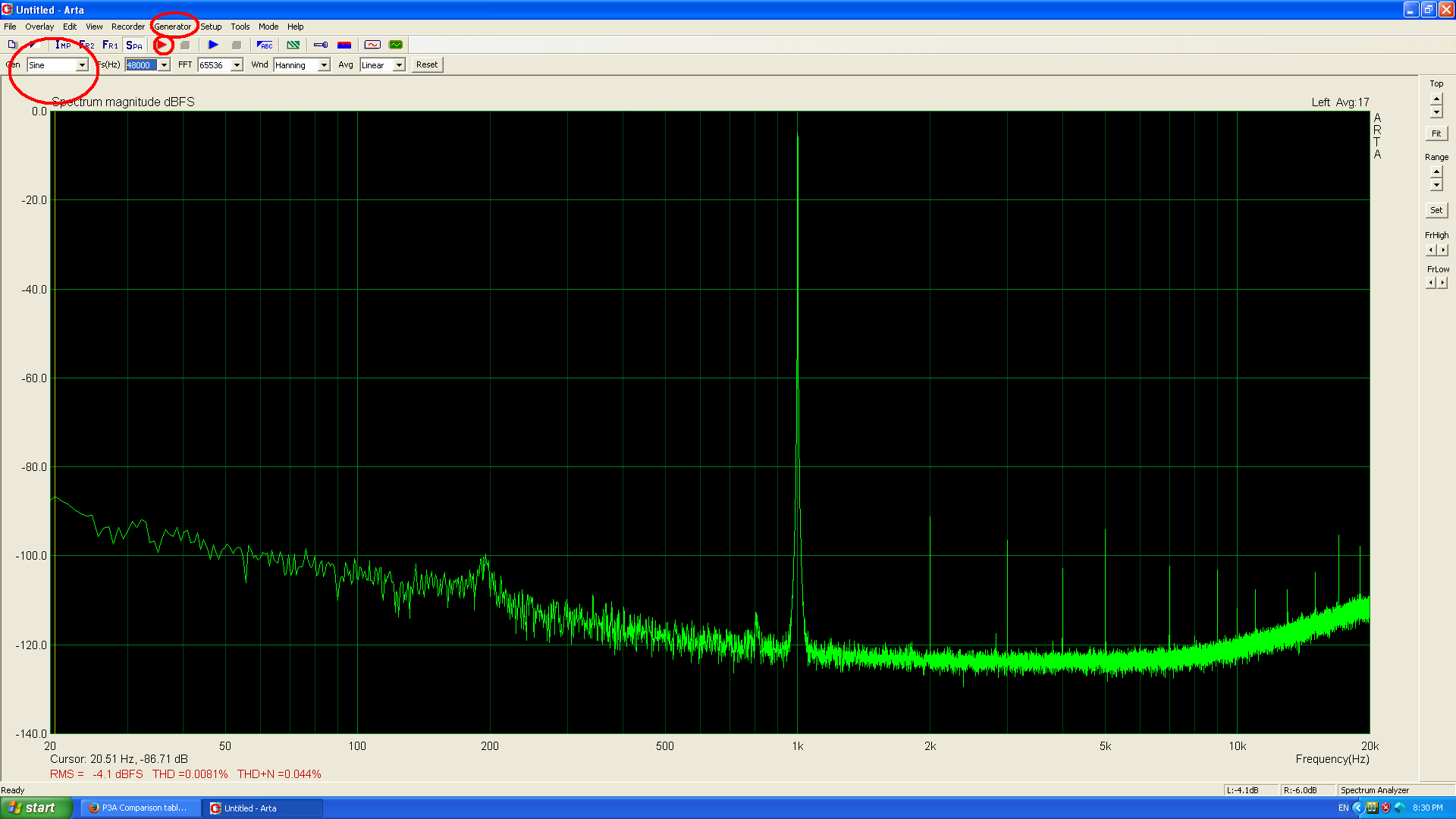

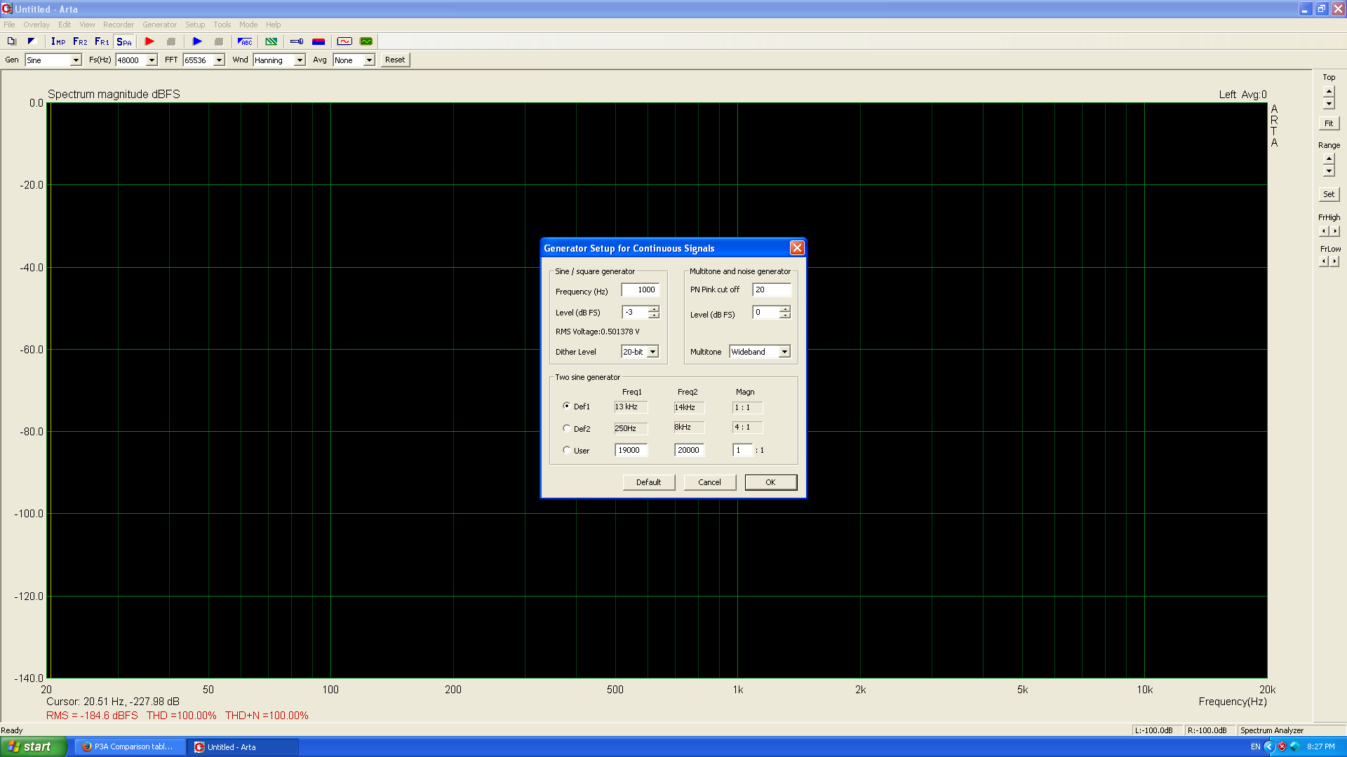

In order to measure A.C signal voltage from your P.C you must instal a software like ARTA and turn on the software generator at 400Hz or 1000Hz.Then a voltmeter(a.c scale) connected in sound card line out indicate the A.C voltage.
Adjust the volume to max in the sound card mixer
You can't measure the output A.C voltage just playing music.

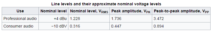

i will just download the software and do that measure but while doing that why it can't be done by just measuring the AC signal from PC?
Have you adjust the volume for max.level?thimios
i download it and did the measure the AC signal was 0.76 vAC

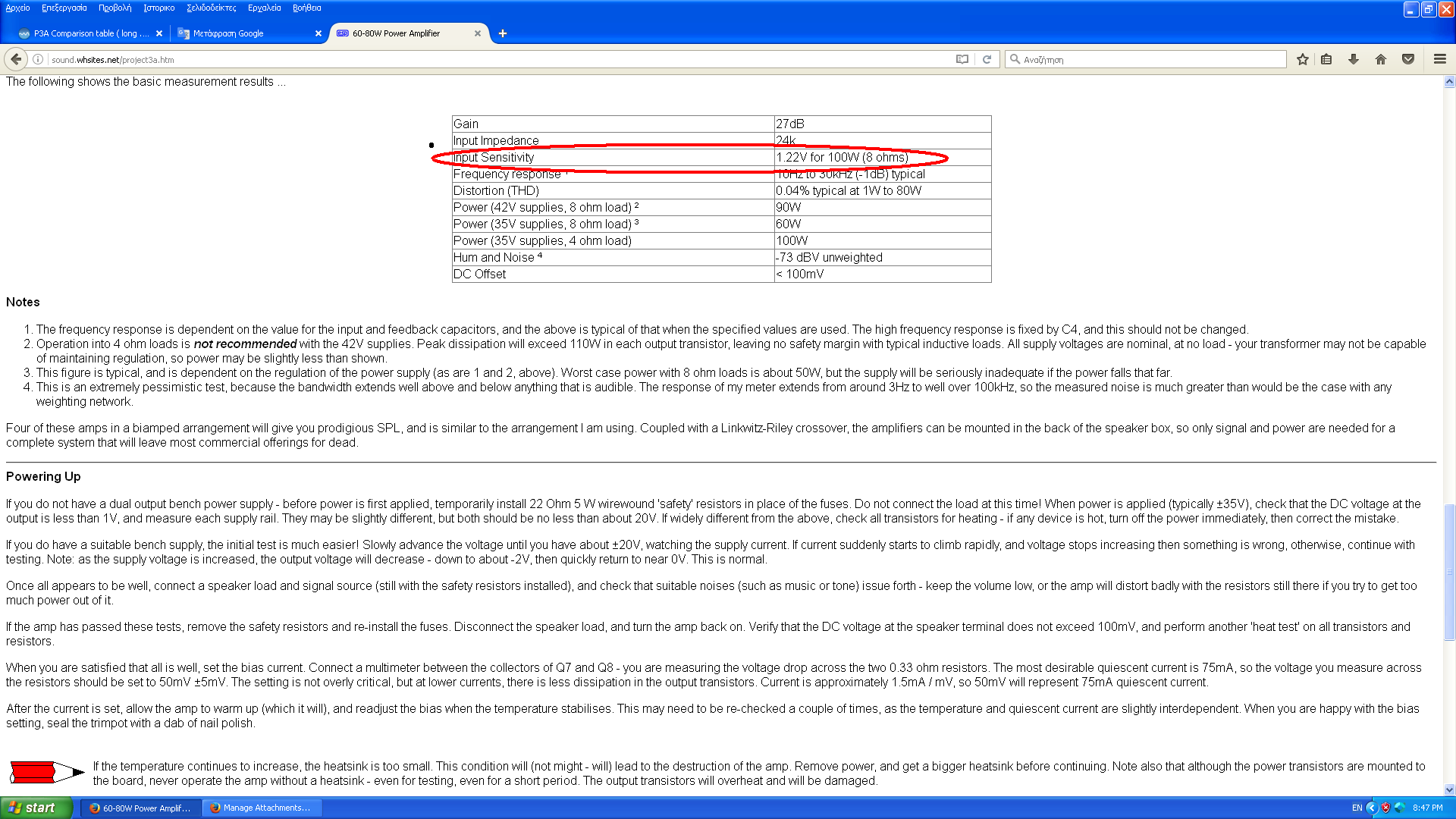

1.2V A.C is necessary for full driving (according to Elliot guides).
Look at second picture how you must adjust the bias.
yes i did and by searching i noticed this is normal for consumer line level where the professional line level is 1.22v this according to wikipedia
https://en.wikipedia.org/wiki/Line_level
i did that except for that i adjust it to 30mV Elliot said it's not critical but just for reducing the heat of the power transistors but i think that has nothing to do with the input signal
can't i decrease the input resistance or connect some kind of buffer , preamp or live level buffer for that issue ?
now i know the problem is ot with the amplifier it's with in my signal source i may just simply use higher power amplifier but i need to figure something out to solve this issue to get use of the unused power

No input signal and bias adjustment are two different things.yes i did and by searching i noticed this is normal for consumer line level where the professional line level is 1.22v this according to wikipedia
I post the bias adjustment just to be shure that you anderstund the prosedure well.🙂
