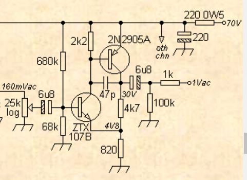

Let's take the Nakamichi CA5 minimalist line stage that is in the line of what i like to see ... changing active parts for more powerful ones may i get a small power minimalist integrated with Vgain of 10 like the line stage ?
again i really need very few watts ... a Vgain of 10-15 times max would be more than enough. I am moving towards high efficiency speakers.
And the same of course with the Rotel line stage replacing the output pair with a let's say 150W bjts pair ... can that be transformed in a integrated power amp ? in other sectors it is called scale-up. Scaling up a line preamp to an integrated power amp by changing the active parts used. Of course modifying also the passive parts accordingly.
Another question ... better LOW open loop gain and less FB or HIGH open loop gain and more FB ? or this does not make the least difference ?

Higher gain means higher CMMR and PSRR...many manufacturers deliberately increased the gain in order to have a greater imunity... You have an input potentiometer to deal with the excess output most of the time and the SNR being a balance between voltage gain and input current noise its usually good enough. Besides the greater the gain, the greater the stability too...
these are very important points that i did not know and thank you very much for that.
Now the decision of more gain stages is more clear to me. Stability is of paramount importance. I can tell you a story. Years ago i wanted to arrange an hybrid integrated amp. I had and maybe i still have a Croft Micro tube preamp (i.e. just a pot followed by a unity gain buffer) and i would like to use only the power stages of a Rotel ra-930ax bypassing its volume control and 1st op-amp. I made the big mistake of replacing the FB resistor to decrease the power amp stage gain ... the amp muted ... i put a hand on the fins and i got burnt in a hard way. Yes i am that stupid. I learnt then that the amp was become unstable. I remember the mains transformer start to vibrate ... what a disaster ... i think i still have the amp's corpse somewhere. Still that idea is very strong on me ... the hybrid solution. Tubed front end and solid state power.

I can agree that the more power you want the more complex the design. A line stage must add very little voltage gain and being able to drive properly a 600 ohm load ... to be on the safe side. I see Stereophile doing measurements also on 600 ohm ... the amp with the lowest Zin i found was my Albarry m408 ... 5kohm/0,5V at its input
this is difficult ... for instance i love diamond buffers a lot ... symmetry is a characteristic of beauty in the end. Actually an high quality pot followed by a buffer could be my final line stage ... i will have always a huge gain in the power amp ... or at least enough for my needs.except that some engineers will always be allowed to do whatever they want with a 100w amp...here the final stage has 4 times lower FT transistors than the previous one so you may get the idea 😉 If not...you have the difference in their specs as 60...80mhz transistors will never be the same as 20mhz transistors. The Kenwood to Accuphase transition of using diamond buffers was due to the industrie's dump of very fast transistors...
it really looks like i have to start simulating basic schematicBefore doubling any transistor you may try splitting the emitter resistors and connect them to output as both simulations and some good authors recomend that too for lower distortions
For instance given a circuit to know how much will be the open loop gain is very important.
I wonder if also PSRR can be obtained by simulation. That would be fantastic.

...that darlington transistors could allow for simpler schematic...Why designers do not love darlington?
Actually with a darlington an extra (current amplification) stage is introduced, so this increases the complexity. Apart from biasing and crossover distortion which should be taken into account when using them (even more complexity). The VK8060 is a very classical simplistic, not minimalistic design. But their aim was to make an affordable and reliable amplifier for the enthusiastic audio diy-er - everything you make yourself sounds awfully good, objective as we humans are.
Your Rotel circuit in #72 is what you would like to see as discussed earlier in this thread. Keep in mind that a collector-collector (or drain-drain) output is a high impedance node and susceptable for instability and hf-pickup, unless there is full control of feedback and load conditions. A darlington does not make it better (extra gain stage) nor lowers the output impedance. Such circuits are not suitable as drivers for loudspeakers or domestic audio equipment setups. Hence no commercial or succesfull units on the market (I exclude the current driven designs to keep this discussion clear - also it is about simplification of designs)....Could 513 and 515 be replaced with a darlington pair and be done with that closing there the FB loop...
If you want to use those Q513-Q515 as outputs (in this design it is the VAS), it also must have the capability to drive large (-r) currents. So these chaps must amplify voltage and current, temperature stable, linear beta over a large range and not so noisy. A low early effect is welcome too. If such transistors (or fets or tubes) would exist, this discussion was non existant.
Another and succesfull approach has been proven by Hiraga and Pass (& others): Hiraga uses a Sziklai as VAS and emitter follower with a minimal front stage (the input buffer could be omitted) rendering in a three-stage six transistor (bjt/fet) amplifier without the need for additional temperature or switch on/off electronics. Pass masters the single stage amplifier approach; chunky SIT's and a suitable current load. I own a 8W Hiraga and it sounds magnificent. I'm sure a Pass will sound superb too.
My (*) remark in #26 points to my low impedance triode-alike two transistor (+ three resistors) compound which does exactly the same as a triode tube or a SIT and makes such a desired two stage design possible.
Just checked the topic for updates while typing: I also agree with #96.
i see. The fact that they are not that common speaks for itself. My thinking was that to integrate driver and power bjts on the same chip was convenient instead of having two separate parts. I was wrong ... again 🙁
The VK8060 is a very classical simplistic, not minimalistic design. But their aim was to make an affordable and reliable amplifier for the enthusiastic audio diy-er - everything you make yourself sounds awfully good, objective as we humans are. Your Rotel circuit in #72 is what you would like to see as discussed earlier in this thread. Keep in mind that a collector-collector (or drain-drain) output is a high impedance node and susceptable for instability and hf-pickup, unless there is full control of feedback and load conditions. A darlington does not make it better (extra gain stage) nor lowers the output impedance. Such circuits are not suitable as drivers for loudspeakers or domestic audio equipment setups. Hence no commercial or succesfull units on the market (I exclude the current driven designs to keep this discussion clear - also it is about simplification of designs).
Everything but a masterpiece of an amp. I see. And actually i cannot see them used anywhere these days
Thank you for the kind explanation ... i do not think to have fully understood. But i understand is not the right way. No more discussions on darlington
i see. And what about taking them out completely and connect directly 501 to 517 to the output stage maybe swapping 517 and 519 ? is it really needed the intermediate 513/515 stage ? can this mod work and lead to similar performance in terms of sound ?If you want to use those Q513-Q515 as outputs (in this design it is the VAS), it also must have the capability to drive large (-r) currents. So these chaps must amplify voltage and current, temperature stable, linear beta over a large range and not so noisy. A low early effect is welcome too. If such transistors (or fets or tubes) would exist, this discussion was non existant.
Very interesting. What is your opinion on this approach ? and on the Sziklai as VAS ? i know that in the past was much more popular. End of 70s early 80s. A simple line stage example in the attachment.
Very very interesting. Is the schematic available somewhere ? i would love to see it. As i said above i am switching to high efficiency speakers and small power amps ... this would be very good if the sounds is that good.
Is it difficult to build ?
i have one copy badly built of the Pass Bride of Zen and i like it a lot. I just put a pot at the input and not the output because stage gain is quite high around 6 times maybe ? but overall a very interesting designI'm sure a Pass will sound superb too.
Actually after having a discussion about smps i would like to use a 48VDC smps to power it and changing some values ... the expert told me that some smps have very low noise in the audio range and very convenient.
I will buy a Meanwell LRS-35-48 for my line stage ideas ...
thank you very much for your very kind and valuable advice. Where i can find the schematic of the a 8W Hiraga amp ? i think that would be a good way to start the audio zen route ...My (*) remark in #26 points to my low impedance triode-alike two transistor (+ three resistors) compound which does exactly the same as a triode tube or a SIT and makes such a desired two stage design possible.
Kind regards, gino 🙂
