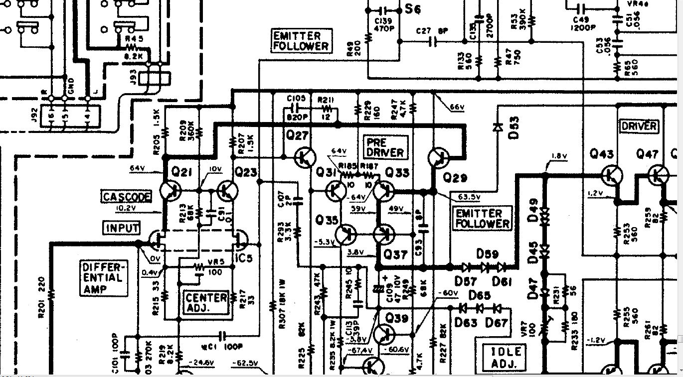

you missed the Pioneer's output diamond buffer which has no global feedback but has a different approach for that matter to keep distortions low enough, not very low though...
Audio research has another diamond output too
Thanks for the schematics ... i need time to study them and try to understand something. But i am focusing the line stages that drive the power amp stages. That buffer i have attached is in the signal path ... if the sound is good that stage must also be good. Ok this is trivial but still ...
And it is good for one of the best integrated around it could be more than enough for my purpose as a beginner.
For the input buffer you might like to read this Tektronix manual who's bufferes were used by harman kardon in some designs i think .

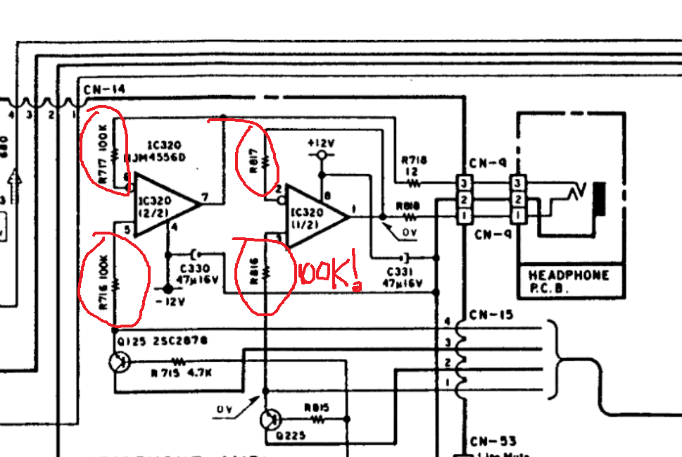

While other companies preffered for headphones amp to have a greater gain for a very well known headphones op-amp NJM4556, or like Yamaha using the inverted configuration, Nakamichi were again the real genious at improving a circuit as part of a whole, not independently of the other circuits of an audio equipment .
D.Self advised on using common mode cancelation resistor around 1 kohm, but nakamichi went for a monster Johnson noise resistor of 100kohm .It looked like they screwed it right? NO, and that is mainly because Johnson noise is perceived exactly as white noise which also have medical use .We like tape noise, we like vinyl groove noise....that's for a reason! It hides unwanted distortions and it's also relaxing the brain helping us hearing actually better and having a more pleasant listening than otherwise.
O2 headphones amp advised on using njm2068 in front two paralleled naked unity gain njm4556 for lower noise...Well...O2 forgot CMRR and PSRR with unity gain old op-amps adding a otherwise useless ultralow noise op-amp in front of it.Nakamichi simply evaluated the input current noise of NJM4556 (which by the way has a reasonably low input current bias )with that 100k resistors and actually got a pretty good noise figure because the 100k resistor not only worked out with the common mode distortions , but also lowered the overall RF pickup, power supply and intermodulation caused distortion noise too helped by the input capacitance of the op-amp.It was used in a cassette player, but a very low noise one and used with 16 bit cd's will also help with older ones dither, quite a lot.Well...I have a 2008 Norah Jones album that decided to use something like cassette tape recording on some songs and it sound really like s..t not even sound like a mild 19cm/s reel to reel noise, but very agressive dbx like breathing noise.I preffer a natural Johnson resistor noise instead.

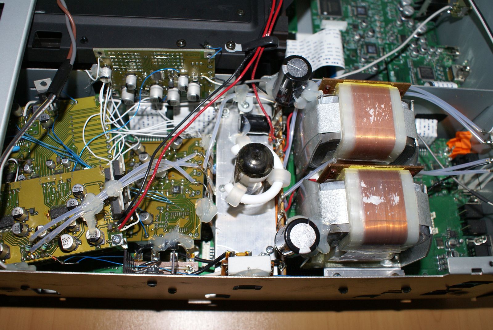

The Denon 3910 has very good audio specifications, not sure how you would improve on that beyond what the Denon engineers could do at the time.
Have you see pictures of the mods ? Can't see how its an improvement.

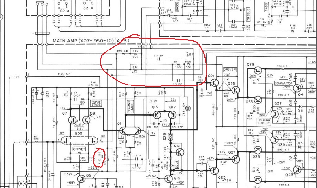

I'm a test engineer and worked with high power lasers, medical equipment, high voltage smps, but i won't mix lasers reliability talk with audio equipment which is an entire different matter.But airplanes...they look like an entirely different ball game!
One very simple reliability test is to disconect one supply rail in dual supply amps and see what happens.Well..Lt Spice wont't tell you **** about the Bass speaker smoke...
Another simple test is to disconect the input to ground resistor or the rca input socket's ground or the feedback input in an op-amp or just run a dc sweep to the rails or short circuit the decoupling feedback capacitor and see what happens .Will the circuit survive? Will the dc output simply destroy everything downstream? These things happen often after a number of years of continuous play and the result is that we need to look for new transistors and speakers...

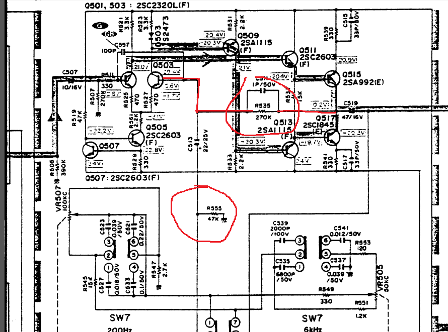

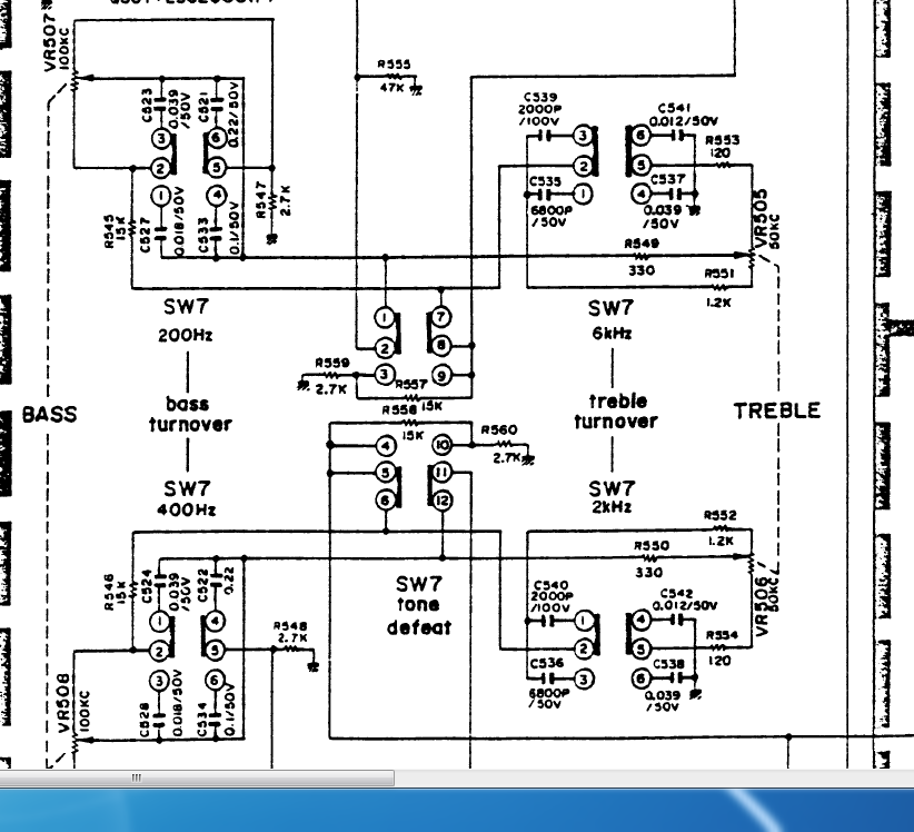

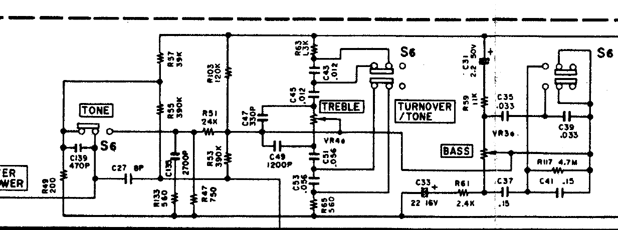

A few days ago looking into an active harman kardon equalizer i saw something strange.The turnover switch didn't shortcircuit one of the series capacitors as it's usually done, but simply switched between two different capacitors...That's's better from a distortion point of view due to lower capacitor losses , but what if the switch will fail to engage either of both sections? We'll have a partly disfunctional circuit until the switch is cleaned or replaced.At least all the competitors will have one eq turnover section working with a faulty switch.At least Harman Kardon left the 6x gain basic negative feedback out of the switches path so that if the tone eq /tone defeat switch fails the circuit will still be functional.
Now here comes the strange part: kenwood did the right thing with the tone eq, but assured no dc bias path for the inverted input ouside the switch .What will happen if the tone /defeat switch fails to engage either position?
Now here's one more thing..There's a lower ranked kenwood model, at list by its look that didn't screwed the dc bias straight path...Well...guess what, the high end model registered tons of fried transistors ...So high end doesn't necessarily means better quality!
Maybe we need not just a switch, but also a straight parallel high value resistor too, at least to remove the switching noise caused by sudden capacitors charge or by dustry switches and that means more components higher safety!

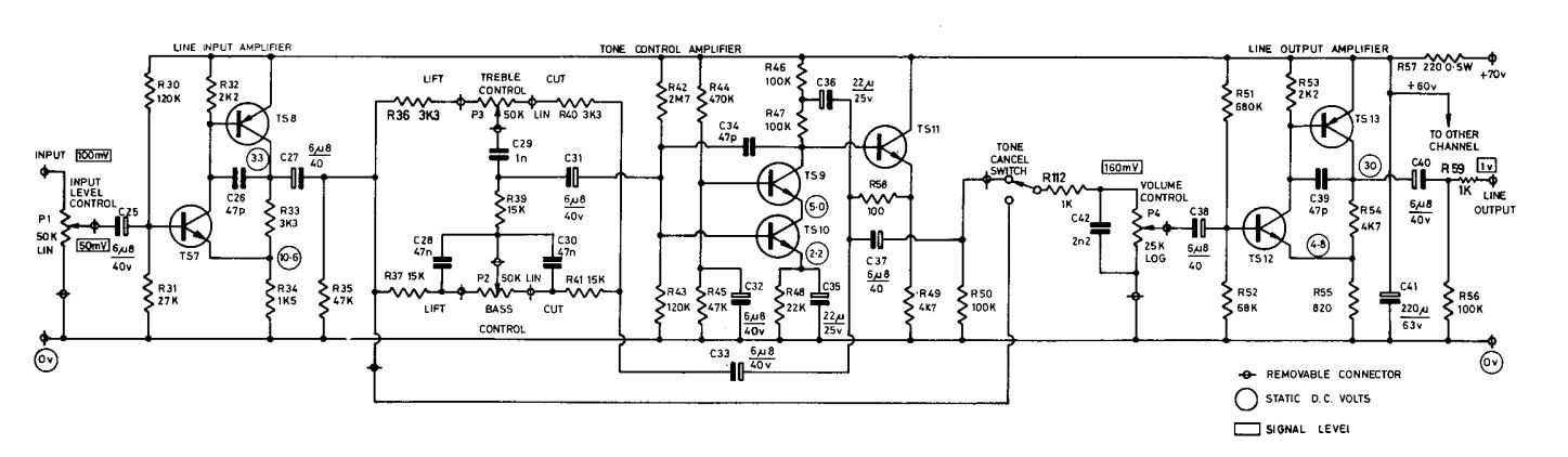

Please look at the line stage in the pic attached ... don't you see a little redundancy ? To have a line stage for me either the line input amplifier or the line output amplifier(maybe with stage gain reduced) would be more than enough to make a nice line stage.
I do not see the need of all these stages one after the other ... just that
Just think if the sound out of just one stage were better ... is not this electronic design perversion ? 🙄
