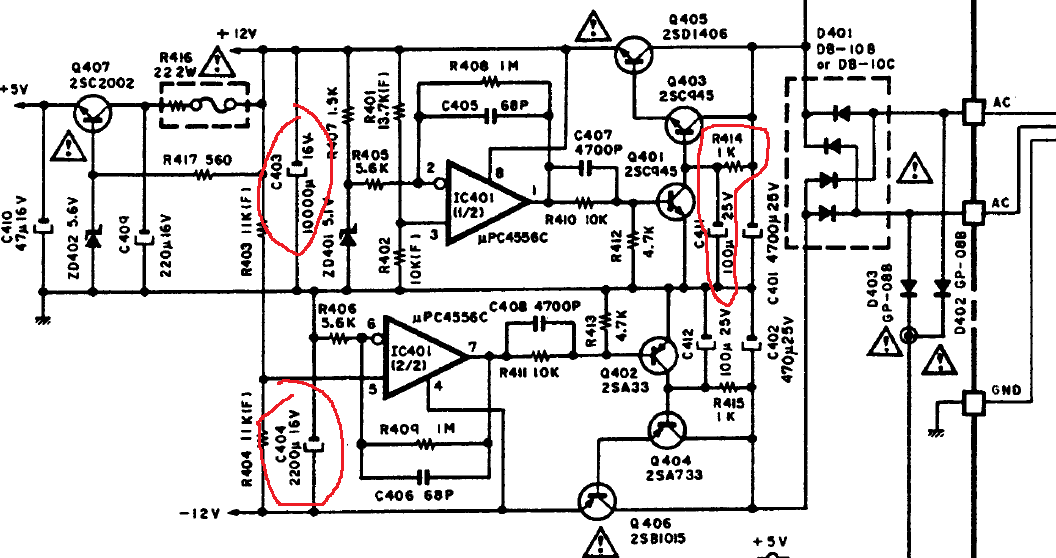

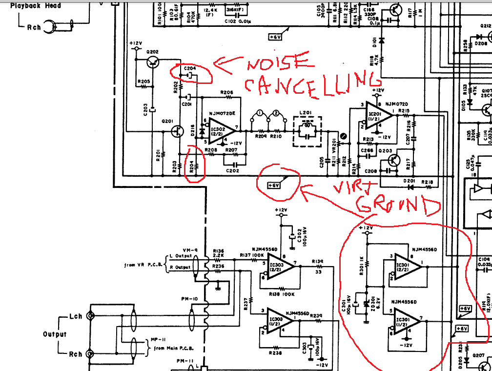

to be honest i was never interested in these theories, being actually on the "practical side|" most of my life until i met this wonderful Nakamichi BX300 cassette deck which was a revelation to me.Apart from its noise supressing techniqe it has a virtual ground generator with no cap at its otput relying entirey on op-amps bandwidth , cmrr and psrr.
At the same time its +-12v regulator has nothing but a 10 000uf capacitor at the output.And it's a NAK...so maybe it's not that bad to rely on capacitor's abilities more than the reglator's bandwidth...

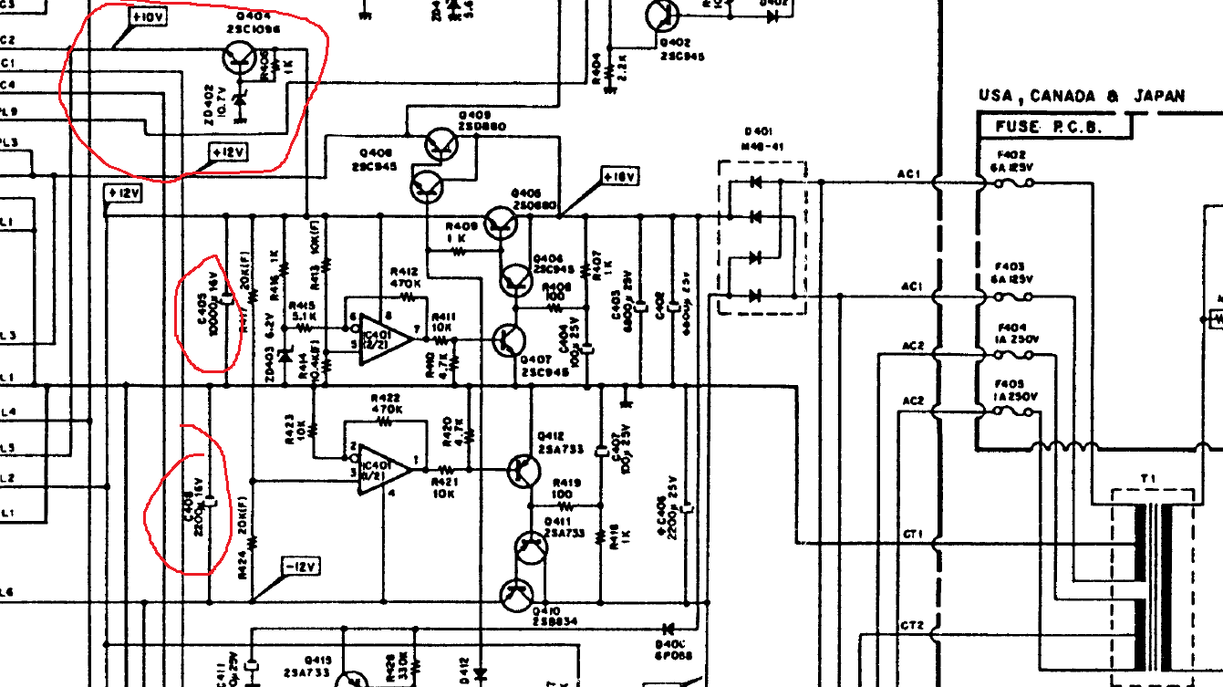

Some time ago i was convinced that they must have a such complex regulator regulator to make it faster...until someone prompted me to the 1k-100uf rc constant in red circle...
I'd really like to get a really professional comment on that nakamichi regulator phylosophy as it's found in al their high end cassette deck, including the Dragon and ZXL-1000, but i'm afraid i will never get one so i have to trust my guts when i make assesements on what , where and when i should use some particular topology. As for that nak regulator i believe that that topology is done like this in order to survive a catastrophic dead short at its output .

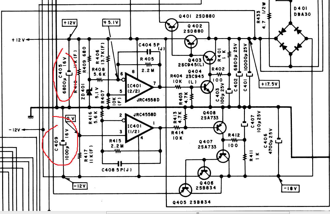

Yet...if it's a nakamichi zxl-1000 it doesn't mean it's shy at using a simple zener regulator after that fancy regulator.

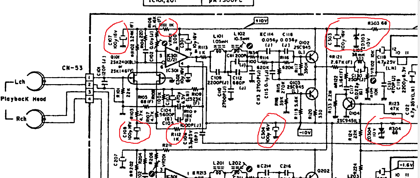

And another zener plus decoupling for its most sensitive part , the tape-head preamp and here's the most expensive tapehead playback circuit in history...

Reanalyzed the Nak voltage regulators with a fresh eye...these are the slowest regulators ever relying entirely on capacitors for energy drain .There's no need for fast tranzients regulation which aren't fast anyway due to the nature of tape head transducers.Power transistors have 3...5 mhz transition frequency and i think i finally understood their "philosophy" which is actually that they only needed to filter a lot of cassette player circuits.They were aimed entirely at reducing mains hum and providing enough current for the circuits.For a DAC supply regulation the cheap LM7812 is faster and better...

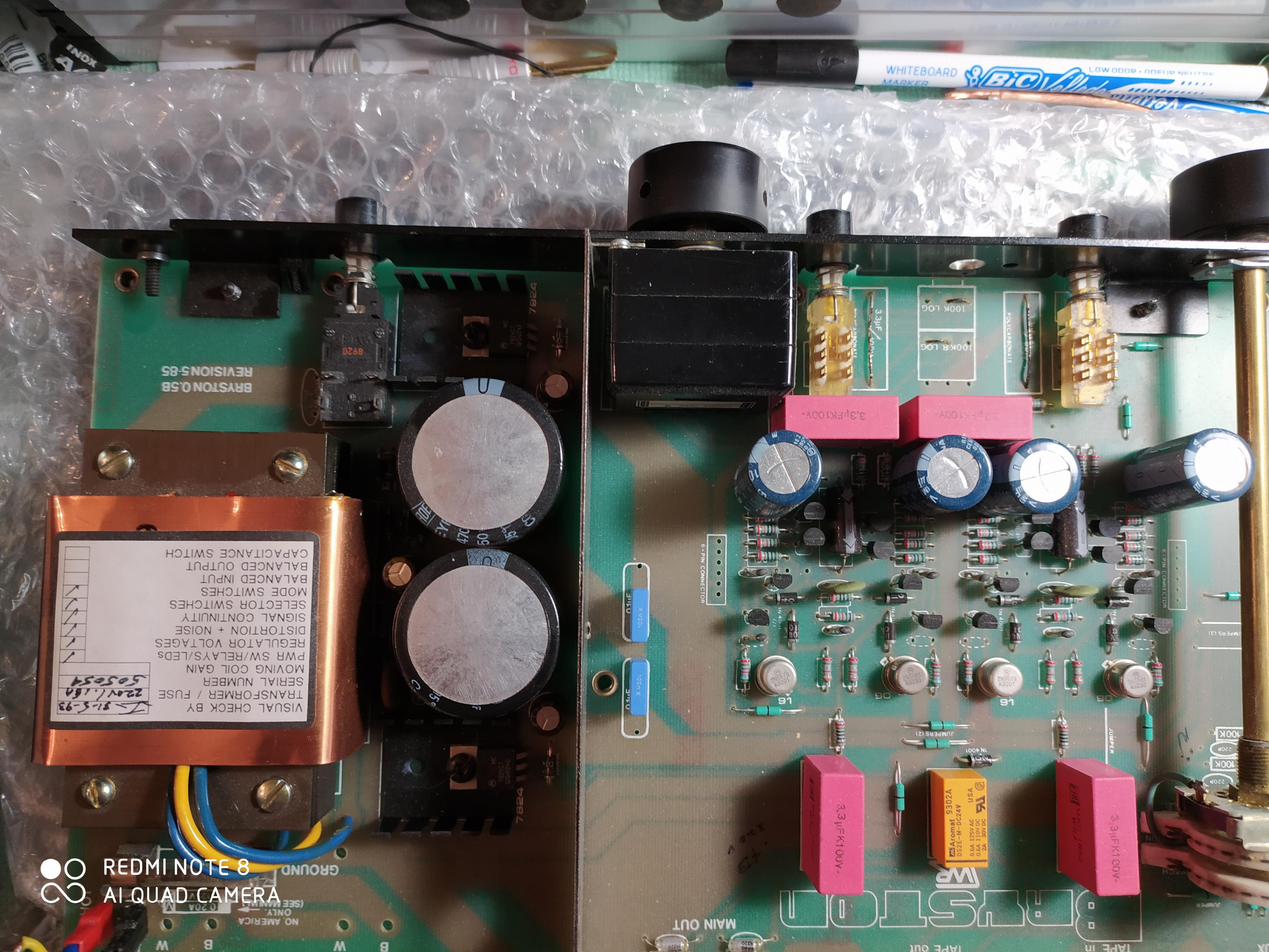

However i count 10 bjts /channel ... and it is just a line stage providing about 10dB of gain plus current
In the more recent designs they have reduce the number of active parts to 8 per channel and i guess with improvements in the performance
In the assumption that newer is better of course

I am thinking to take out the mains transformer and add maybe a mains filter before it. Other mods could destroy the very delicate unit.

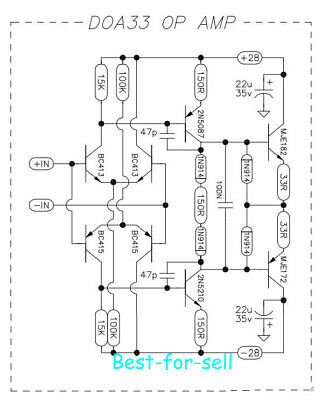

Moreover ... someone advised me that a bc413 cannot drive properly a MJE 172 (this would lead to higher distortion)
I wonder if this can be confirmed.
Another question would be can the 2n5210/2n5087 pair replace the bc413/bc415 pair as input stage ?
What is the main benefit of using a input stage of 4 bjts instead of the simpler classic diffential pair ?
I see 3 stages ... is it the very minimal solution ? better PSRR maybe ? less distortion ?
