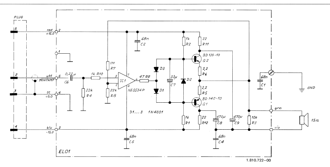

I see a (quite new) Studer schematic (service manual).
The phone amplifiers ware made (around) NJM4560.
The power supply's ware SMPS and only small signal stages were powered from a linear (some xxx1117 regulator) but all stages were true differential.
although i've downloaded about 10 studer partd of those manjuals i couldn't find the actual headphones amp, but i found some related schematics.
I got very interested in the schematics attached in post #294.
The one in the last of the six, is certainly a best.
With the right setting of current made by the two CCS thru the base spreader, this must give an outstanding low distortion amplifier.
Provided, the base spreader transistors and output transistors are thermally coupled, thermal stability is rock solid.
Studer or Neve were the leading figures of the whole recording industry...you can't ignore them.
Here's one more from a810 manual.they forgot the 0.1 ohm resistor in paralel with the 68nF cap to the ground from the speaker out.

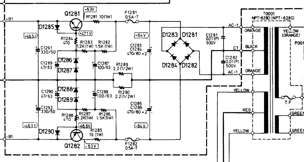

yes indeed. I will search in the proper section to understand how much fixed voltage regulators are popular. Maybe i was putting the blame on innocent opamps ... i am attaching an example. I guess that with different zeners could work also for -/+24V as well
I am seriously thinking about trying it ... 😱
About this regulated PSU be aware of:
There is not ouput protection. A short is fatal. The voltage is not accurate from zener diodes that have not so good accurate voltage.
LM317 LM337 are popular regulators one can adjust with two resistors.
Thanks ! just to complete information it is part of the power supply of the old Onkyo P-303 preamp, dated 1979 ? as mentioned above at the time there were not many monolithic voltage regulators. So the discrete solution was mandatory. I moved the question in the power supplies section for opportunity

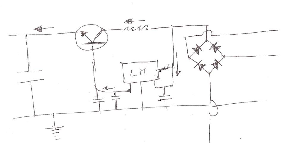

Some interesting discussions are coming out ... with someone mentioning the importance to have a good response to current transient 😕 and a high PSRR at higher frequencies. I am sure that some specific circuits can improve both also for the LM317.
Moreover given that you mention a not so good accurate voltage from zener diodes, could the LMxxx be used instead as voltage reference and the bjts as current devices ? i mean with the LM out connected to the bjt base 🙄
yes.i built something like this 15 years ago for a friend to supply a radio station:
12V 15A voltage regulator
Thanks ! i guess this is to increase the current out ? look instead at the schematic attached ... the LM part acts only as a voltage reference driving the bjt base
No need to source big current only stable voltage The current will be provided by the bjt instead
can it work ? that is the question 😱
I have looked in the LM datasheet but i did not find a similar schematic ... so i guess it cannot work
