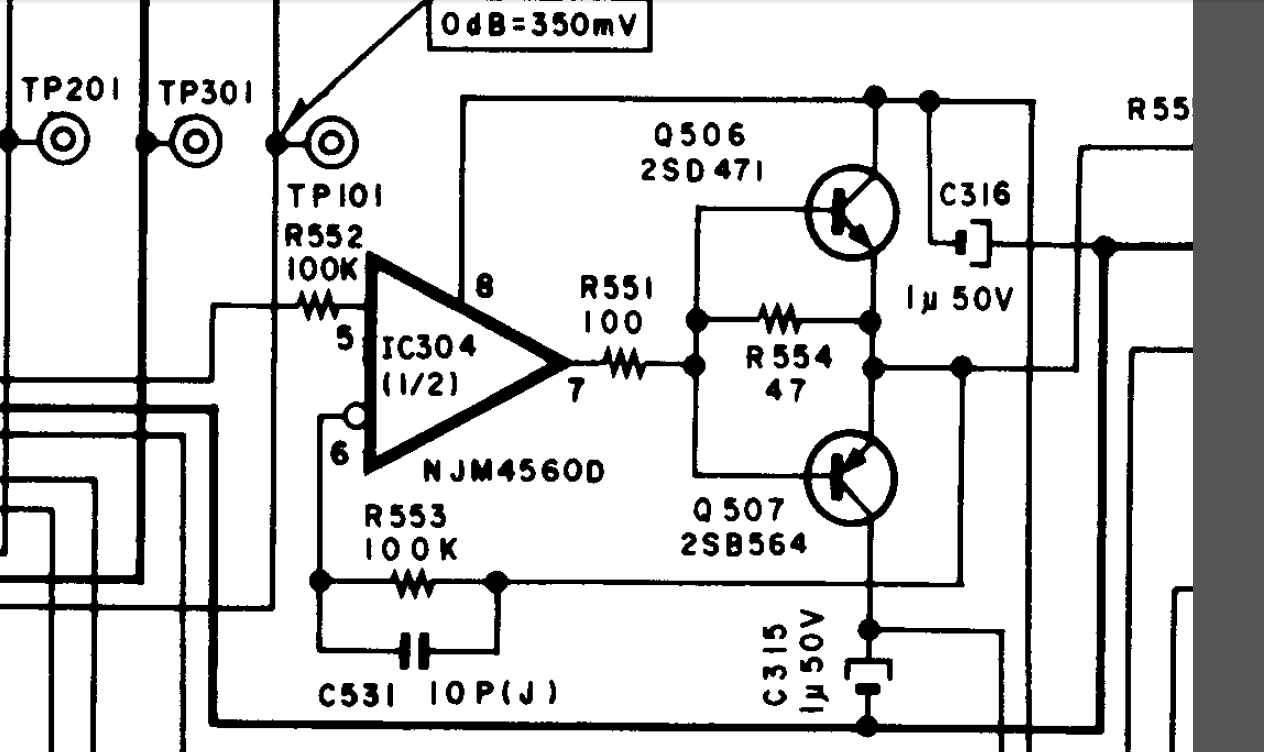

If ska-150 is not simple i wonder what's simpler at that kind of power except zeta 2...
for instance any schematic i am attaching ... Like the one i am attaching below ... that is simple 🙂
like the last one of the Nikko Alpha III recommended by one of the member of the design team at the times as one of the best sounding in the Nikko production (as an aside i had a alpha II ... one channel was not working properly because badly repaired ... but the one working fine was emitting a good sound. The Alpha III is much simpler design and supposedly sounds even better).
That amp that has changed completely my belief on op-amps And the opamp used it is very old.

The dreadful simple amplifier where it is believed that feedback can fix any distortion.
Here, it will not remove humongous crossover distortion.

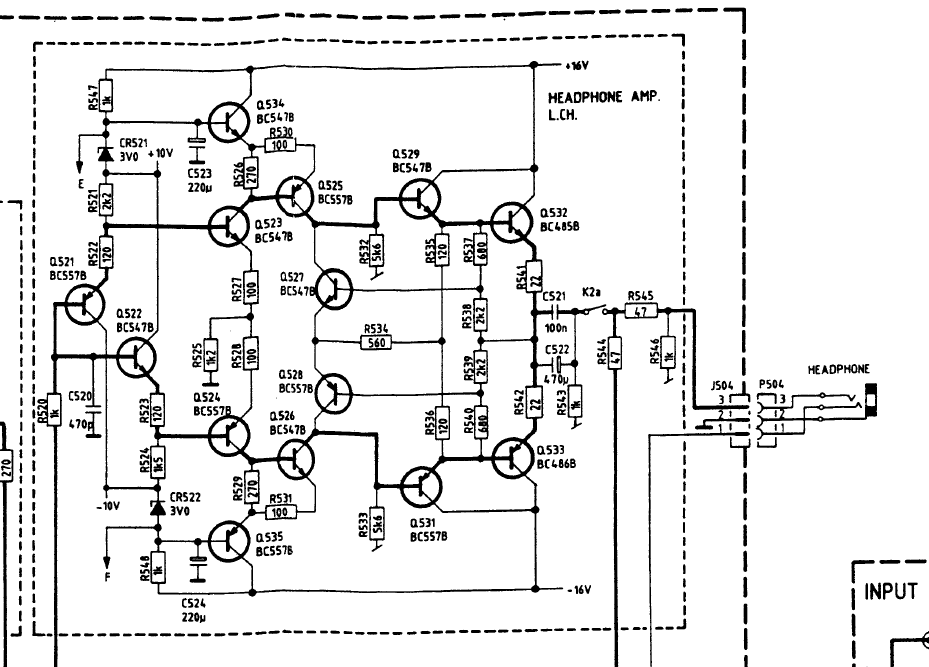

Look my friend! here's the Nakamichi Dragon headphones amplifier.Although a Nakamichi classic this was the worst ever sounding thing made by Nakamichi but it was only used for monitoring the recording level.Everybody else is using the line out for listening...

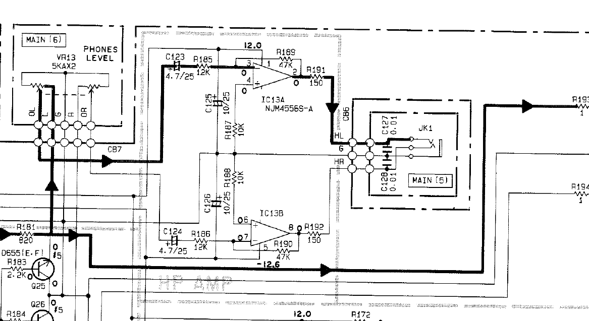

If you really want a good headphone amplifier Tandberg 3014 is the one.if you're curious about the prodigy child upstairs, go with Yamaha kx930 opamp variation.If you really want to know waht professionals use go with Studer A820 who's headphones amp is the industry standard.

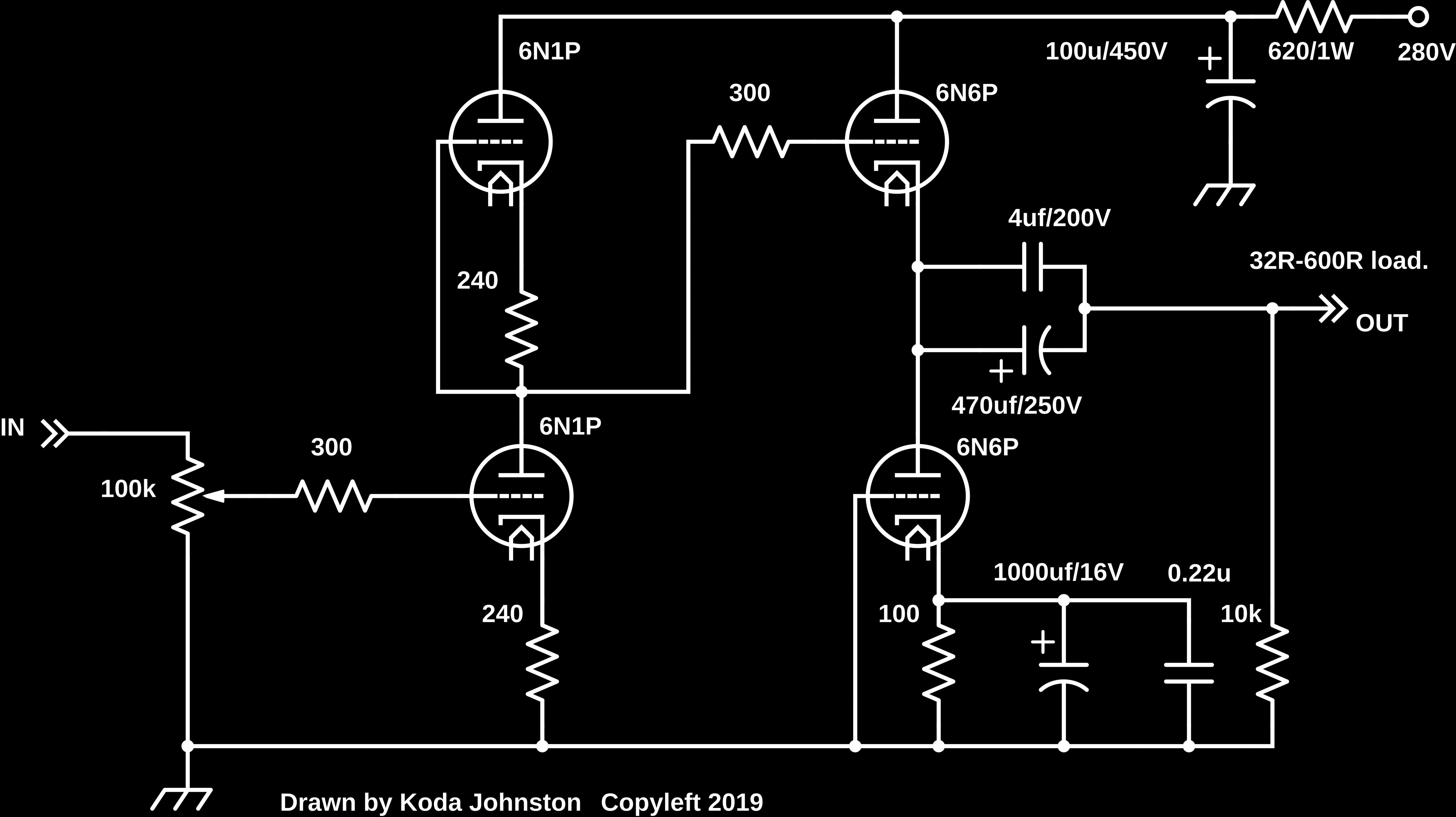

Wow... 14 active devices instead of the 4 I use... I wonder how the two circuits actually compare in real life? The OP of this thread: Any very good sounding tube headphone amp ideas ? seems to really like it a lot even though they are running lowZ phones and as said it's current limited.
My output is current limited to 20mA... Fine for highZ, fine for lowZ at lowVolume. Oh, and it's single ended.

I don't sell these commercially unless it's a "one off". I spread good designs on the net and other people are free to use them and adapt them as they see fit. Not sure where your use of the term "advertise" is coming from. I'm posting things I built through trial and error and found to be good designs, and I offer them FOR FREE to anyone who wants to use them, and in comparison to a 14 device transistor amp ripped from a commercial schematic (that YOU said was crap). I truly wonder which sounds better but I think I already know the answer. Please offer a circuit you designed though. I'd be very interested.
Really? Link an ad. I'll wait.
None of that design uses an SRPP. I suggest you read up on what makes SRPP work... There is ZERO push pull action in this circuit - it is entirely single ended. The first stage is common cathode coupled to a cathode follower... Both have "active loads".
You CAN use a single tube with a transformer, but this sounds better and costs less.
