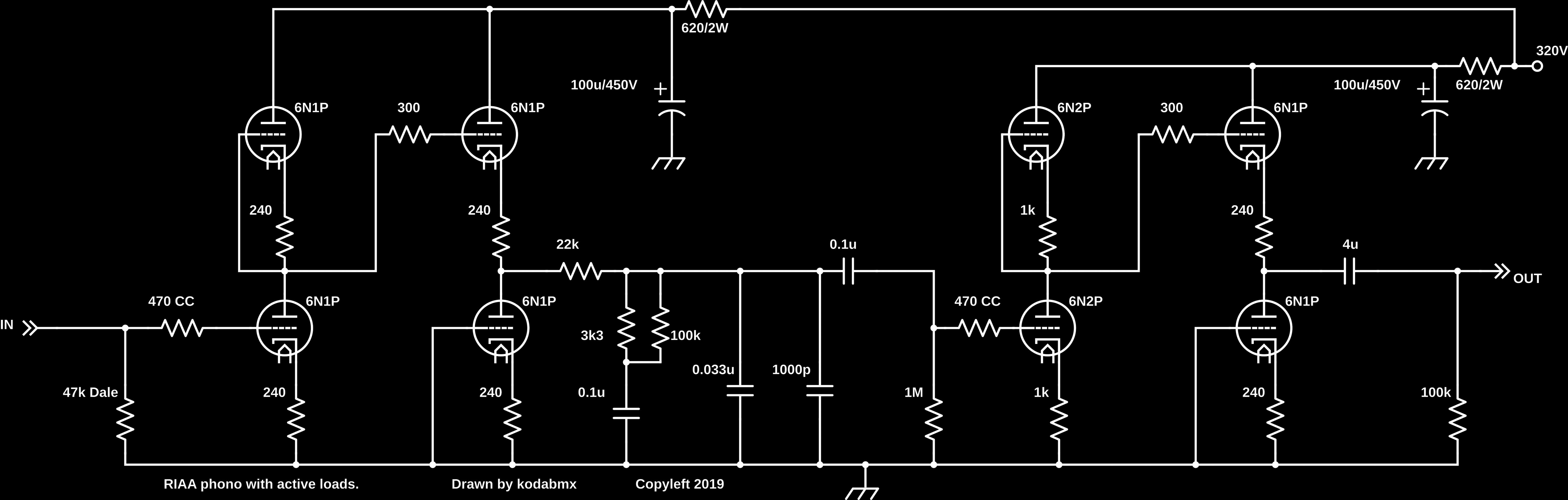

My take on an RIAA stage... Forgive me if I already posted it.

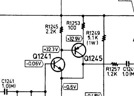

I am attaching what i mean
Since I have little knowledge of SS, I can only guess the NPN adds LOTs of gain, and the PNP works in anti-phase against it?
My knowledge is mostly limited to NPN type devices I'm afraid... I'm still learning about PNP -- I'm just starting to branch into SS from tubes.
How about this for an example of simple != better? Just saying, rearrange the parts (and vaules/voltages), and replace the 2N3904 with a 6SN7 and voila! Simple AND good 🙂

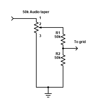

i see. Still companies produce and sell line stages ... i have to control the volume at some point in the chain. I just had issue with gain ... so i am thinking about the diy solution to set the gain as i like
Now as soon as i turn the knob the volume is always too high 🙁
Ok... post the schematic of _what you're using_ and we can see how to reduce gain...
Simplest is this though - the pot is the existing pot in the line stage:
Adjust R values as needed for SS. Probably just divide by 10.

good question. i understand that is a kind of NFB just thatI can only guess the NPN adds LOTs of gain, and the PNP works in anti-phase against it?
too high Zout maybe ? regarding single device stages i am fixed on the BOZ preamp by Nelson PassMy knowledge is mostly limited to NPN type devices I'm afraid... I'm still learning about PNP -- I'm just starting to branch into SS from tubes.

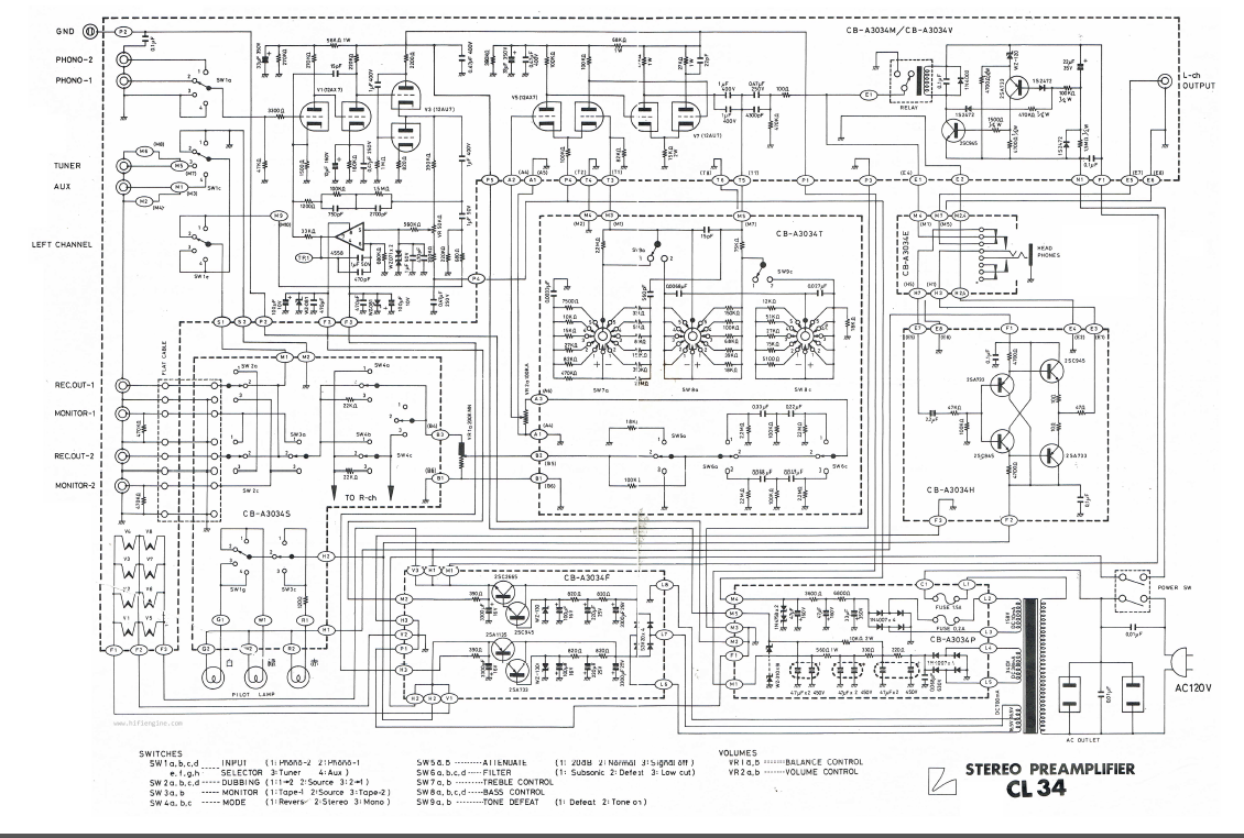

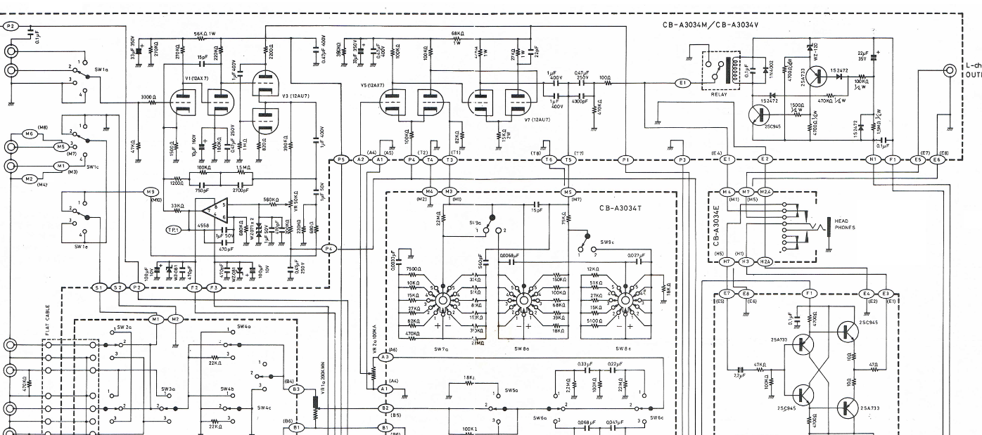

You riaa needs great care with heater noise and is also overengineered...NFB can correct errors, but isn't it better if there aren't errors in the first place? NFB has a certain speed to it. In theory, if there's a fast enough transient, NFB will correct it after it's already gone. I guess that comes down to slew rate etc.
Don't get me wrong - I use gNFB in all of my tube power amps, but I don't use gNFB in line/phono/headphones... Even my SE MOSFET amp has no gNFB loop in it. Just local FB because of unbypassed cathode resistors.
Compare it to luxman design and see what you don't really get about the feedback benefits! The headphones diamond buffer which is a discrete version of LH0002 is outside of any feedback network though...
I already built the most complicated hybrid phono designs with no global feedback, but using a huge amount of components to liniarize a valve preamp isn't really genious...
What heater noise? They run on the same 12V (15mV ripple) as the rest of the system... Also how is it over-engineered? The active loads seek to linearize the circuit as you said, but I don't see a lot of components. They also move waste heat above the chassis allowing for a smaller footprint..

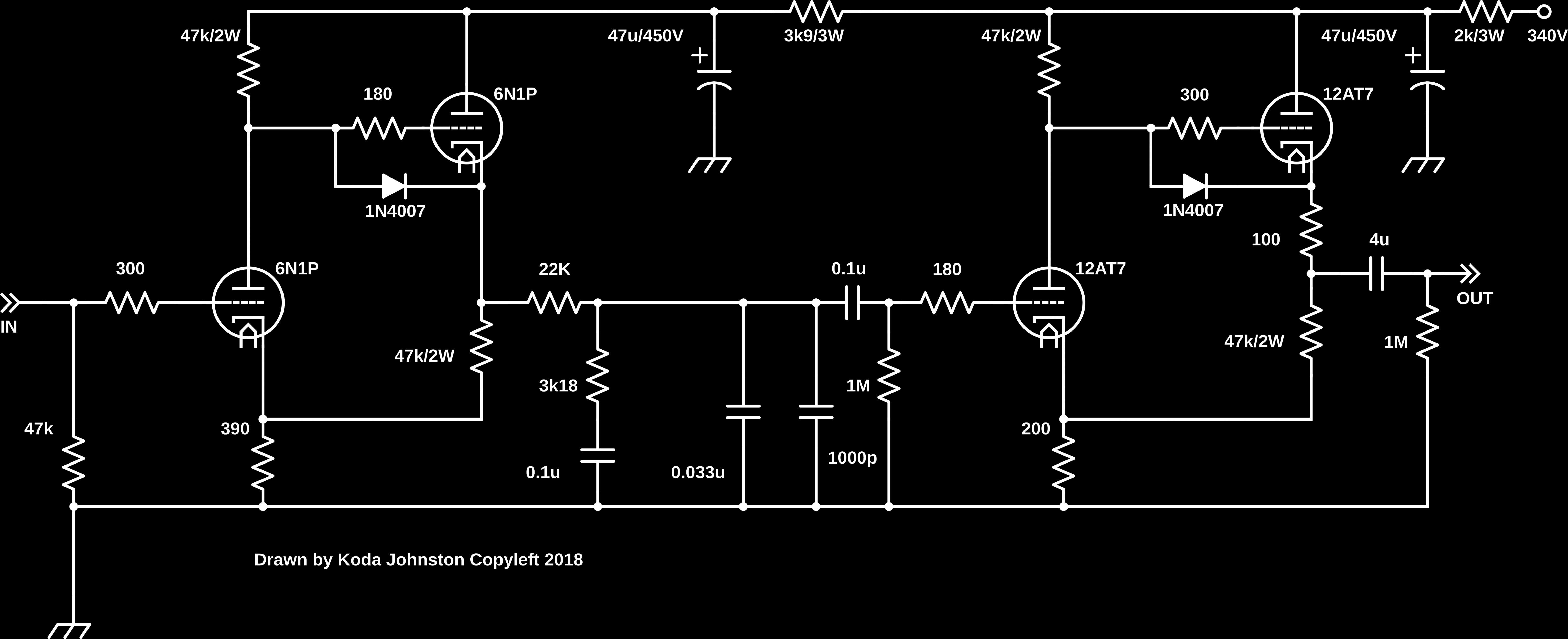

Would you prefer this?

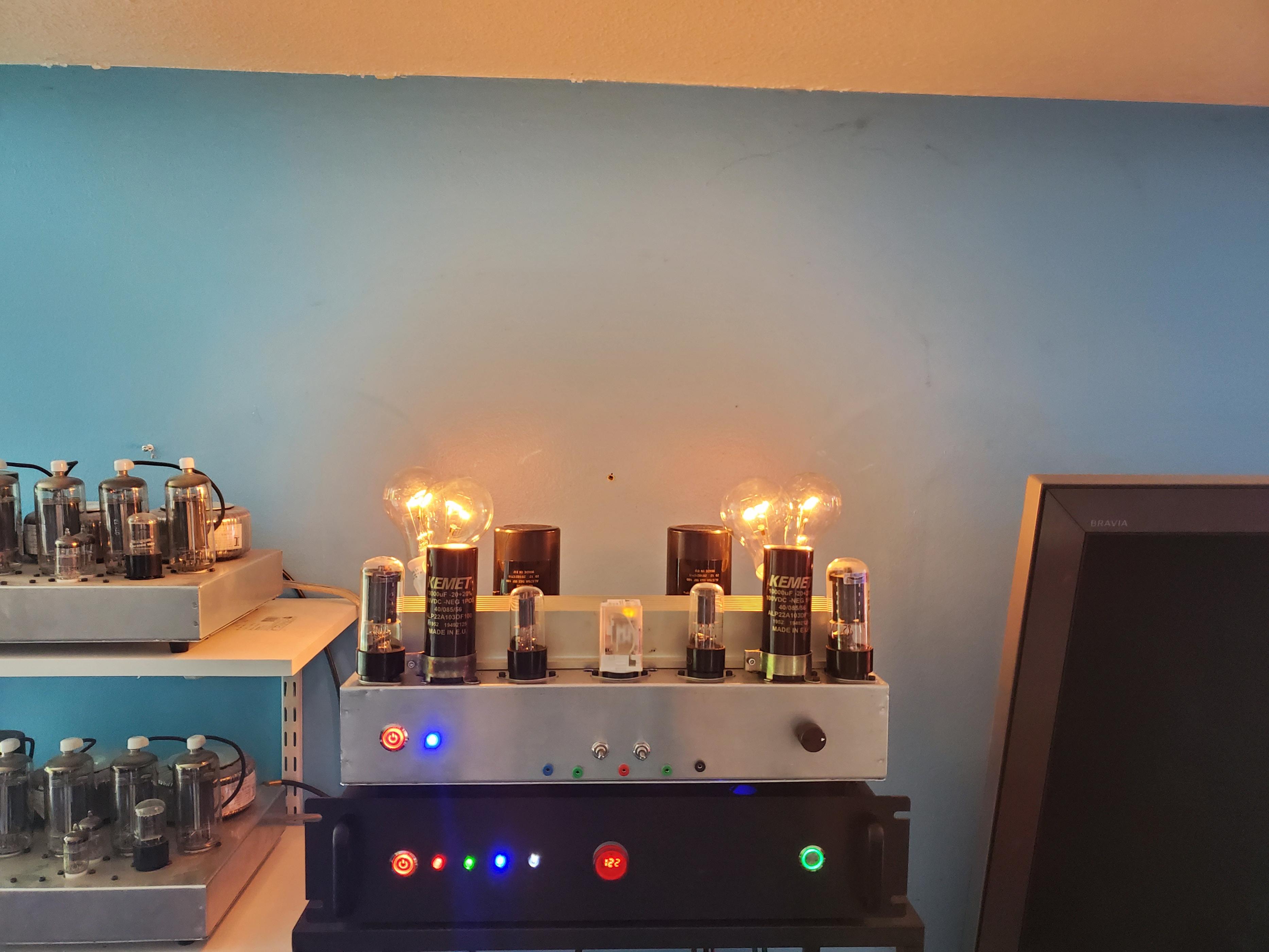

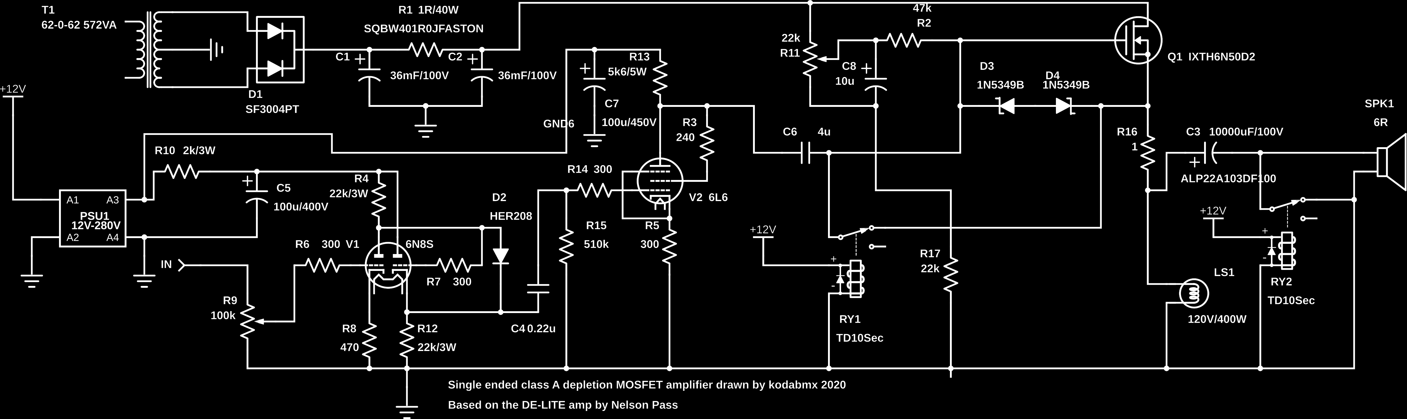

For your pleasure: I spoke about the SE MOSFET amp I'm listening to... Here's the recipe (schematic). Yes, LS1 is a pair of 200W incandescent light bulbs acting as the load resistance... It could be replaced with 18R/100W resistor, but more expensive that way. And this way you get free light!
there's no great benefit in reducing heater's ripple when the cathode -fillament current leak is in the order of picoamperes.The only way to escape filament noise entirely is to lift it above cathode potential by 30...50v depending on Vkf max to cancel that current leak.You can do that with the heater supplied by AC voltage with same results.What heater noise? They run on the same 12V (15mV ripple) as the rest of the system... Also how is it over-engineered? The active loads seek to linearize the circuit as you said, but I don't see a lot of components. They also move waste heat above the chassis allowing for a smaller footprint..
well that 1...10 picoampere leaking current is 100...1000 times lower than microamperes which is the gate bias current...so it's a -40 db...-60db noise superimposed on 0db signal...that's a lot!
