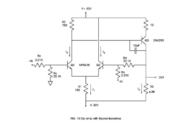

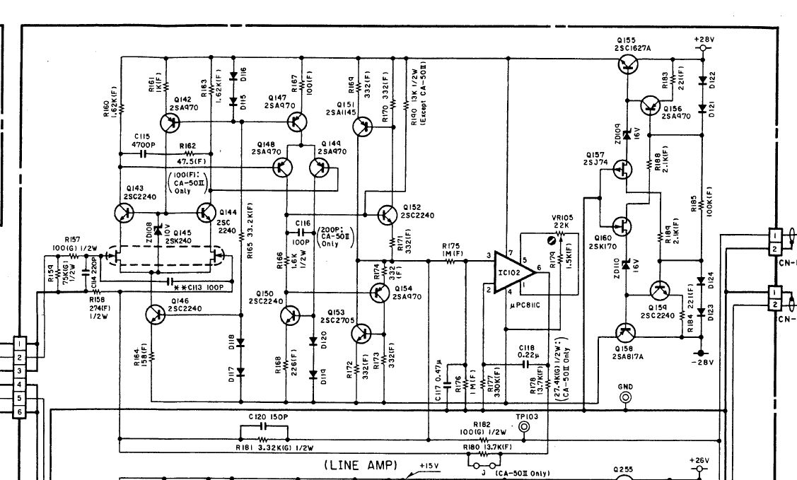

Hi and good morning. Before answering i would like to propose two schematics intended for the same purpose (i.e. line stage).
Same purpose quite different design approach ... which would be your pick ? 🙄

Thanks a lot I know that site very well. I will study the schematic you mention. Do you think that the design could be scaled down to serve as a high performance line stage ? maybe i have found what i am looking for

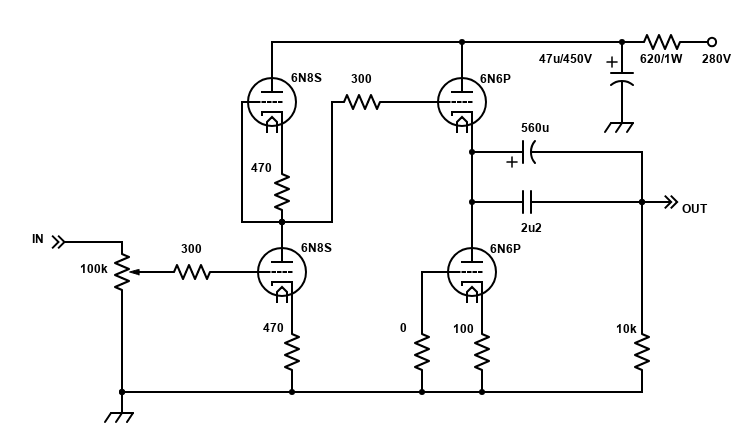

i am all ears ... requirements single supply 😱 few parts, V gain of 2-3 times, good driving ability to be usable with any power amp around
I like the BOZ but in my version (pot at the input) i understand the Zout is around 1kohm ? a little too high ? and also the stage gain is a little too high
For the gain i know that i could change some resistors and get a lower gain but the little high Zout issue persists.

An op-amp...
At the time when they launched these schematics there was no fet input op-amp with such dynamics and low noise as that NAk ca-50 circuit.It might still be better than most op-amps on the market if not all of them.
Could you please send me the ca-50II service manual on gopofirst@gmail.com? My country was banned 2...3 years ago by hifiengine for download or accessing their database and all the others ask for money.
Out of those two, I'd pick "Fig 10"

but I'd build it with triodes 🙂
why not go with an hybrid solution ? a tube and a fet buffer for instance ?
i understand fets have a very high Zin very convenient with tubes and their high Zout
Also coupling caps can be small value
One night i could not sleep ... i have this nightmare of a single tube (i love 12bh7 do not know why) followed by a ss buffer as a line stage
No reason you couldn't go hybrid I guess... Tube voltage gain, MOSFET current buffer. I would use triodes because they are cheaper than heatsinks and they are more linear than MOSFETs. I also have a thing for depletion mode parts because the can be "cathode biased" 🙂
But as a source follower, it doesn't seem to matter much -- I'm listening to a hybrid SE MOSFET amp right now that is set up as a source follower.

Having a second thought on that nakamichi...i think there;s no solid state replacement for what it does ...It's supply rails are probably +-20...22v to be able to accept the phono preamp output with no significant overload .Kenwood, Pioneer, Akai had such circuits working up to +_43v supply rails .Either way you still need soft clipping circuits to limit phono input max input overload cause you can't go with +-25v pk to pk signals into any power amplifier. Mpsa 18 circuit has a secret in its sleeve, mpsa18 , besides being a very fast transistor has the most pronounced quasi saturation behavior and it might an anti saturation circuit by itself .
A tube doesn't need a fet buffer, is way more linear than a fet , very high input impedance anyway .It might need a silicon bufer if it needs to feed a lower impedance than usual down the line, but most valves will handle silicon line inputs when wired as a unity gain cathode follower.I tried E282F, D3A, 6N6P in the past and i could drive 600 ohms headphones , not just line inputs...ECC83(12ax7) 6n1p , 6n2p, 12at7 , 6sn7, 6n7, 6n8 will do fine with line input.
