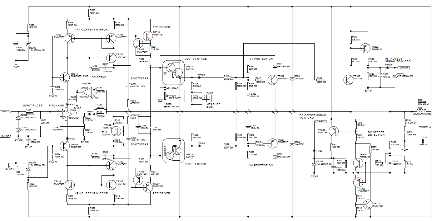

simple is always good, easier to debug.
i sometimes see 20+ transistors in an amp when 10 will do the job ok.
Yes that is my question. Or better i am very willing to accept the superiority of a more complex design if someone shows me some kind of instrumental evidence. Like lower distortion, better PSRR and so on.
But if a simpler design provides already great results ...
I am very interested in low open loop gain discrete op-amps and always looking for some comparisons between different designs.
One of the first i guess was the preamp module in the Mark Levinson JC2 line preamp ?
I had a great admiration for that preamp ... then i saw on Youtube a video were the original module was replaced by an op-amp ... for better performance 🙁
For sure the original module was more a minimalist design (see the video below at 2:02)

To replace 513 with 519 and 515 with 517.
Actually I think you want to leave out Q517-519 and have the signal output from Q513-515 ommitting the end-follower stage. Initially I thought you wanted to connect Q517-519 to Q501-505 directly. That won't work.
Apart from the bias components (D509, R523, C505), the signal is there already (midpoint of Q513-515) indeed and can be used by an high impedance load (*). If the feedback network is connected from there, the load is some 21k and will have impact on the open loop gain. Any other load will change this too and that is the reason to add an output buffer (Q517-519) - it is a commercial amp so reliability is important.
Further simplification without to much degredation can be done by replacing the current sources (Q511-509) with resistors. Also the differential can be replaced by singel transistors - a different stabilisation and biasing is needed however. The small FET-input Hiraga is such a design. Ultimately you can use one transistor for the amplification as an example of minimal engineering.
(*): If there was a transistor (or any other device) with a low output impedance on its collector (or drain or whatever), the 'classic' output stage becomes unneccessary. With tubes this is a triode, with semi's this is a SIT (see the Pass section on this platform). Alas single polarity ('N-channel') only.
Unless...

Hi ! yes i see two options.
  1. Using Q513-515 as output stage and adjusting the circuit accordingly.
  2. To put 519 at the place of the 513 and the 517 in place of 515.
thanks a lot. So the original schematic is more reliable and maybe even better performing in terms of distortion and driving ability. No more questions then. I will keep my ravings inside my mind. 😱
this was another doubt of mine. So you say that using simple resistors will not have a sensible negative impact on performance ? good !

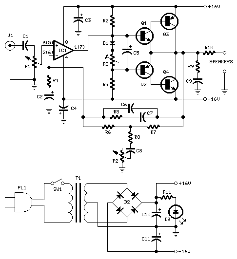

I spent a lot of time with Op-amps in my youth. 🙂
Marvellous things if you didn't expect a lot of power from them. The NE 5534 and TL-074 were just superb as pre-amps.
But try and get them to drive a pair of loudspeakers and you ran into all sorts of problems.
Mostly feedback stability.
This is no surprise. Look into the internal circuitry, often you will find 2 or 3 voltage amplifying stages that you cannot compensate externally. This makes op-amps in-attractive as error amps in closed loop power amps.
