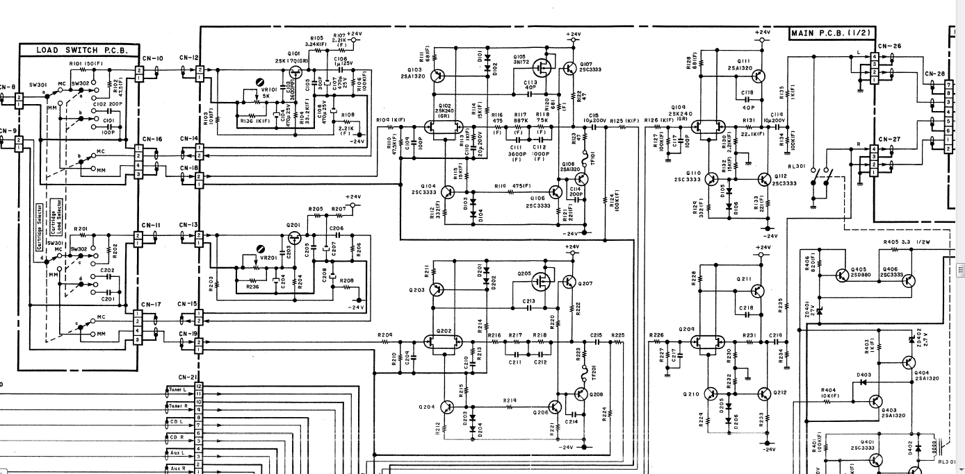

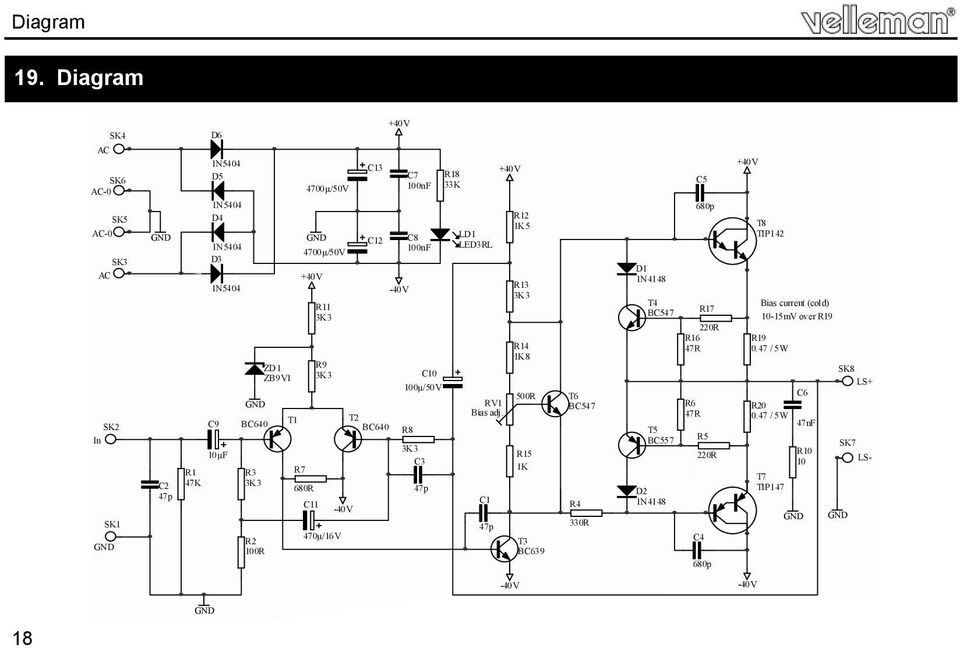

Anyway ... i understand that darlington transistors could allow for simpler schematic. Then i see how neglected they are. Is there a love for complexity around ? i attach a very simple schematic for an amp ... tube schematics aside i think it would be very difficult to find something more minimalist

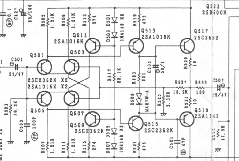

Why designers do not love darlington ? to be fair british designers used them often in very good sounding unit. I remember a cottage brand Albarry doing very nice things with TIPxxxs.
Could 513 and 515 be replaced with a darlington pair and be done with that closing there the FB loop ? just asking ... 😱
as long as good figures are obtained ...

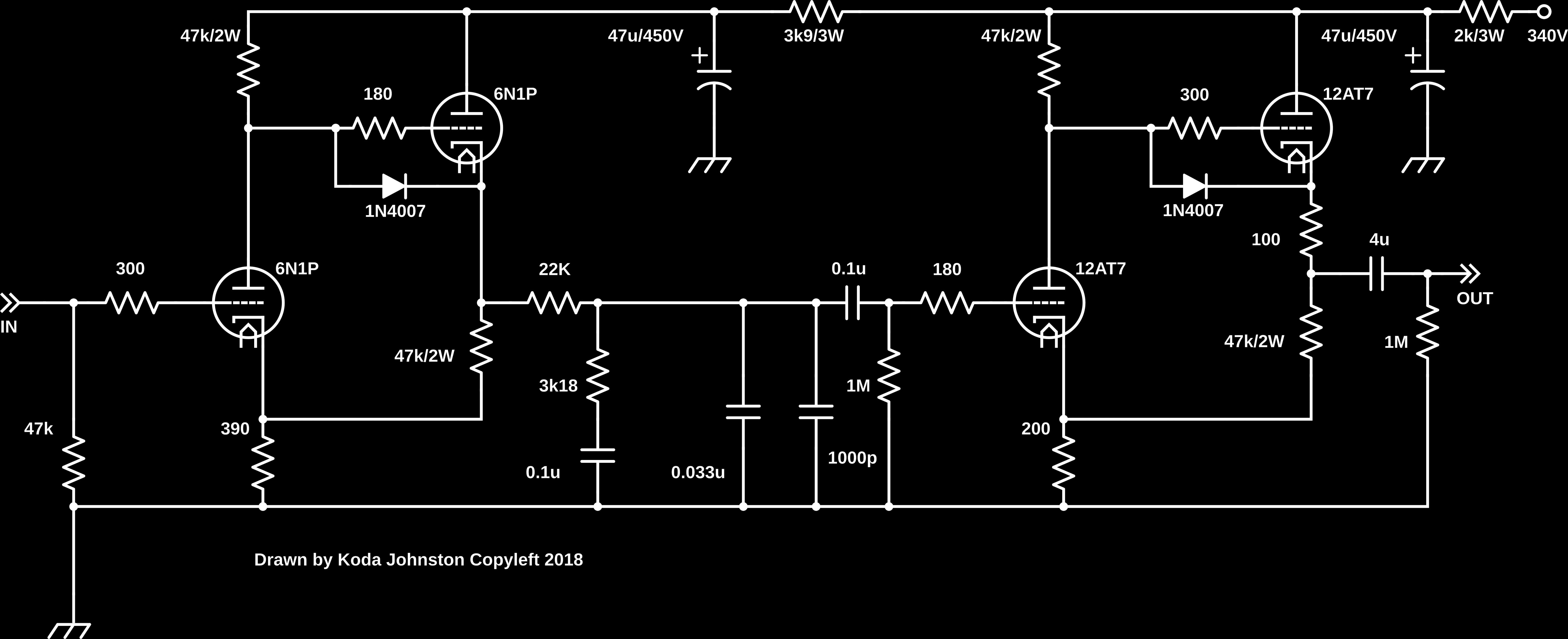

Is this a topic about the benefits of ADHD applied to electronics? Those two schematics are completely different both in outcome and composition...

darlington transistors need on chip thermal tracking to be able to work reliably .There are very few high speed power darlingtons, most of them unavailable.

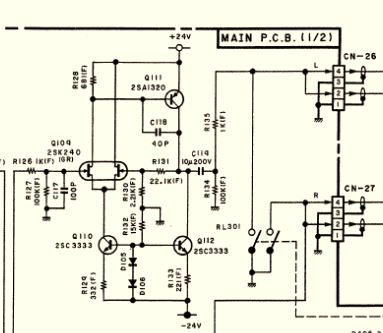

the problem is that you made the worst choice to prove your theory when showing the Rotel's circuit...I may be that the circuit itself is a complete waste within the amp's economy , i didn't study your rotel, but the circuit itself is very well put together.
I can't believe you chose the most minimalist Nelson Pass phono preamp design to prove further your theory...Man...that is the most genious phono preamp ever made.Nobody ever had better results with lower component count.Tell me that this is not only overengineering but more perverted engineering , engineering slaved to the market evil

darlington transistors need on chip thermal tracking to be able to work reliably. There are very few high speed power darlingtons, most of them unavailable.
Thanks ! i understand now that there are real reasons to avoid them. I just asked because years ago they were quite common in some british integrated that happened to sound also very nice. But i have very limited direct experience of these amps. Maybe they were problematic

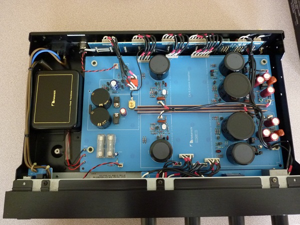

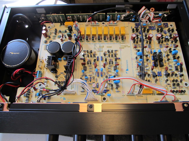

Again speaking of the Naka the line stage is that in the center of the board.
It looks very crowded with components to me ... too much maybe ? yes. 😱
I immensely prefer the one i am attaching ... actually i thought mine were that one. Wrong buy. I love the one in the attachement a very lot. And when i say a lot ... if i find one not too expensive i will get it
But also that must have a gain of 6 ... too much for me.
you have the first version, the ca-5, the previous photo was ca 5eII or ca-7 i think...not sure about that.ca 7 had a lot more components but ca-5 was just fresh air in the phono preamp world .still is...There are lots of guys or companies that think they can do better than nakamichi, but nothing proved that over time.
Yes ! i got confused with the model number. To call them model 5, model 6 and model 7 was too elementary ... even trivial. And then i made a wrong buy. Actually i was looking for the more "minimalist" one ... of course.

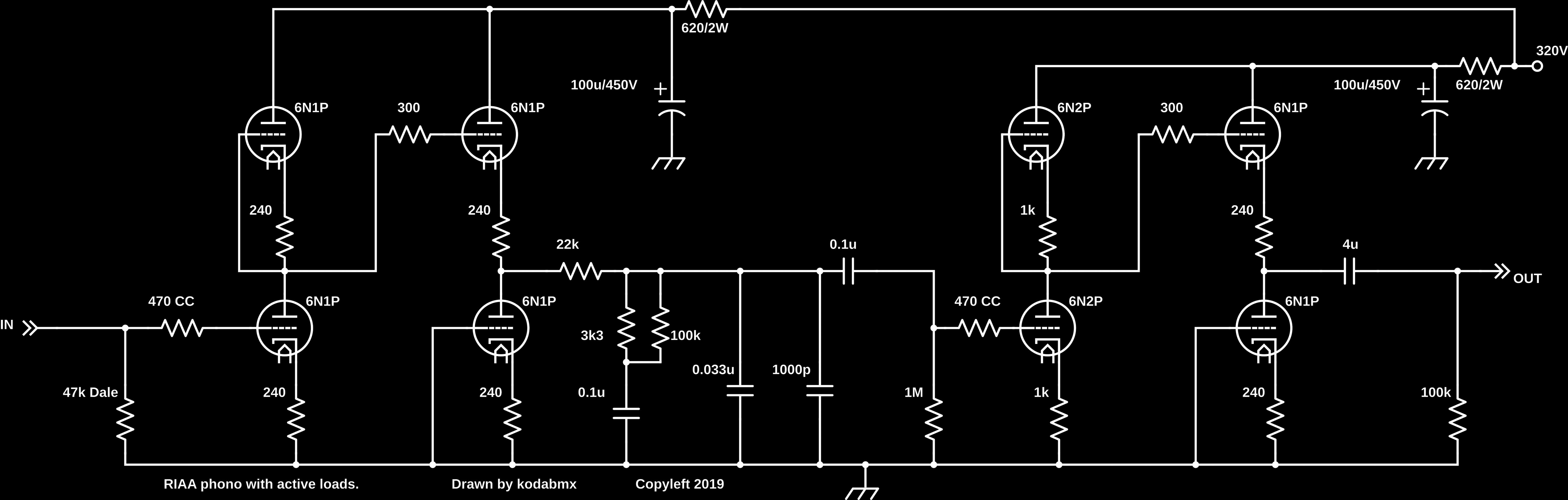

Admittedly, I don't use solid state very often at all but here are two phono stages that both work very well with low parts count. The second is my version of Broskies' CCDA.
I wasn't talking about valve based phono preamps, that's just another world ...i designed some myself...other than that, without using an input transformer i can't see your circuit good enough for MC and 6n1p is not D3A , E810F or EC8020...
They are both for MM. MC with either a change of the first tube to 6N2P, the addition of a JFET input or as you said a transformer.
If I were to go SS, I'd just replace the two tube stages with two opamps. Simple, cheap, and fits in a cigarette pack.
