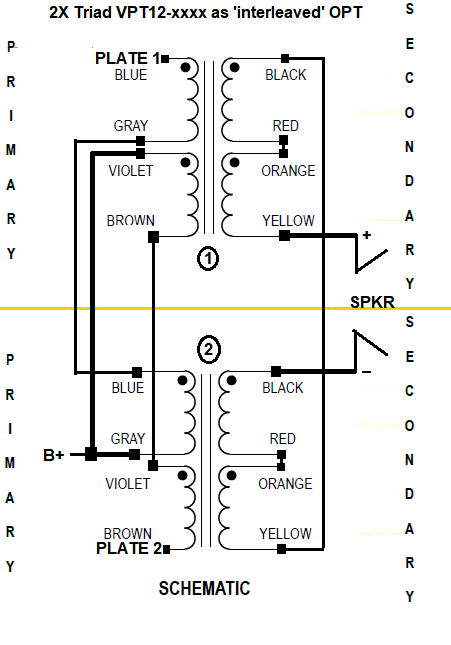

I was looking at availability of the Triad VPT230 xfmrs. They're readily available from Mouser. However, all I can find with this number are 2:1/1:2 isolation transformers (115/230V primary:115/230V secondary). I can't find any that are 230V:12V or 115:6V. How are the inductances of the VPT230 xfmrs relevant to the Triad toroids used as OPT?

I've used VPT series as OPTs with the following tubes: 6N13S PPP (VPT48--), 6P1P PPPP triode (VPT12||), KT120 triode (VPT18--), EL34 PP (VPT18--) regulated screens, 6P43P PP (VPT12||) triode, 6P3S PP (VPT12--) tetrode, and a 12AV5 PP triode, (VPT12||) all with excellent results. (-- = secondaries in series, || = parallel)
For PP 6P43P, what VA for VPT12|| did you use? 25VA? 50VA? 100VA?
For PP 12AV5-triode. what VA did you choose?

My go to is 100VA because Arrow has then for a good price, a set of 25VA will work fine with 6P43P.
I've used 50VA with the 12AV5, too. Again my go to is the 100VA.
My largest amps use a pair of 250VA per channel though.
How else can you build a stereo amp with good sound with only spending ~100$ on OPTs?

Can you share some info about this 2-OPT scheme?
Is it for larger primary inductance? Does that create a problem with dc resistance?
Does it work with larger power PP amps? Like 50-100W?
Do you stack the toroids on top of each other to keep the footprint small? Does that create any electrical/magnetic issues? Do they get hot?
Does the pairing make a difference? I mean, using the windings from trafo A as the "outers" and trafo B as the "inners" vs the windings fom A as one "outer" and one "inner"?
You get more inductance. The DCR of even a pair of 25VA coils is still lower than the DCR of a normal OPT.
Yes, it works with higher power. My monoblocs make 113W RMS @ 30 Hz using a pair of 250VA coils (Primary DCR is only 12R across both coils)
I stack them to save space. They are both used as one so it doesn't matter RE: coupling. I wouldn't stack the OPT on the power transformer though 😀
It doesn't matter as long as they are in order.
The way I connect them is as follows:
Y=yellow
K=black
BR=brown
BL=blue
P=purple
G=grey
O=orange
R=red
1=coil 1
2=coil 2
Y1 - Speaker positive
BL1 - Plate 1
P1, G2 - B+
BR2 - Plate 2
BR1 - P2
G1 - BL2
K1 - Y2
K2 - Speaker negative
R1 - O1
R2 - O2
This will connect everything in the right order electrically and magnetically.
I can't believe I have that memorized now!
EDIT: They get as warm as the chassis they are bolted to. They generally don't heat much from operation since the DCR is so low.

I copied the schematic from the VPT12-8330 data sheet and drew in the connections you described above, then attached that drawing to this message. Does it look correct?
