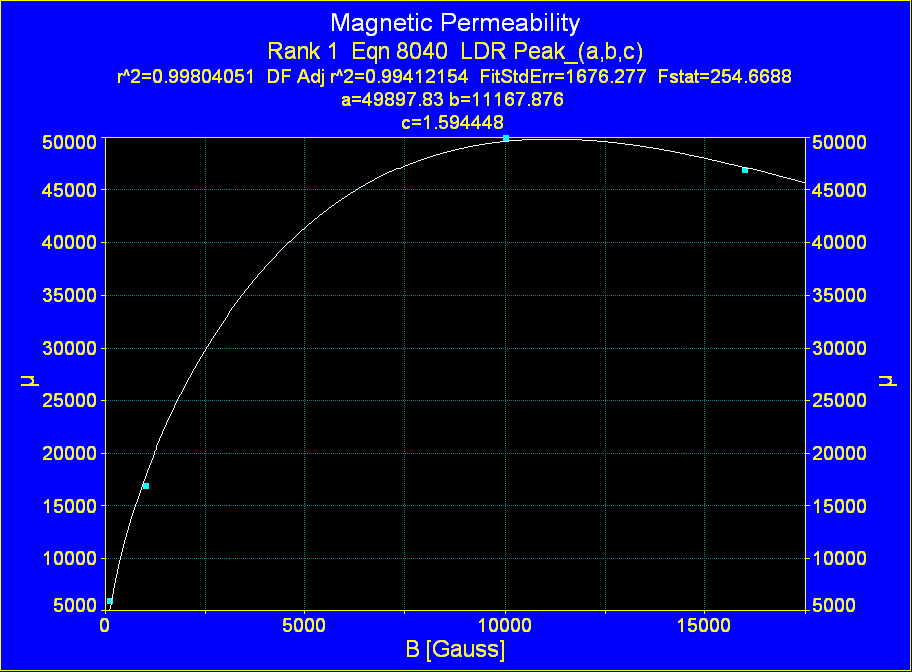

Inductance does not depend on VP-P. Indeed… you'll get the same inductance reading from a transformer's coils whether you excite it with a 10 millivolt or a 10 volt signal.
No, this is wrong, in PP transformers magnetic permeability and hence primary inductance depends on magnetic field applied, which in turn depends on applied voltage.
In the attachment you can see a graph made with measured values of EDCOR M6 lamination.
Primary inductance should have the same shape.
NO MATH, just measurements and a graph...

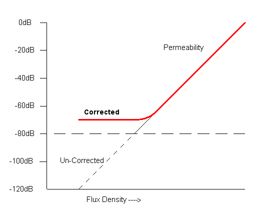

The Edcor M-6 permeability graph is interesting. One worrisome aspect is the apparent continuing drop in permeability below 5000 Mu at the low end. (notice small gap in curve on left) Although Bozorth's 3% Silicon steel graph shows just a factor of 10 drop in Mu going down to zero flux.

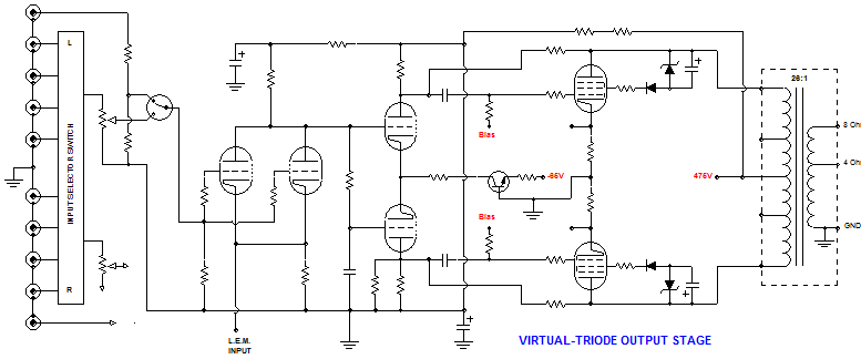

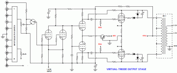

The LEM (Linearity Enhancement Module) graph seems to indicate a LOT more drop off!! If that's really the case, I could see some point in using the HF bias scheme (used in the LEM module)

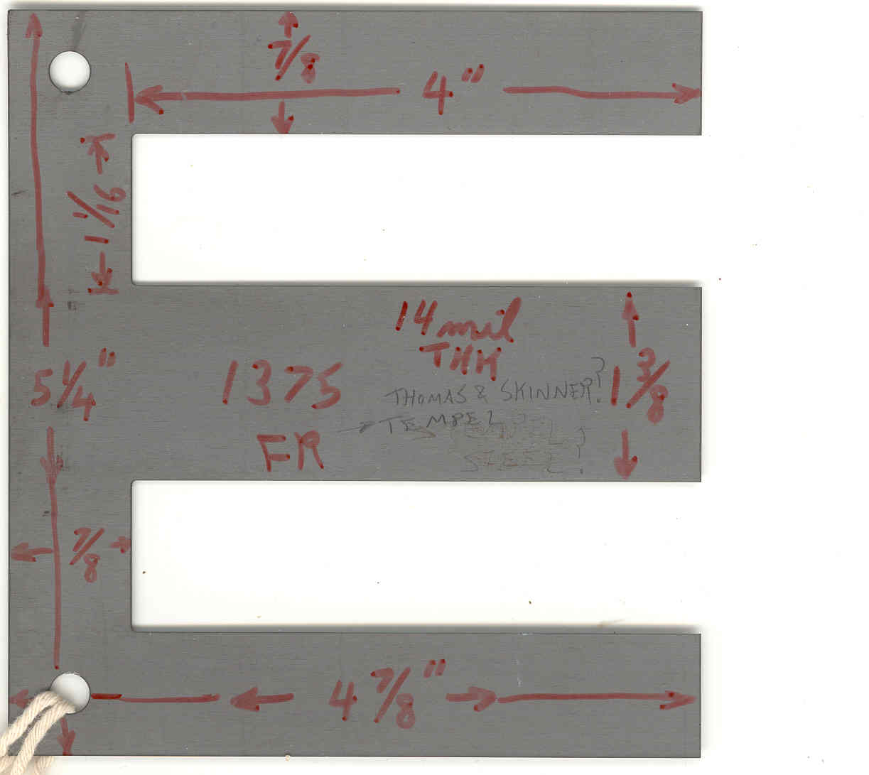

Also, long E laminations could be used to put two conventional (industrial xfmr pre-wound) bobbins onto one core, doubling the primary turns available. Secondaries could be paralleled. Making for a low cost OT alternative. (Lamination pic is of Thomas & Skinner lamination # EI-1 3/8 LSW )

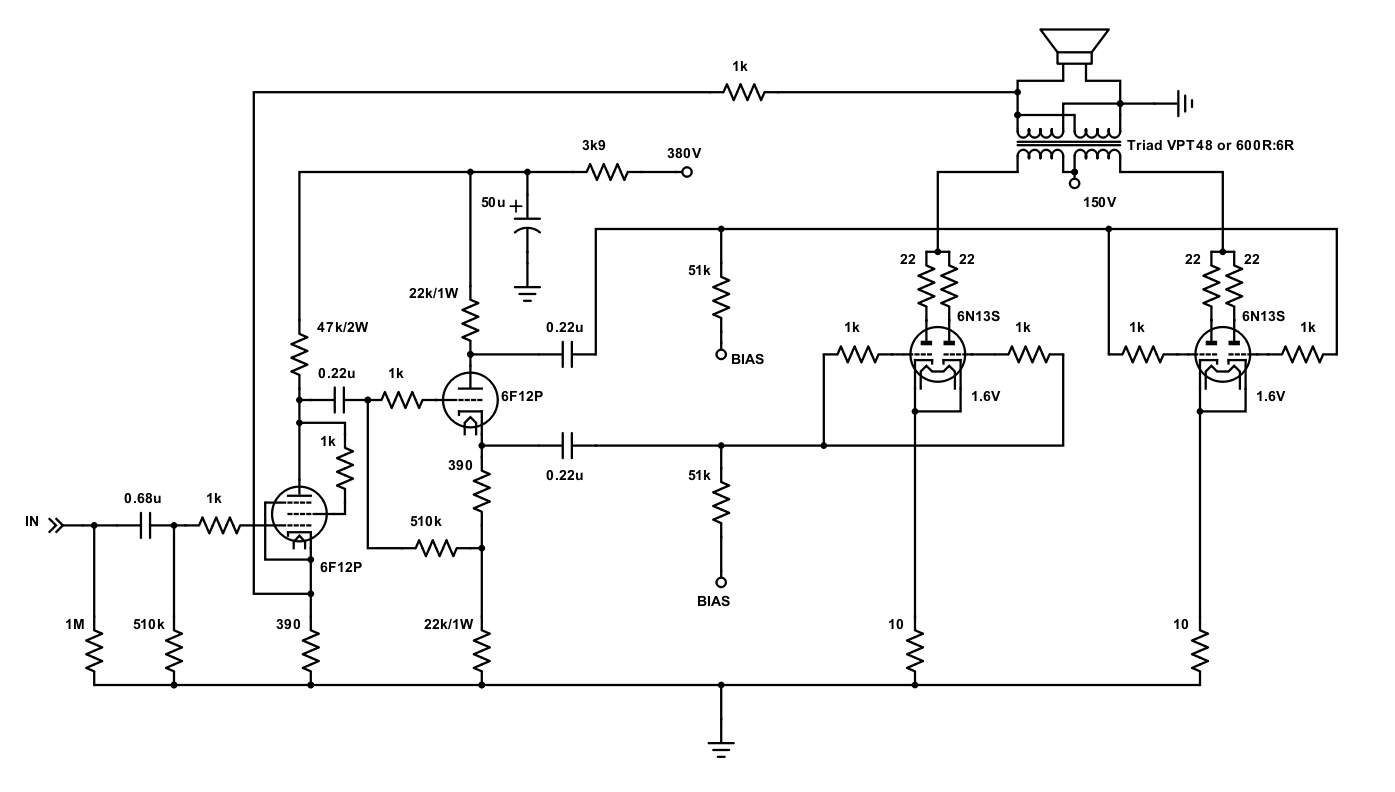

Did you actually physically try it? Or are you basing that opinion on something unrelated to physically trying it?Valve amplifiers overall quality depend mostly on its OPTs, using toroidal PTs is an interesting experiment, but my conclusion is thumbs down.
My opinion is shared by others here, the results are excellent. The oscilloscope traces are cleaner than the Hammond 1650N I was using as a baseline. I posted traces earlier in this thread. including a clean sinewave at 125kHz.

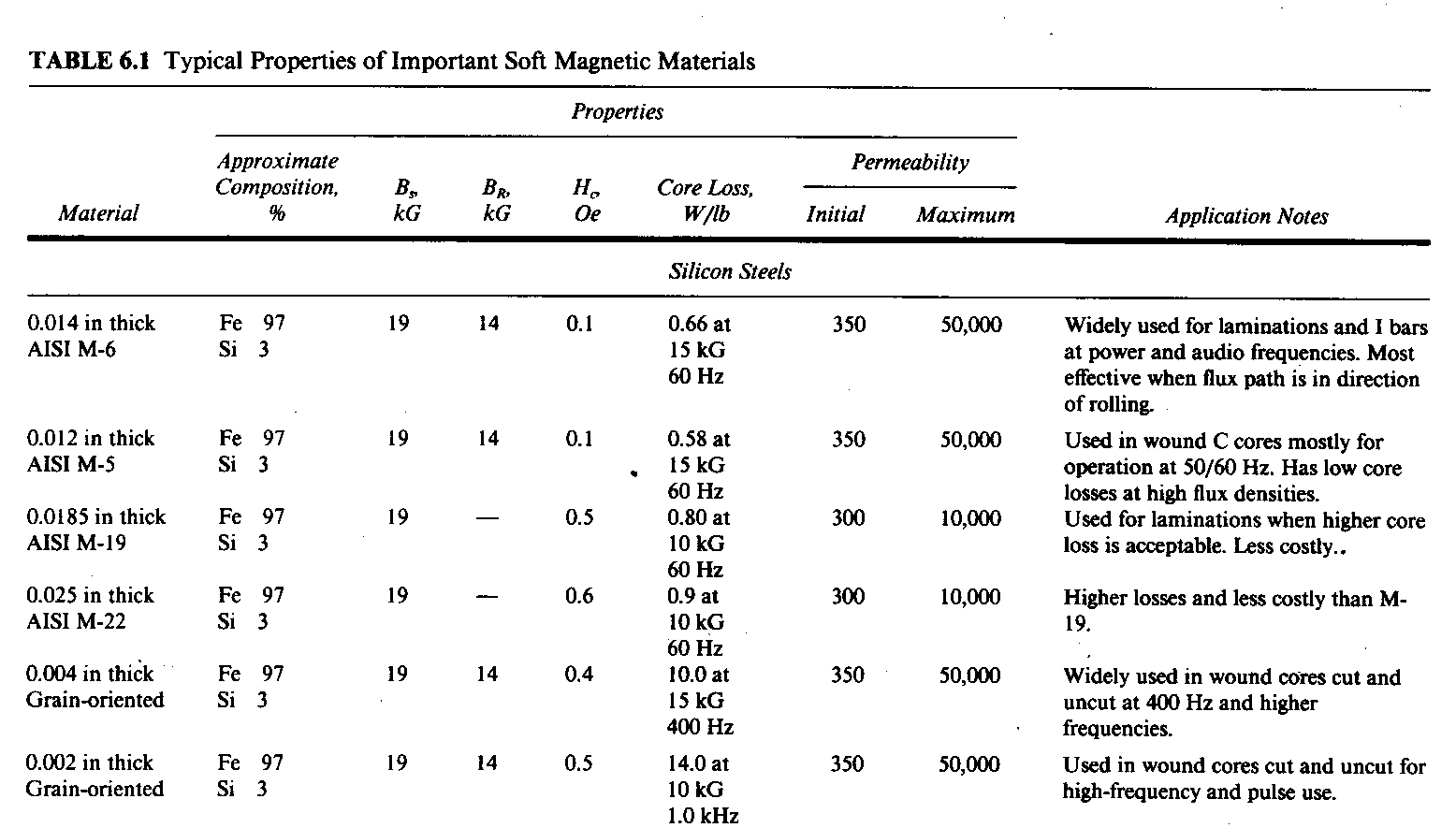

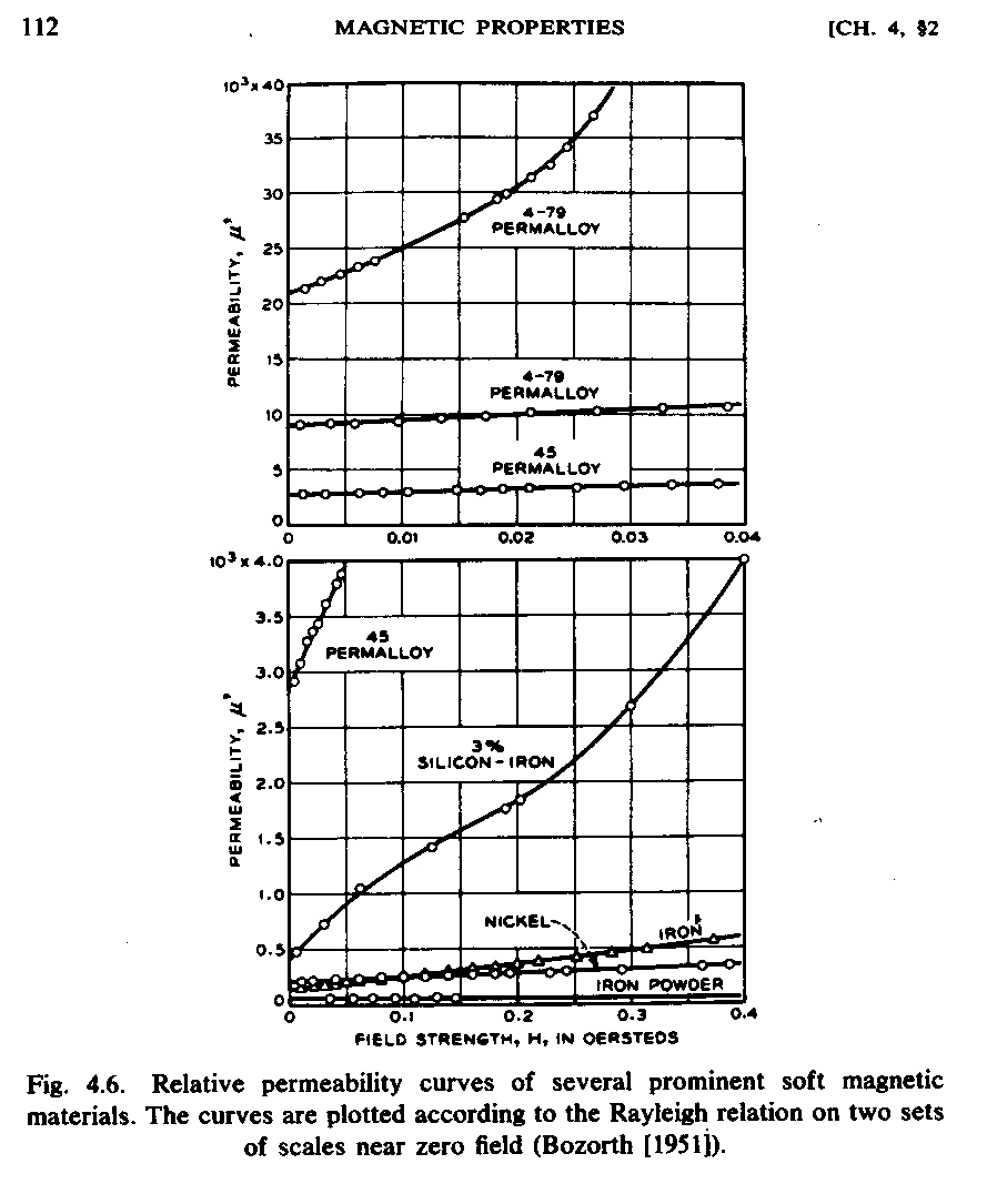

The Bozorth 3% Silicon steel Mu graph starts at 4000 Mu and drops to 400 Mu at zero flux. (so filling in the small gap in the M-6 graph from Edcor, left corner) So that would be a total 100 X drop in Mu down to zero flux !! Apparently that (horrific) LEM Mu graph is for real.
Initial Mu Table: 50,000 Mu down to 350 initial Mu here (below):
So if these toroids are measuring 200 H at max voltage, that would be less than 2 H at tiny audio levels.
No more low level Bass detail.
That LEM module is looking kinda useful now. Just need enough HF to reach 100 gauss.
Low Mu OT material, at low signal, just means more magnetizing current of course. So the output Z of the tubes needs to be able to produce 100 Gauss in the OT without significant Voltage distortion (low Zout). That's about 1% of max signal current (1/100 of 10,000 Gauss max) demanded to fix the core material deficiency. N Fdbk would do the job too.
The LEM thing can be done using a double Op Amp., so is probably of similar effort to using some local N Fdbks on the output tubes.

I think it has to do with the winding ratio being lower, and the low Zout of the power tubes but I'm no expert. All I know is this design makes 6W RMS sine, and more for music, using 25VA $37CAD coils... It's also powered from 12V using DC boost converters. At 1W output the frequency response is +-1db 6Hz-125Khz sine.
