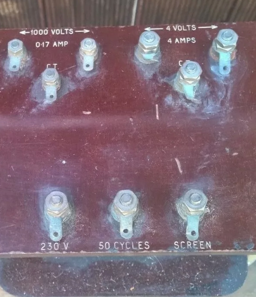

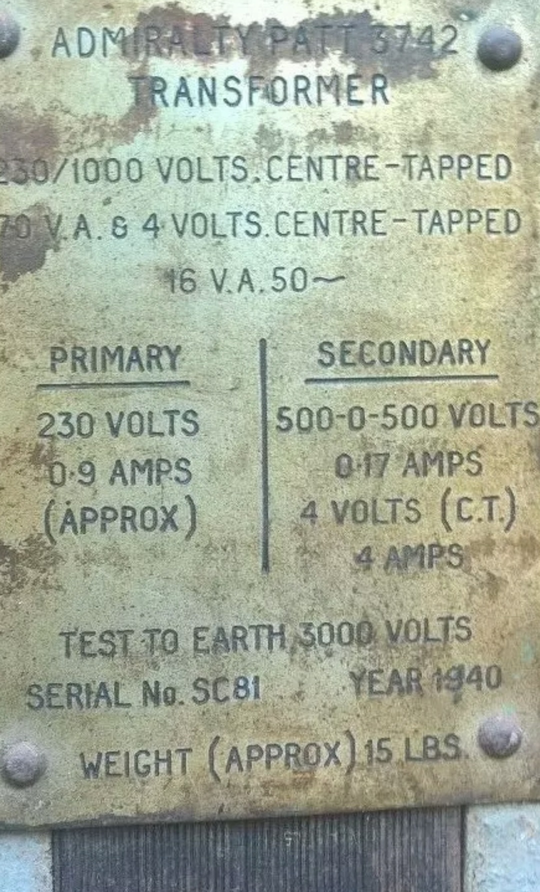

f I have an input transformer that has a 1000V/170mA winding with a centre tap. Does that mean I can do 2 x 500V supplies to a stereo amp and feed them each a rectified 500V/85mA into the CT of the OPT? Am I correct in assuming the mA drops with the voltage?
Pictures of exact transformer attached for clarification

No you can only simply generate a single B+ dc output with a V-0-V secondary winding.
The 170mA rating relates to the AC rms current of the winding. You can estimate the winding rms current required for a given dc load on the generated B+ voltage and rectifier/filter using the software PSUD2. It would be well worth your while to read all the help notes etc for that program as a learning curve.
The 4Vac 4A heater winding and early date of 1940 indicates it was used with early audio valves like the MHL4 and PX4, but there only appears to be one 4V winding so that is a concern as that wouldn't allow a rectifier tube like a MU14 - but heh, it's not 1940 🙂

The 500-0-500 would have been aimed at choke input filter along with a vacuum tube rectifier (which needs the V-0-V format as they can't easily be used to full-wave rectifier a single V winding). The voltage drop of the rectifier, and the choke input, would have generated something like a 400Vdc B+ supply.
But nowadays it is not common to use a 500-0-500V secondary, as it generates a relatively high DCV (with ss diodes and capacitor input) that is beyond what most output stage tubes can handle, and is best used for high power amps that are likely too high in power for most.

The point of the 2X CT winding is to use a two diode full wave, using the center tap to ground. You can get a full wave rectifier with a single dual-diode valve and only one heater winding. If silicon diodes are available, you can think outside of that box. But in 1940 no one did.
If you don’t use the CT you get 1000. You could get 500 and 1000 by connecting to the CT for the 500 volt tap with a full wave (4 diode bridge), and there are cases when such would be useful. But not for your typical beginner project. A SET using transmitting triodes, with the front end running off lower voltage, for instance. Shocking, for sure. Dangerous voltage, and the tubes and required high Z output trafos would send you into sticker shock. And output power is still limited by the power trafo.

A 0-500V secondary and a 4 diode bridge gives about 707V at the cap input filter.
A 500-0-500V secondary and 2 diodes gives about 707V at the cap input filter.
There are more wire turns in the 500-0-500 secondary, versus the 0-500V secondary.
To get the same DC load current, the cross section Area of the 0-500 secondary needs to be 2X the cross section Area of the 500-0-500 secondary.
