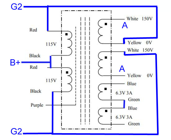

Here is another possibility, which has the added benefit of possible UL operation. By using 4 different high voltage windings it may have enough inductance in a single OPT.
This is Antek AS-1T150 but there are several others with different high voltage secondaries so you can get a range of impedance ratios.
Has anybody tried this?

The only off the shelf transformer that I’ve found that could potentially be “abused” that way at that much B+ is the Antek 15T950. Using the 120v primary for the speaker. 1k a-a at 4 ohms, 2k at 8 ohms. Since it is designed to be nominally 1900 VCT it should be able to take that kind of voltage. It looks like it’s physical construction is two independent bifilar would 2x475V windings, according to the hookup diagram printed on it. Since it is hard wired to give two CT windings, it is not possible to interleave the two sets of windings - nor would that even be advised at these voltages if you could. It would give 50% UL taps, if you could make use of it. I doubt some crazy transmitting tube would work well in UL, and for sweeps it’s out of the question. A big bank of KT88’s maybe.
The 8T800 could be used similarly, but at much lower B+. The Ra-a is even lower, and ultimately the *current rating* of the winding will limit your max power and useable B+. And no UL taps. It could do 350 watts, at maybe 500 volts tops. For use with sweep tubes operating at high peak Ik and low B+ it’s a possibility.
