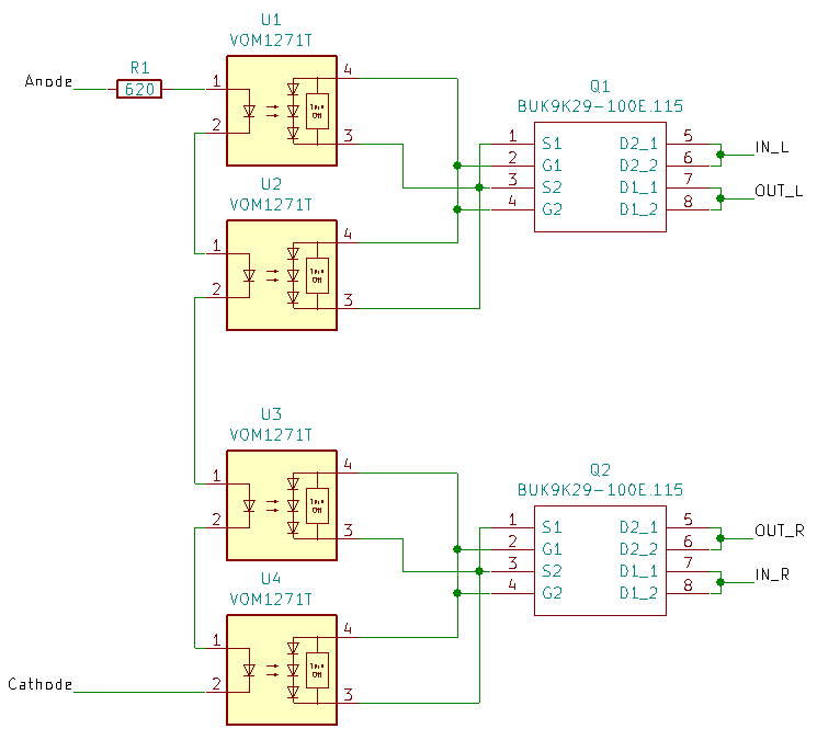

I am going to use VOM1271 and BUK9K29-100, is this schematic OK?
First, what are you using it for, and how much current are you driving the VOM1271 LEDs with?
Second, lose the 10 meg resistor, the VOM1271 has its' own built-in turn off circuitry, the resistor will degrade switching time which is important for minimizing the power dissipation in the MOSFET(s).
Third, I recommend you parallel the MOSFET driver outputs rather than series, more drive current will switch the MOSFET(s) faster.
Mike
This will be used for speakers. The source voltage is 12V, I am driving LEDs in series with a 300R/1W resistor, LEDs current is supposed to be 21mA @1.4V LED forward voltage which yields an output voltage of 8.7V to drive the MOSFETs.
Looking at BUK9K29-100 datasheet, the required Vgs is 10V to fully open these treansistors, this is why I used a series config, is 8.7V okay with these transistors?
Does "parallel the MOSFET driver outputs" also works well for the drivers that have turn-off function built-in?
Look again at the BUK9K29-100 datasheet, Rdson @ 5 volts is 25 mOhms, @ 10 volts it's a little less than 23 mOhms...no practical difference.
Mike
Do you have a reason to believe it wouldn't? My tests haven't shown any problems.
Mike
I would also suggest using one VOM1271 per MOSFET pair.
Two VOM1271 outputs in parallel will increase switching speeds.
Mike

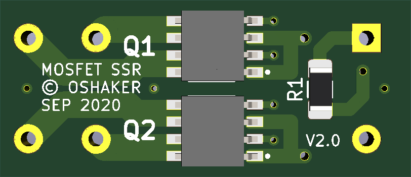

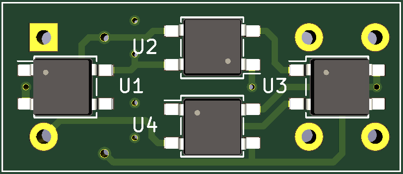

schematic modified to run VOM1271 in parallel.
10MOhm resistors removed.

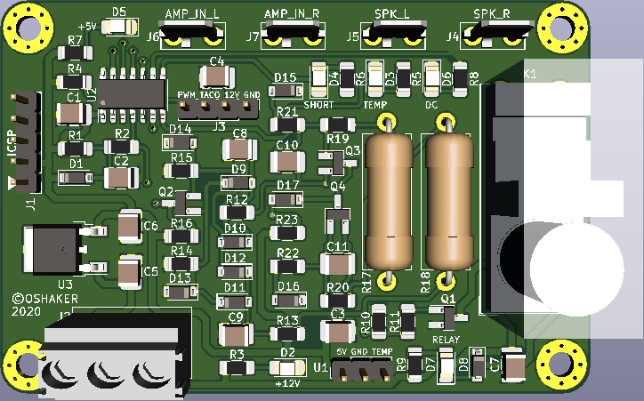

This is a 4-layer PCB, it fits in place of the Finder 40.52 relay so that I can use a normal relay or just the MOSFET SSR in my amplifier DC/SHORT protection.
Inner layer 1 is VCC, while Inner layer 2 is GND.
Nice work. With 12 volts minus the cumulative voltage drop of four VOM1271 LEDs in series the current limiting resistor of 620 Ohms will only give about 10 mA of drive current. I recommend reducing it to 220 Ohms to increase drive current to 30 mA for faster switching speed.

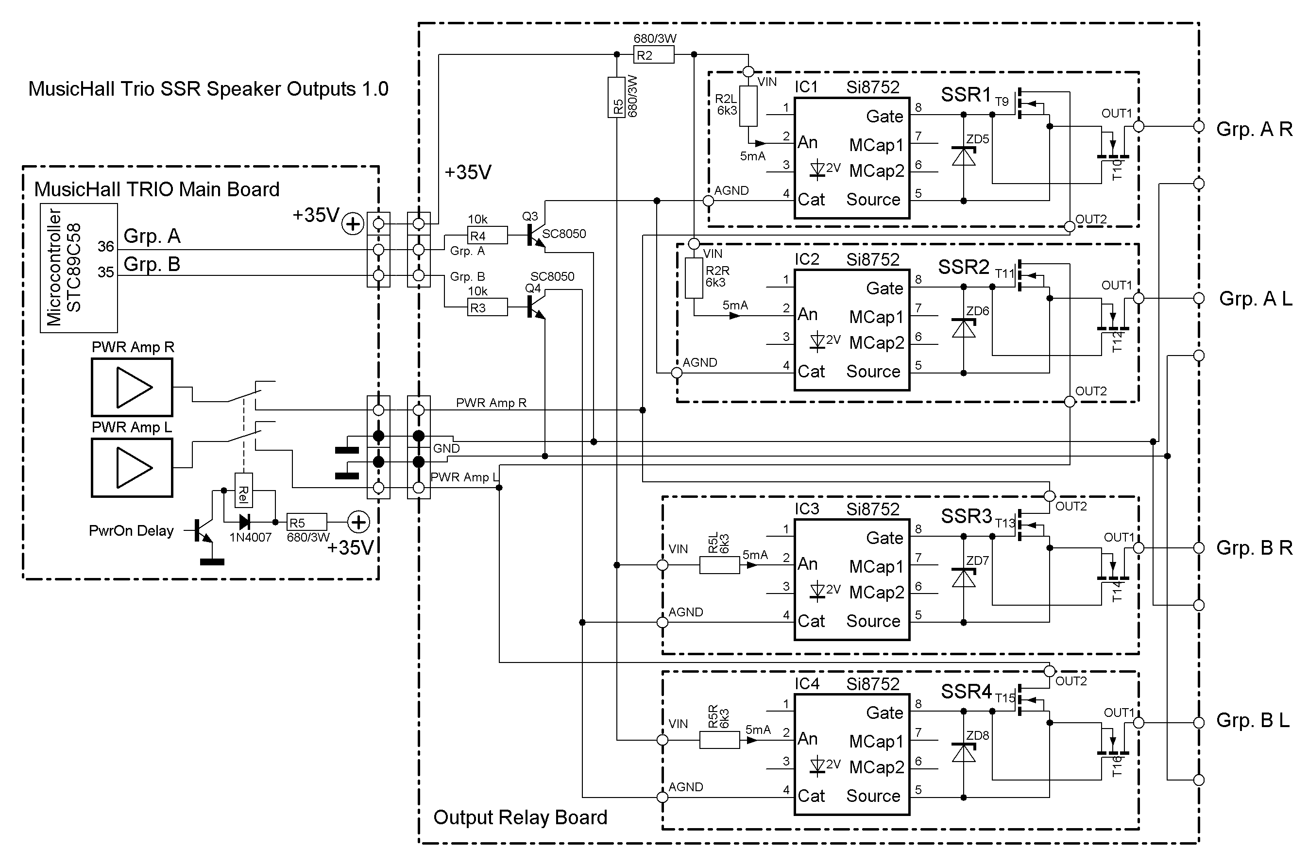

Hey Folks,
not understanding too much about SSRs, I'd like to verify the schematic I had received from a friend, which I use successfully in a Receiver as Output Relay replacement:
As I said, the circuitry works reliably, but I would be grateful to understand its potential advantages and disadvantages. Thanks a lot for the evaluation!

I'm quite confused with this circuit because there's a big schematic on the right showing SSR (four of them) and a small schematic on the left showing what appears to be an electromechanical relay for power on delay. Why would they use both SSR and electromechanical?
- Output Relays
